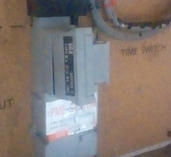

Is this dangerous? Connector blocks below sink.
So the the case with 60amp written on it is the cutout!
Yes, that's it - the thing that's not fully seating in it's holder - push it in more at the bottom.

This cutout definitely had seals intact before the works so presumably it was used to isolate, but the digimeter still has a readout in the same ballpark as before the works. The digimeter has the facility to recall it's recent setting?
The digimeter has a seal on the consumer side! That seems to be significant. Can anyone elaborate on this? Would it actually have been feasible to install a new CU that is further away than the olde fuse box by using all new continuous cables if only the supplier is allowed to connect to the meter? Is that why the spark used the connector blocks? (After telling me that the original tails would be coming out, just to get the work). Tosser!
They will need access for maintenance/testing for sure. They appear to be floating in the air at present? Red Black single insulation?
Is this the only place they could have gone? Is it close to where the DNO cut out is? How far? Where's the Meter with regards to this?
Black and Red are original fuse box tails (early eighties). Although they were supposed to be coming out I think the spark had spotted the seal on the meter and knew all along that he'd be leaving the old tails in place once the householder had vacated the premises...

It also looks to me like the cutout fuse isn't correctly seated, which would worry me slightly.

Identify him ( not here ) by name and contact details to Trading Standards, he is a danger to anyone who employs him.
I would hazard a guess he pulled the main fuse to isolate the supply when he extended the meter tails with that bodged connection. The DNO might be interested in knowing who pulled a main fuse and then did not push it fully home so give them his contact details as well.
The DNO will need to be involved when a real electrician installs new and safe meter tails
Hang on - to what were the new tails from the new meter connected when the new meter was installed?
