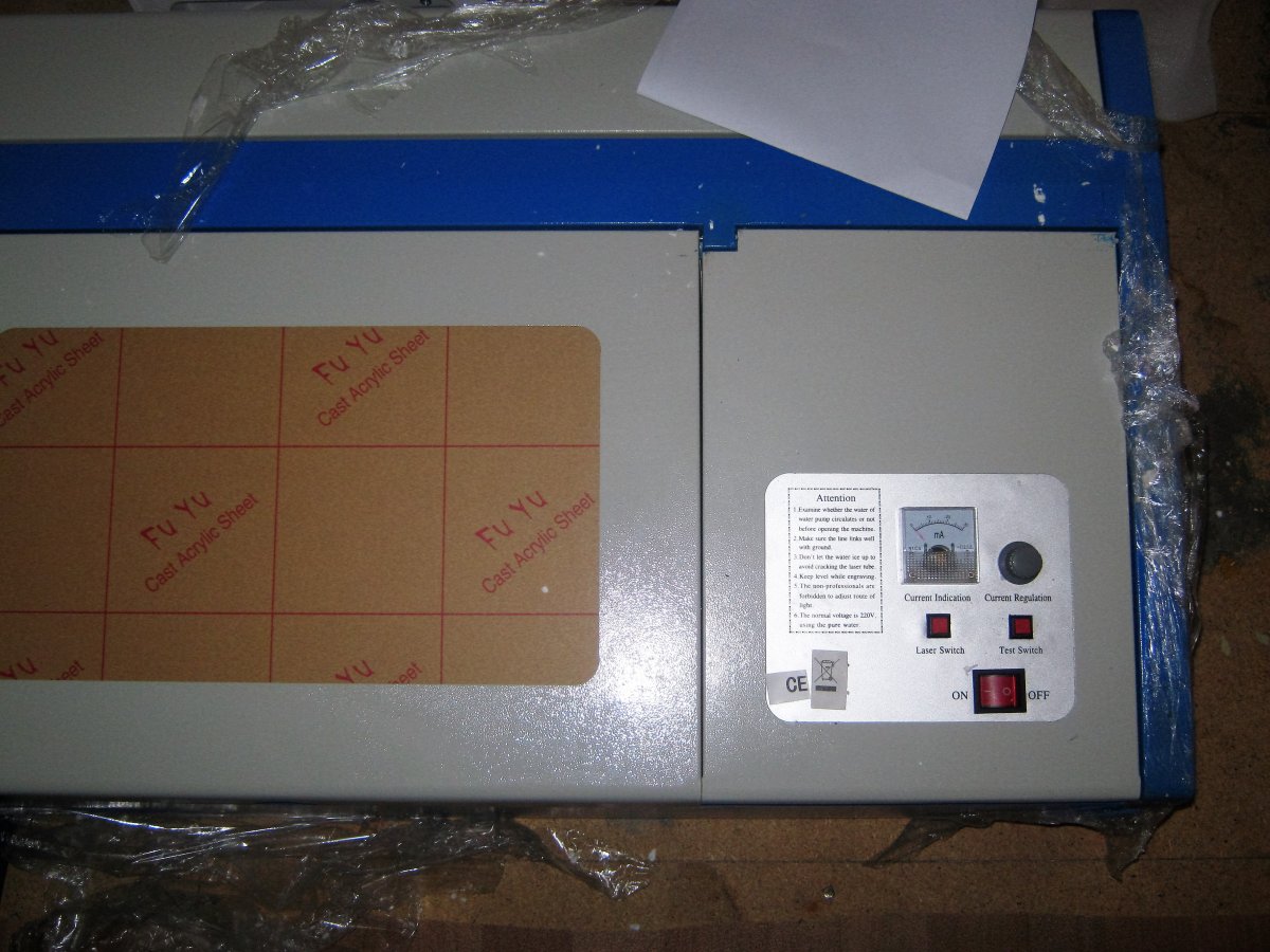

Is this power lead and adaptor suitable for uk use - from china
Also compliance with the regulations for laser equipment. Search the HSE website.
Does the documentation / manual specify the class of laser used ?
Things that must be dealt with.
(1) shielding and / or interlocks to prevent any laser light leaving the machine. ( but still wear suitable googles )
(2) safe removal of fumes created by the material being cut. ( these can be toxic / inflamable / corrosive )
Hi , its 40w laser and has a lid with a little srew. I'll defo be wearing suitable safety glasses.
There is a extractor fan included but it has same plug as the machine so im just going to get a different extractor or use one of my dust extractors to push the fumes outside.
The machine was bought from a uk seller
Are you sure he was in the UK?
Is the thing CE marked?

CE marked on the front of machine but i suppose they can just stick that on.
Ebay seller location portsmouth

The laser is cooled by clean water that runs through the tube i think. There is small water pump with the machine

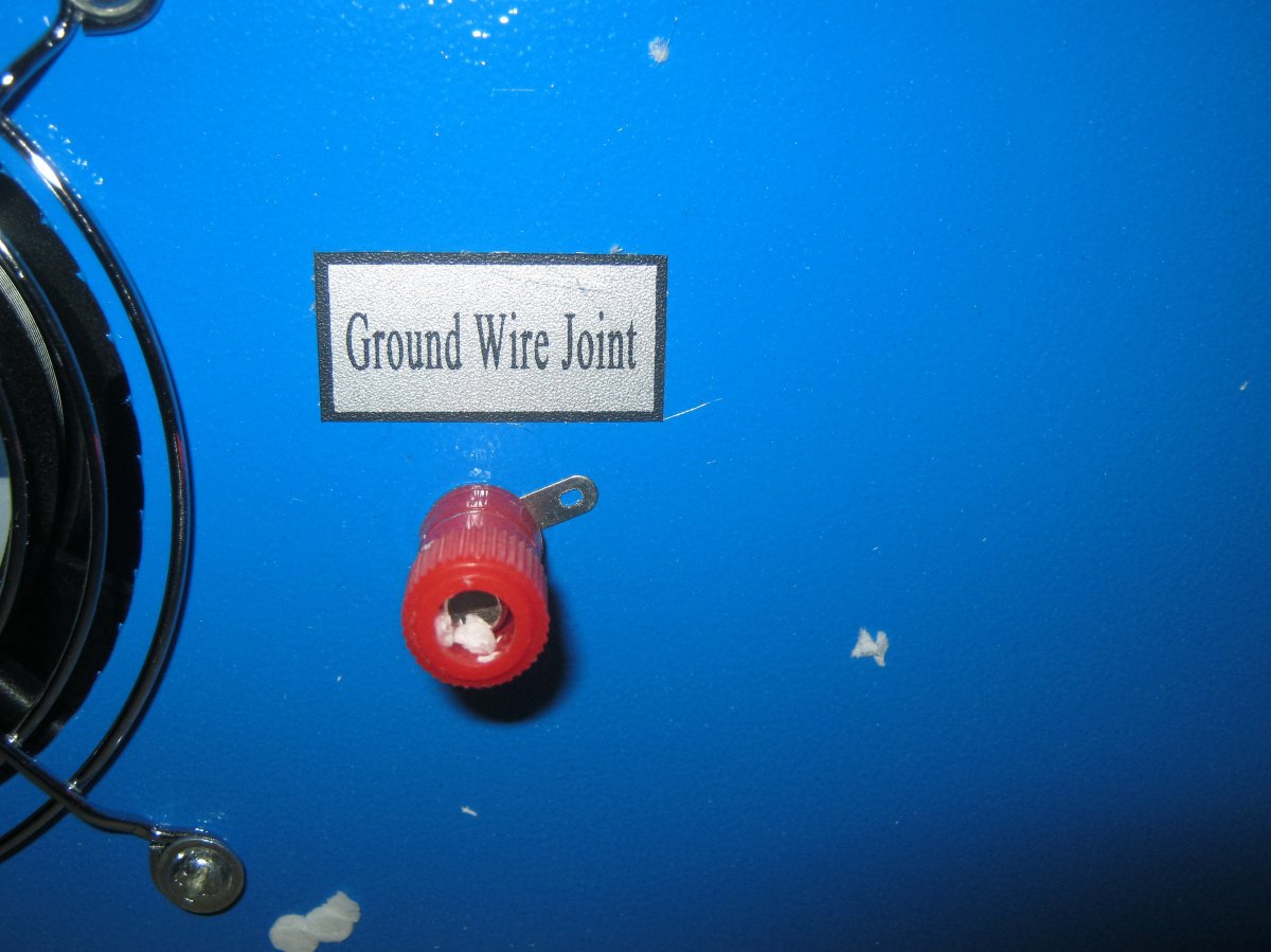

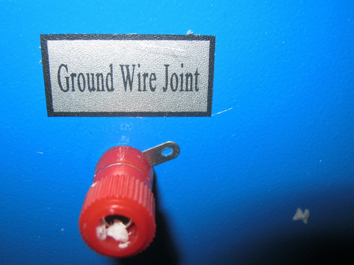

Ground connection on the back of machine but i thought that was for the US style system with 110v.
I thought if the plug was earthed then this ground connection doesnt need to be used?

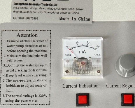

The Attention item 1 suggests one has to check the water is flowing before opening ( operating ? ) the machine. This could mean there is no flow sensor to remove power to the laser emitter should the water flow cease. It is the water flow that cools the laser emitter and without water flow the emitter will quickly overheat and if not destroyed will be seriously degraded.
I see what you mean there, i think it must mean operating.There seems to be lots of youtube vids on this machine so ill double check the instructions with other users hopefully. Not sure about it having a flo sensor but i dont like the sound of things overheating, ill look into this.

A year ago id probably would of just plug this thing in without thinking but I try to be a little more carefull with electrical items these days
Don't plugs have to have a BS (EN?) number and be tested too?
Only a BS number (BS1363) as they are built to a British Standard, not an EN standard. That is a good thing to look out for on a plugtop when portable appliance testing, if it is a regular BS1363 plug with an EN number or a CE marking it is likely counterfeit.
The adaptor in the original post is a dangerous one as they don't contain a fuse and as others pointed out, it doesn't earth a schuko plug.
