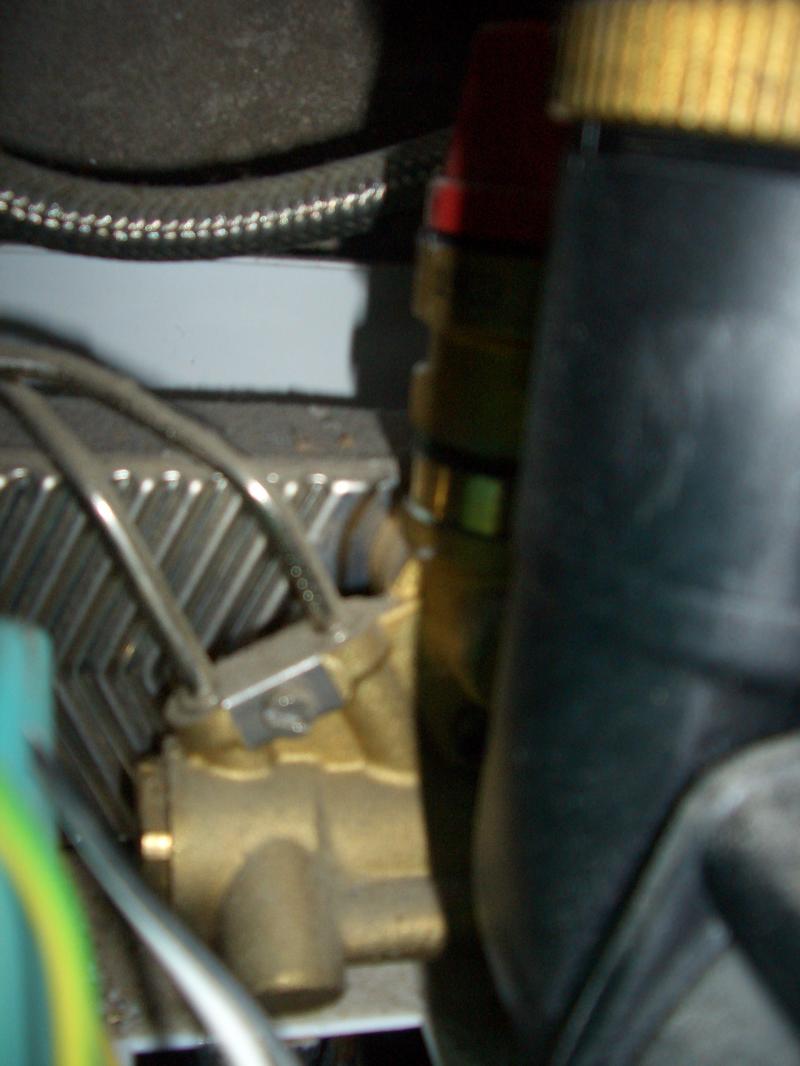

Where i think the diverter valve is, the mains cold feed goes into it at the bottom of the boiler, it has what looks like a large brass cap on the left, to the right is where the overflow pipe comes out, on top in the middle is a plastic cap (almost like an old shampoo bottle lid), which has pressure written on the top, coming out of the back in the middle is another pipe which looks to go into the secondary heat exchange.

I've created an album called Jaguar Boiler, which has images in of what i think the diverter is. it also has photo's of the boiler and display panel if that helps anyone decide if this is a rebadged model.
Will try to get pics on this message too...but if it doesn't work. please have a look at the album on my profile.
thanks.[/img]
[/url][/img]
[/url][/img]
The diverter is on the left hand side as you look at the boier.
To remove the diaphragm, turn off cold water to boiler and open lowest tap in house. There are two differential tubes going into the top of the valve where the diaphragm is. Remove both clips holding these tubes in and remove, they are sealed with orings. There is a grub screw or two holding the valve in place. Unwind these a bit and the brass valve will come out. Now undo the 6 screws, note which way the diaphragm is sat and replace with new. Put back together in reverse, replace the two orings if you can

i've included more photo's of the thing i think i should be dismantling now.

Sorted it this morning, done exactly to petit_pablos instructions.
Thanks very much for that.
Part was £11 incl. VAT. 5 minutes to open diverter up, 10 minutes to put it back together. no problem with the clips or the o rings. The tubes into the top however are a little loose even with the clips......so i took the clips off gave them a squeeze to tighten them a bit with some pliers, seems to all work fine.
