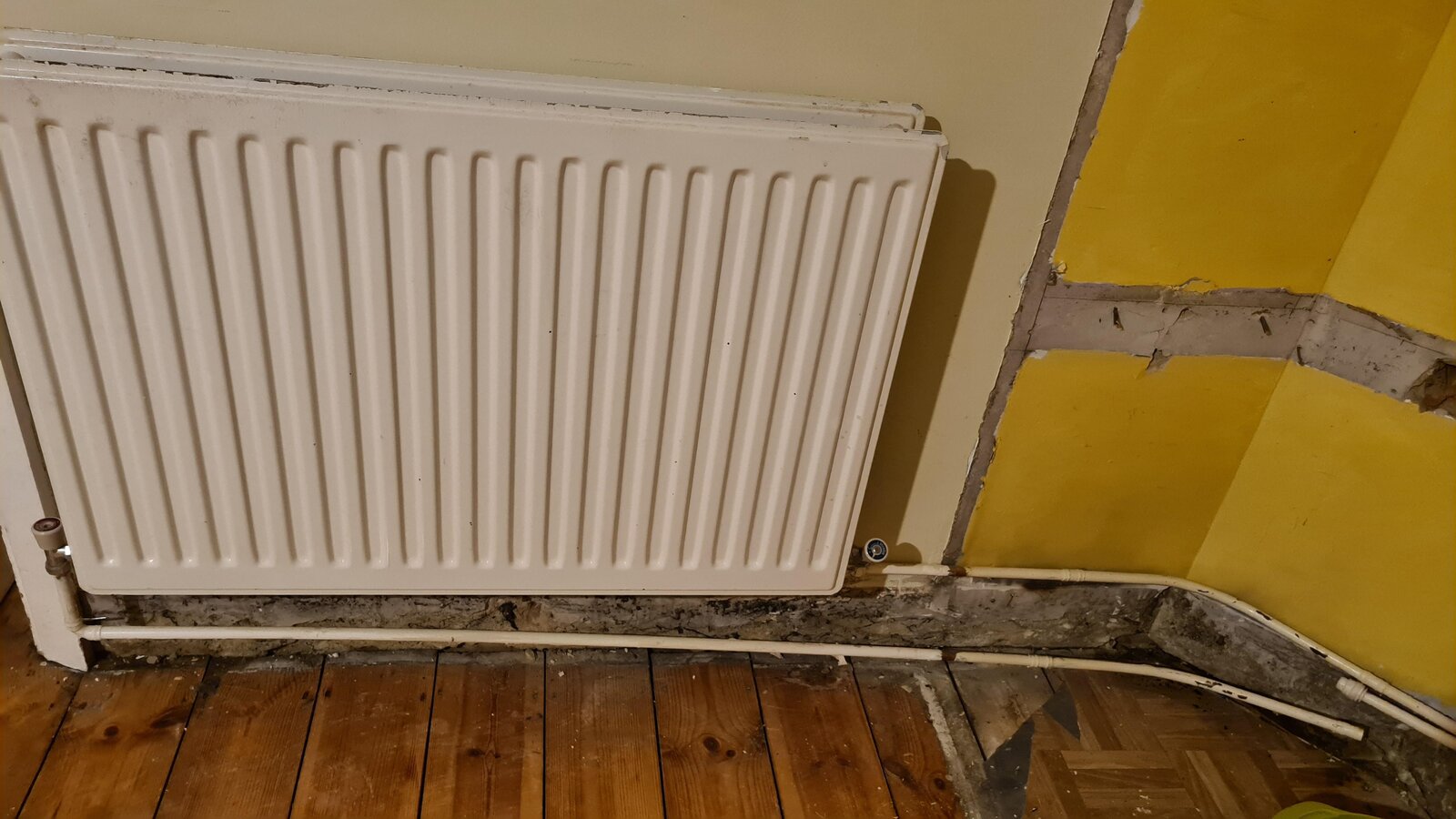

Just broke old copper pipe to radiator
Sorry ,don't follow you ?? Can you take a pic, from a distance ,to show rad and the pipes relative to it.

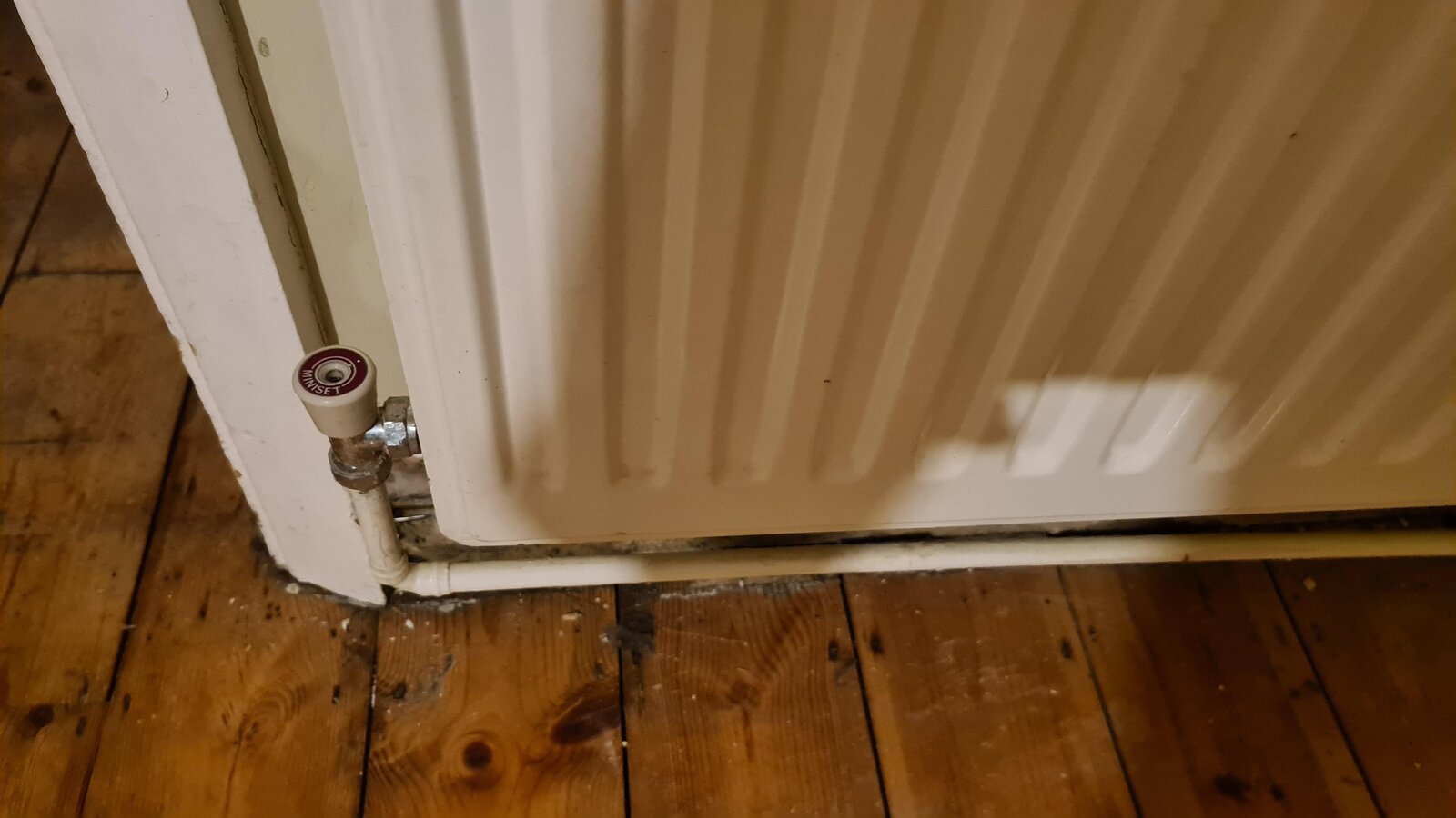

Do these help? p.s the walls are getting plastered, they don't always look like that. :)

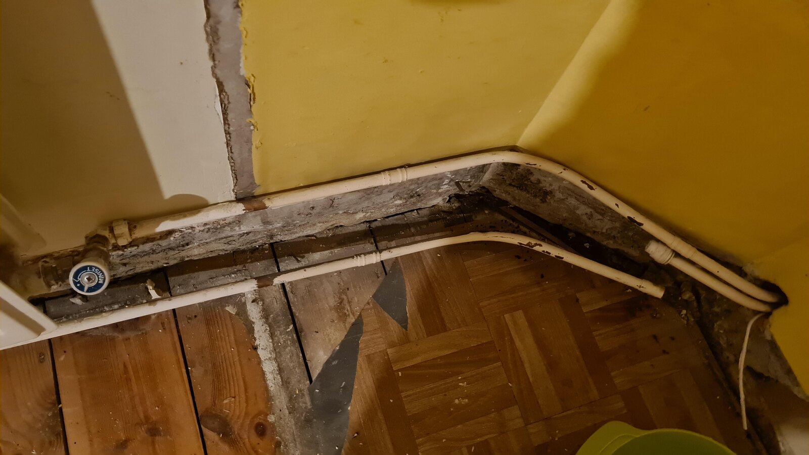

Yes, it goes directly to the radiator. That pipe goes to a left side valve with a red valve head on it that won't turn and the capped pipe was going to right side valve with a blue valve cap that does turn to on and off.
The capped pipe was going to the left side ,and the pipe that is fully intact goes into the right hand side . As long as the valve on the right hand side of the rad is fully closed ,then no water will come out the open ended pipe.
Thanks, yes I closed it straight away and the water has now stopped. It was dripping from the other part until I stuck the cap on.

Cool. While you're doing all this work, might be worth thinking about getting the pipework redone (or at least have a very good look at it all to make sure there aren't any more shonky bits. A properly soldered joint wouldn't just fall out like that, it might not be the only one.

Glad it's sorted for now. If you can do without putting the pipes under the floorboards then I wouldn't. If you get a leak when they are under the boards it becomes an even bigger nightmare to get sorted even more so if the room is then carpeted. Not many, if any, plumbers will lift floorboards to sort a problem. I know from bitter experience. Much better, although I will concede not as tidy, to have the pipes clipped to the skirting board or wall where they can be got at.
