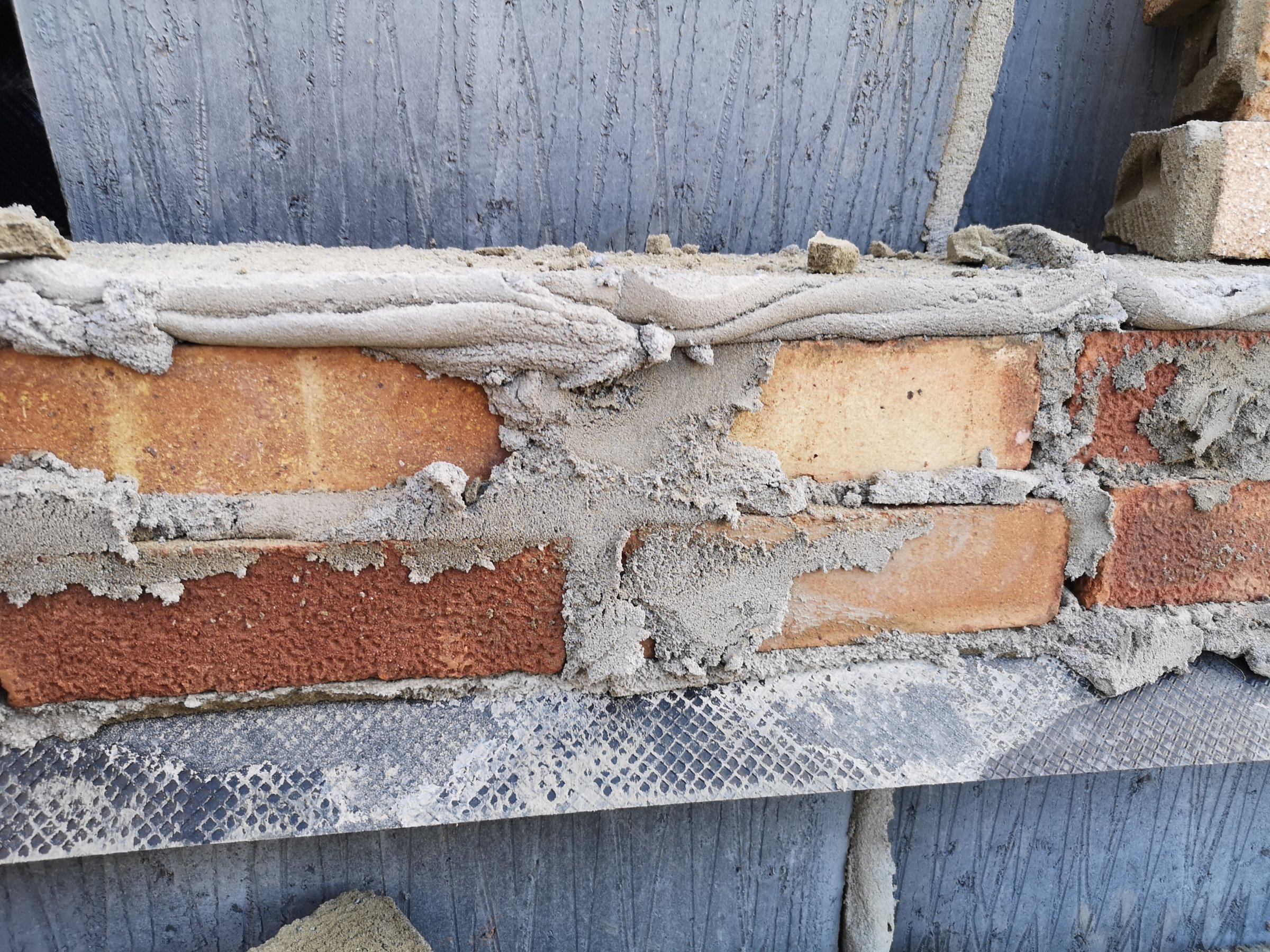

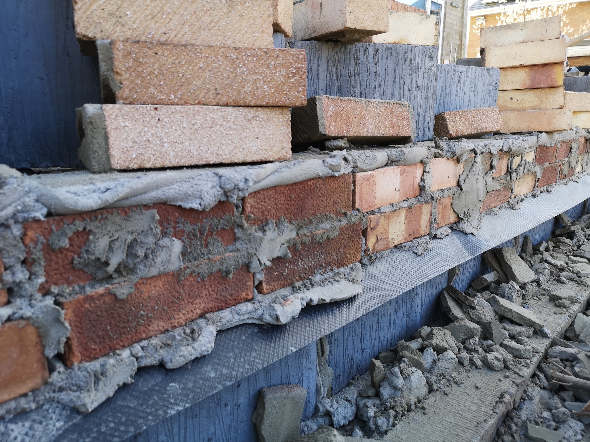

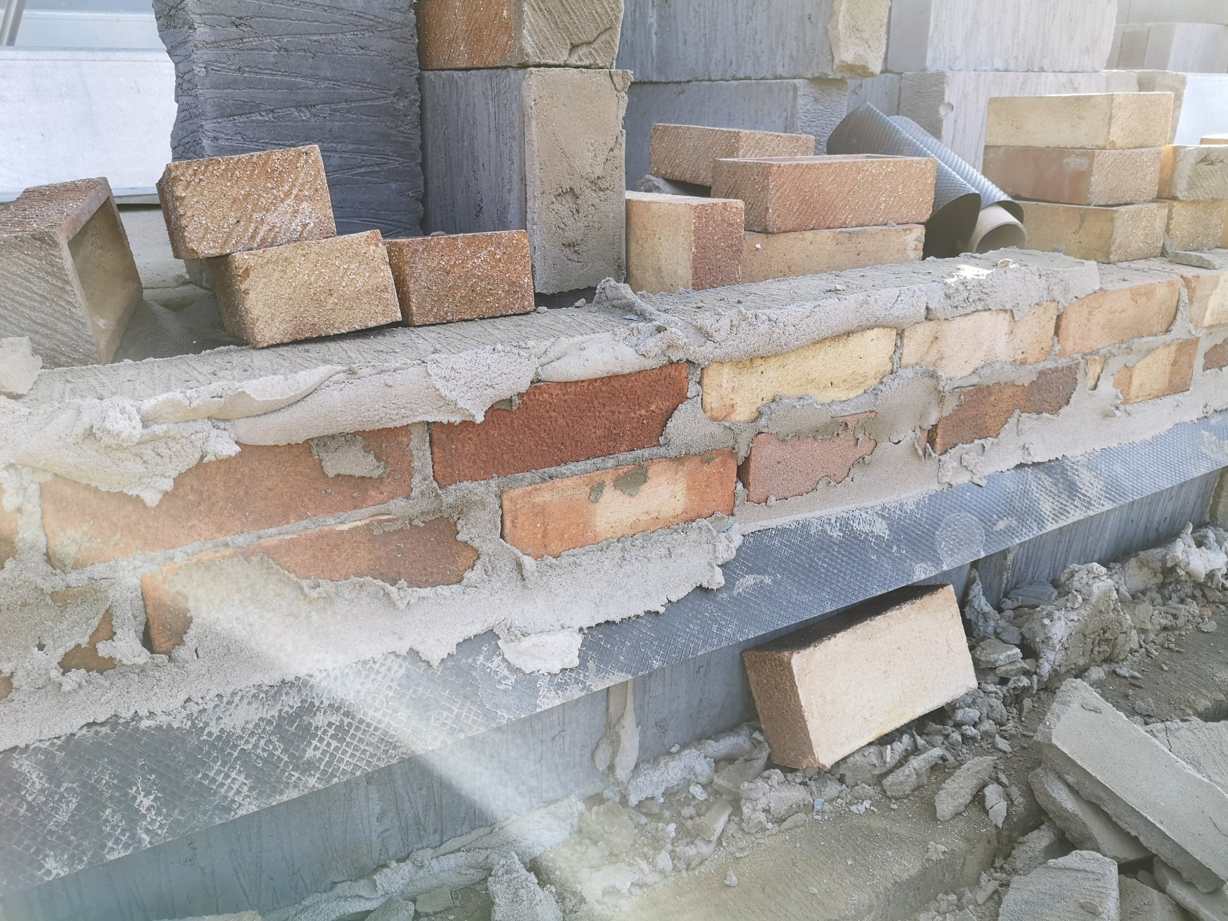

Told him to leave site after explaining issues. He didn't really argue. He wanted £600 for work. I said I need to get somone in to assess. I spoke to a builder mate and one other Bricky on phone and had onr bricky visit. All said rip it down which is what I have now done. I am not planning on paying him. Look at this mess I uncovered when I knocked down.
He hasnt bonded the bricks courses at all. almost no overlap.

Nope guy from the UK. This bit was hidden on the inner leaf below floor level so didn't see it till I knocked down but still totally not on.
