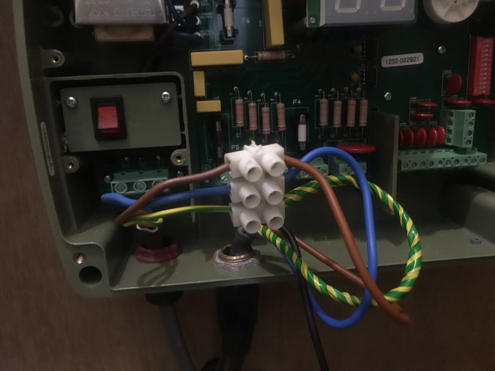

I have just checked the fuses within the Green Control Panel and one had failed. I've replaced this but it tripped out the consumer unit but did not blow a fuse.
Is there anything further I could do to trouble shoot before calling in the pros?

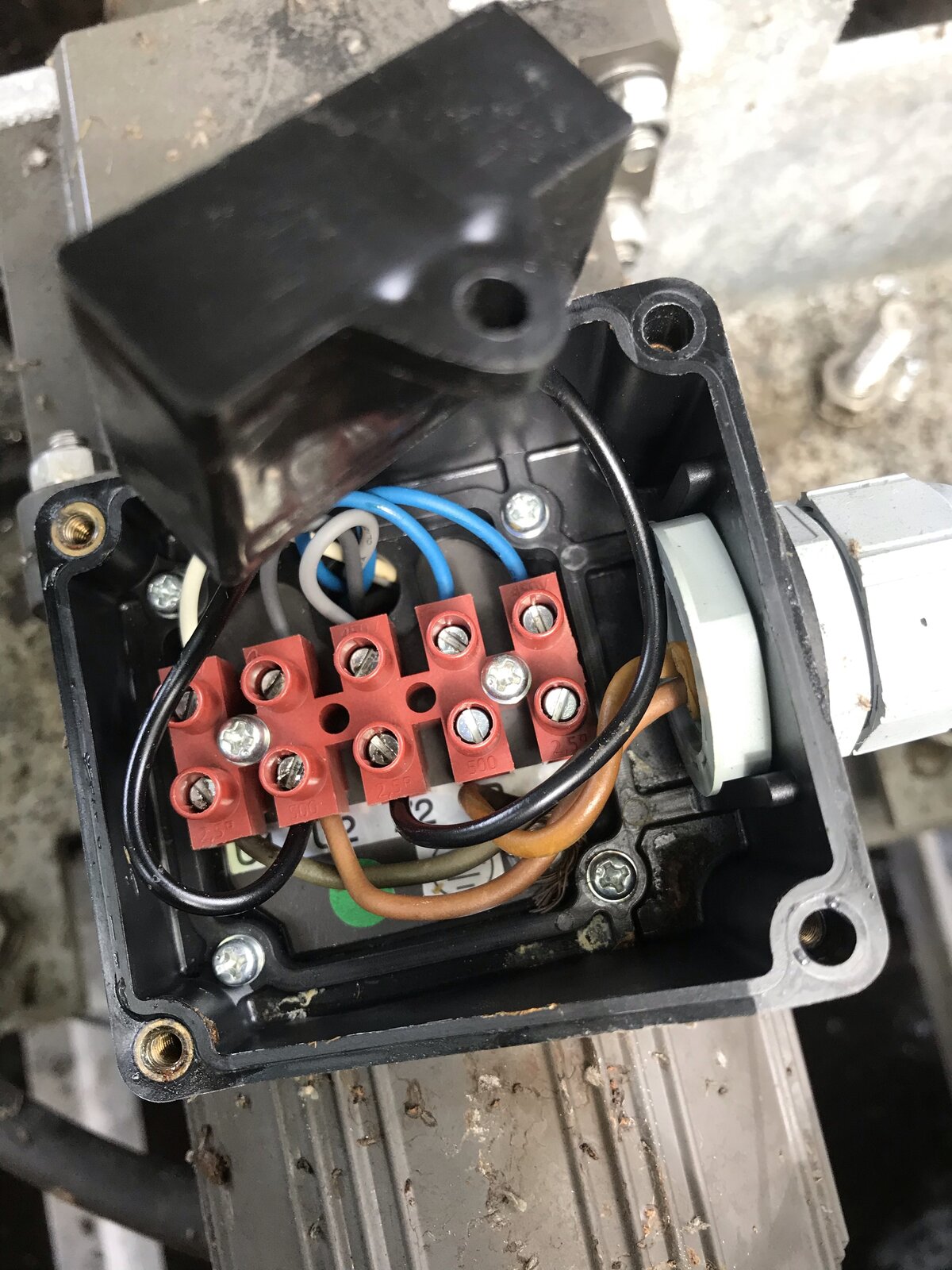

I'm considering the following. Powering the motor directly via an extension. Just need to know whats live and neutral U1 / U2 on the below photo.
Or alternatively now that the unit isn't tripping I trust I could test directly via a meter. I would then know if power is being received / if the motor is a fault.
Whats your thoughts chaps?
Many thanks!!
It's A/C so it doesn't matter if l & N are reversed..
To check it measure volts on
L / N.......240
L / E.........240
N / E........0 or very low

Look at the other end of the cable; it should connect to something with more conventional colours than what you have in the photo.
RCD tripping could simply be due to dampness somewhere. You could try disconnecting everything at the building end and measuring resistance between everything and earth.
Thanks Terry, I'll need to figure out if I can measure resistance on my meter..
Something that I have just tested is: bypassing the green control panel to see if that was at fault but the RCD still trips when powered :(
Okay I've just done another test.. and tried powering the motor directly in situ.
Firstly with the 2uf cap - motor did not turn. (I heard a slight electrical sound) > I then swapped the cap to a new 3uf cap and tested again. Still nothing and no sound.
Trust this would indicate that the motor has failed again?
