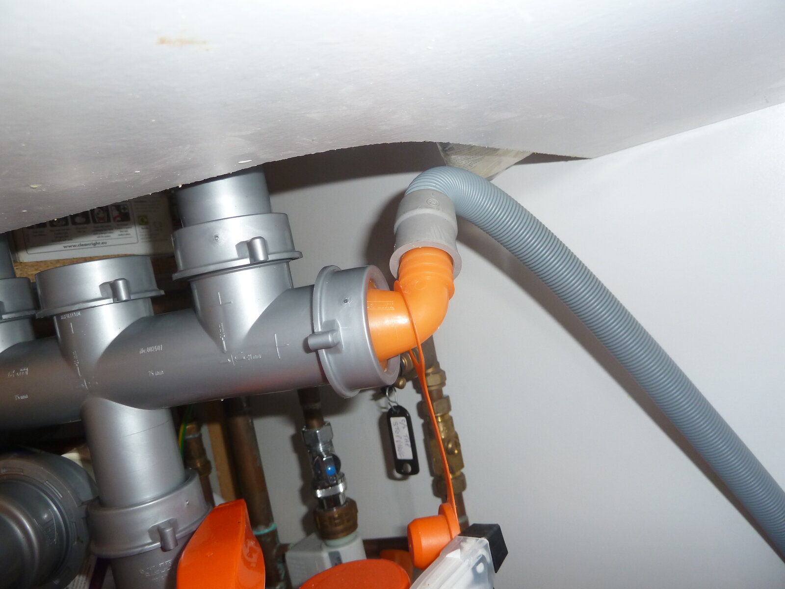

there's nothing there below the orange thing it just goes into the baseboard of the cupboard towards the ground

Stand back and take a wider pic please
If you empty some of the stuff out if the way we will be able to follow the path of the pipes
Is the T- piece perfectly horizontal?

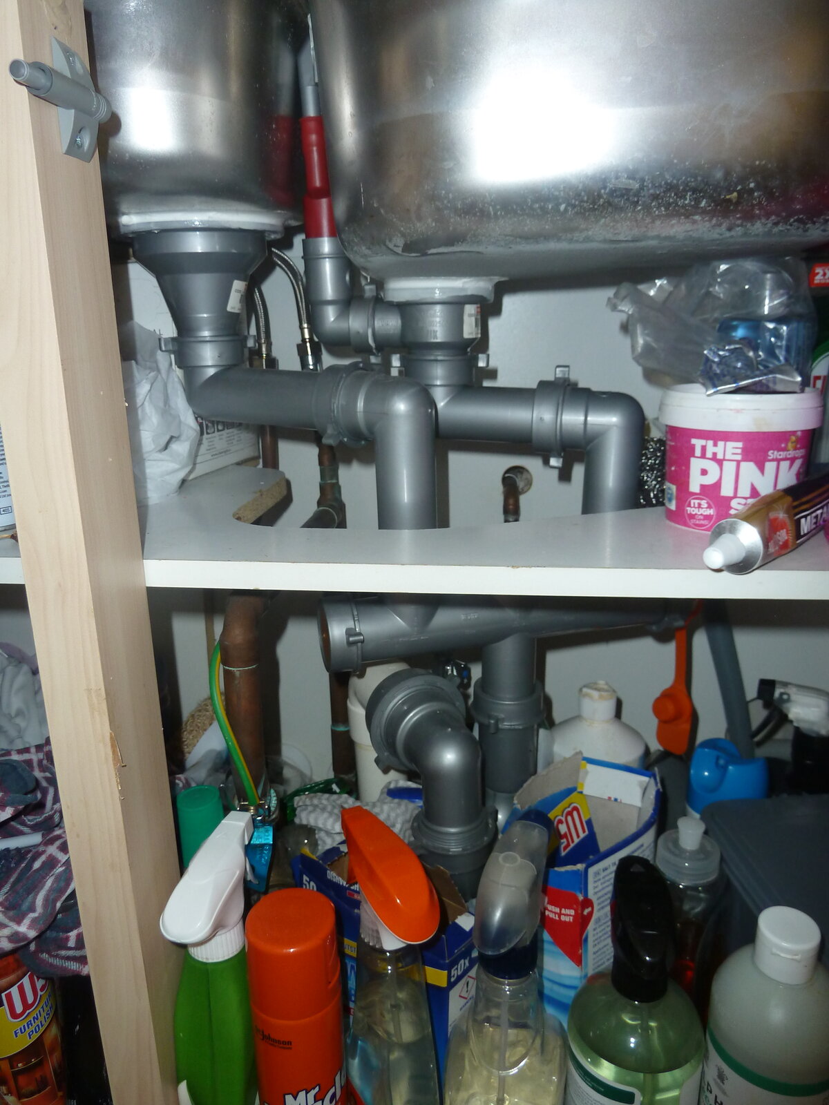

yes it is and underneath it attached is a down pipe and u bend upwards about 8 inches then a down pipe into the floor of the cupboard
I think there might be detritus lying in the horizontal pipes, especially the dead end in the T piece.

I can see something grey going down near the right hand end of the T piece, what is it? What is the red plastic thing? The shelf and stuff are in the way.

I can see something grey going down near the right hand end of the T piece, what is it? What is the red plastic thing? The shelf and stuff are in the way. I have done all that you say above many times. It doesnt help.
Looks like IKEA waste , they often leak , I would replace the existing waste with new .There is too much pipe work before the U bend allowing waste to collect and smell.
It does look strangely complex. If the replacement has a trap directly beneath the sink, there would be practically nowhere for waste to collect.

Ikea supply a selection of waste pipes for their sinks , whoever fitted it thought they had to use all the fittings supplied, the T section should fit directly below both sink wastes and then go directly into Trap.
thanks to all respondents - husband is dismantling that T now..will let you know what we find eughhhh
Is there a dishwasher waste hose connected to the trap?
(Sigh)
May be the cause.
Remove the obstructions and take photos showing its route.
