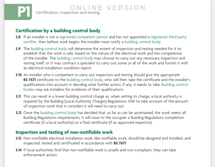

Maybe - but nothing in BS7671, the Building Regs or anything else gives an LABC/BCO the authority to 'reject' or 'refuse to accept' a Building Notice from a non-electrician. As far as I am aware, if they receive it, they have to accept it, and then make whatever arrangements for I&T that they feel are necessary.

The current Online Approved Document appears to be from 2013. And does refer to BS7671. Helpfully BS7671 is noted as the standard referred to but (joy) its 17th edition from 2011
so we wouldnt need to have to bother with the 18th.
This page would seem to encompass all we have been talking about. OP raises building notice and pays the fee. There's a bit in there that says that if the job is easy then LABC might reduce the building notice fee. Yeah, that's going to happen....

The current Online Approved Document appears to be from 2013. And does refer to BS7671. Helpfully BS7671 is noted as the standard referred to but (joy) its 17th edition from 2011 so we wouldnt need to have to bother with the 18th.
Yes, it does mention BS7671 (2008!) but, as I said, it's contents are almost entirely 'procedural', not directly related to anything elecytrical. In contrast, the original (2006) version had (in Appendices) a fair bit of 'electrical' stuff.
Quite so - as I've been saying all along. The lesson, I think, is that one should not 'talk to the LABC' but, rtaher, just submit a Building Notice to them.
