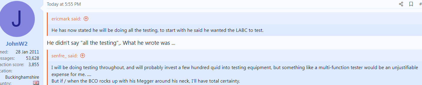

He has now stated he will be doing all the testing, to start with he said he wanted the LABC to test.
He didn't say "all the testing",. What he wrote was ...
I will be doing testing throughout, and will probably invest a few hundred quid into testing equipment, but something like a multi-function tester would be an unjustifiable expense for me. ....
But if / when the BCO rocks up with his Megger around his neck, I'll have total certainty.
So, he is seemingly going to do some, but not all, testing and he still has the expectation that the LABC will probably also test (they;re very very unlikely to accept his test results, even for those things he is able to test) - per his "... when the BCO rocks up with his Megger .... And seeing as they have to do it anyway, why not lean on it.. "

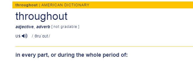

https://dictionary.cambridge.org/dictionary/english/throughout :)

As your dictionary (and I imagine most others) says, "throughout" relates to places or times ('throughout the UK', 'throughout last year') bit it implies nothing about 'what?' or (more in context) 'how much?' - and certainly doesn't necessary imply 'all'. I suspect that he meant "throughout the period when I'm doing the work' After all, as I said, we know that he is not currently equipped to do all of the required testing (although he told us that before I suggested he might be able to afford a secondhand MFT).
If I told you that I had "spent the weekend doing cleaning throughout the house" would you really take that to mean that I had done every possible bit of cleaning in every part of the house? Closer to home, if I told you that I had "inspected and tested sockets throughout my house", would you take that to necessary mean that I had inspected and tested every individual socket in every part of the house?
If either of those were your interpretation, then they would not correspond with my intended meaning - if I had meant "everything, everywhere', I would have said so more explicitly.
Senfre said "I will be doing testing throughout".
It was not you who said it.

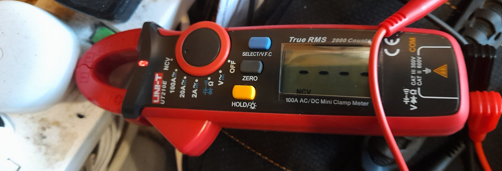

OK why test? Well we need to ensure that the protective devices will disconnect the supply within the prescribed time in the event of a fault.
So a MCB is two devices in one package, there is a thermal overload which will disconnect the supply if the current goes over the set limit in the fullness of time, but it is too slow to comply with the regulations, so we have the magnetic part which will disconnect in a fraction of a second, but it needs for a type B 3 to 5 times the rated current to flow.
So for example a B32 MCB will need 160 amp to flow to ensure it trips, well today we add another 5% as a safety margin, but lets keep it simple, so for 160 amp to flow using ohms law 230/160 = 1.44 Ω approx. So we need to measure less than 1.44 Ω, to get an accurate reading the regulations say the equipment should allow 200 mA to flow, however with many loop impedance testers only 9 mA flows so it will not trip the RCD, so that bit does not ring true. I do have a low ohm meter, but the standard multi-meter will measure down to 0.1 Ω so it may not comply, but should be good enough to show if likely to be within the limits.
We clearly don't want nuisance tripping, so we want the leakage to earth to be less than 9 mA, again my multi meter Testing for live.jpg will measure that, it will not measure insulation resistance, I need another meter to do that VC60B.jpgbut if the leakage is low then should be OK, again ohm's law, 230/1000000 = 0.23 mA which I can't measure, lowest is 1 mA, but that is measured with DC, with AC it will never get that low, due to inductive and capacitive linking, so in real terms if less than 3.5 mA per circuit you should be OK.
The RCD has a test button, so we know it works, but as to 30 mA in 40 mS only way is a RCD tester, but one would need to be very unlucky for it not to work.
So with the simple multi meter Testing for live.jpg you should have a good idea if it will pass or not, but as to completing the schedule of results, no it's not good enough. However one can hire as I have said before, so the multi meter while work in progress, and hire a test set once complete. So £35 for multi meter and £50 at the end to hire the test set.
The LABC inspector will likely select some easy to access tests, if his result matches yours, then likely he will be satisfied without testing all, he has confirmed you have done testing. As to calibration certificate if his readings match yours then it must be near enough.
As to volt drop, well it does not really cause a danger, so unlikely to be tested.
However we are looking at around the £300 minimum to get the completion certificate, could cost more, but in real terms only worth it for a large job, with a full re-wire likely worth while, but for a consumer unit change likely cheaper to use a scheme member, and the scheme member will test after fitting a consumer unit, so do all the other work first, the pay for the consumer unit change, just not worth the hassle to DIY it.
