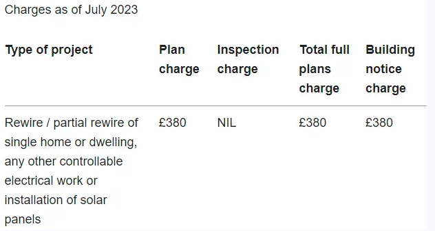

They charge him a fee. a short while after Part P came in a public servant called Ann Hemmings pointed out that the LABC were not allowed to charge inspection fees as rules stood at that time. Sadly she died in a cycling accident a while later. .... Anyway, nowadays, apparently, they are allowed to charge.
It seems to vary a lot between LA's. A good few are vague, in that they "reserve the right' ("may") charge for some testing, without any clear explanation as to when/why/how much would be a charge. However, as I illustrated, some (like mine) appear to charge nothing additional for inspection - although I imagine that there is some small print somewhere which says that they might charge if 'additional testing' is required because of 'failure' of initial testing - but that wouldn't seem unreasonable. In the case of those LAs who appear to make additional charges for any testing it begs the question as to what their (sometims high) Notification Fees actually are 'paying for'!! To remind you, this is what my LA says:
Can`t blame them really cos very few BCOs will have the knowledge and experience to do the I & T themselves.
Sure, but, as above, what exactly are their (often high) Notification Fees meant to be paying for if not for ('contracted out' if necessary) I&T?

I believe Building Control are free to subcontract the testing to an electrician of their choice and pass the cost on to the home owner, on top of the normal BC notice charge.
Unless that's changed?
