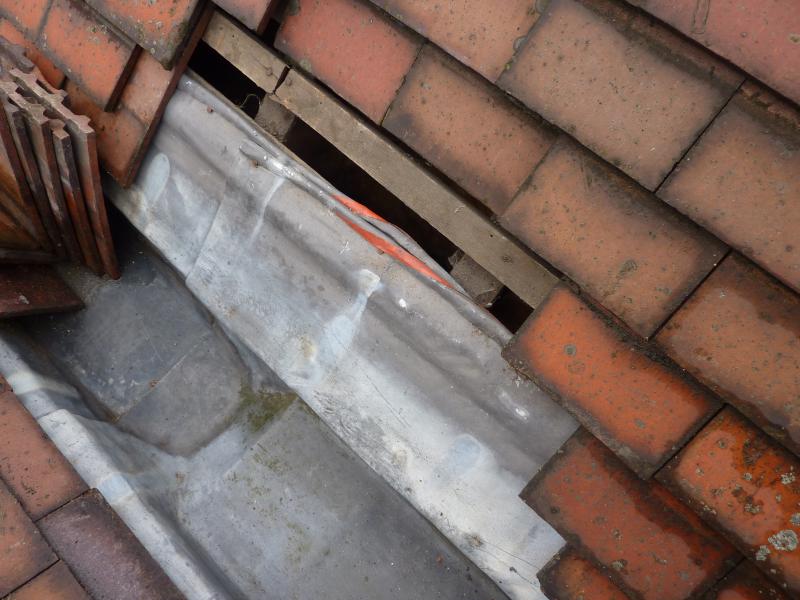

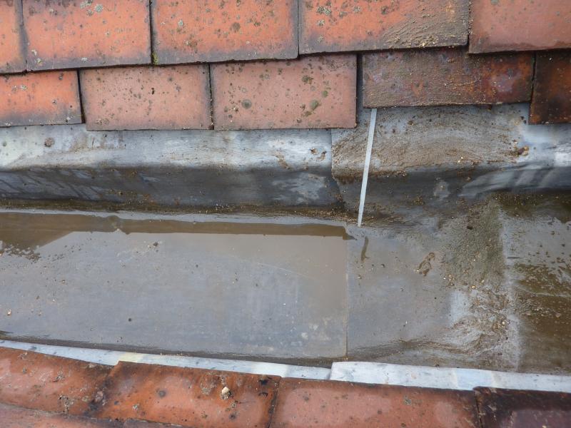

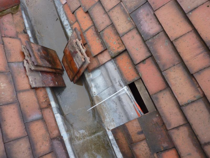

Okay, with snow predicted for today I thought I'd better get out there yesterday and lift a few slates.
Here are some piccies.
The first picture is as soon as I got out there. The plastic tie was pushed out from the attic to mark where the water is getting in.
The second picture is a close up of the area. Remember, this is only happening when very heavy snow thaws. There's no evidence of damp on the top of the ceiling, so the water is finding its way through the leadwork and onto the brickwork which supports the gulley, and then spreads underneath the ceiling above the ceiling paper. About 50ml worth with the last snow.
The next two pictures show the area with some tiles removed.
In the end I removed about 15 tiles, and put about a metre of flashing tape between the top of the lead and the lower batten. This is just a temporary bodge, but I'm curious to see if it works. If it does I'll do something a bit more permanent.
Need some heavy snow now.
There is a small flat area between the bottom of the tiles and the point where the lead is formed into the gutter. water can easily back track here.
It is a poor detail which could be dealt with by insertion of eaves and a cut course of tiles
Also I think the splash lap size is working against you. certainly it should be raked back on the sides rather than a straight cut across the gutter

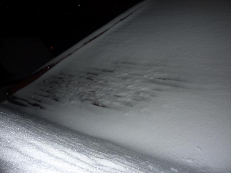

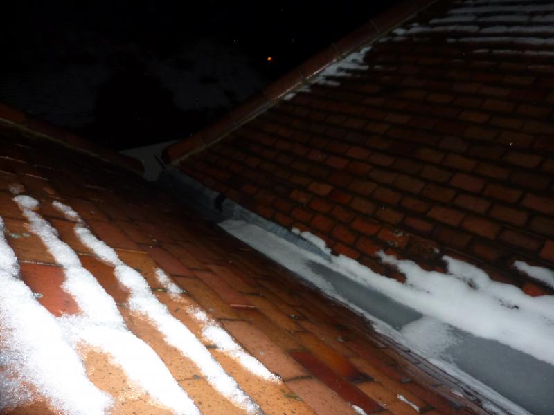

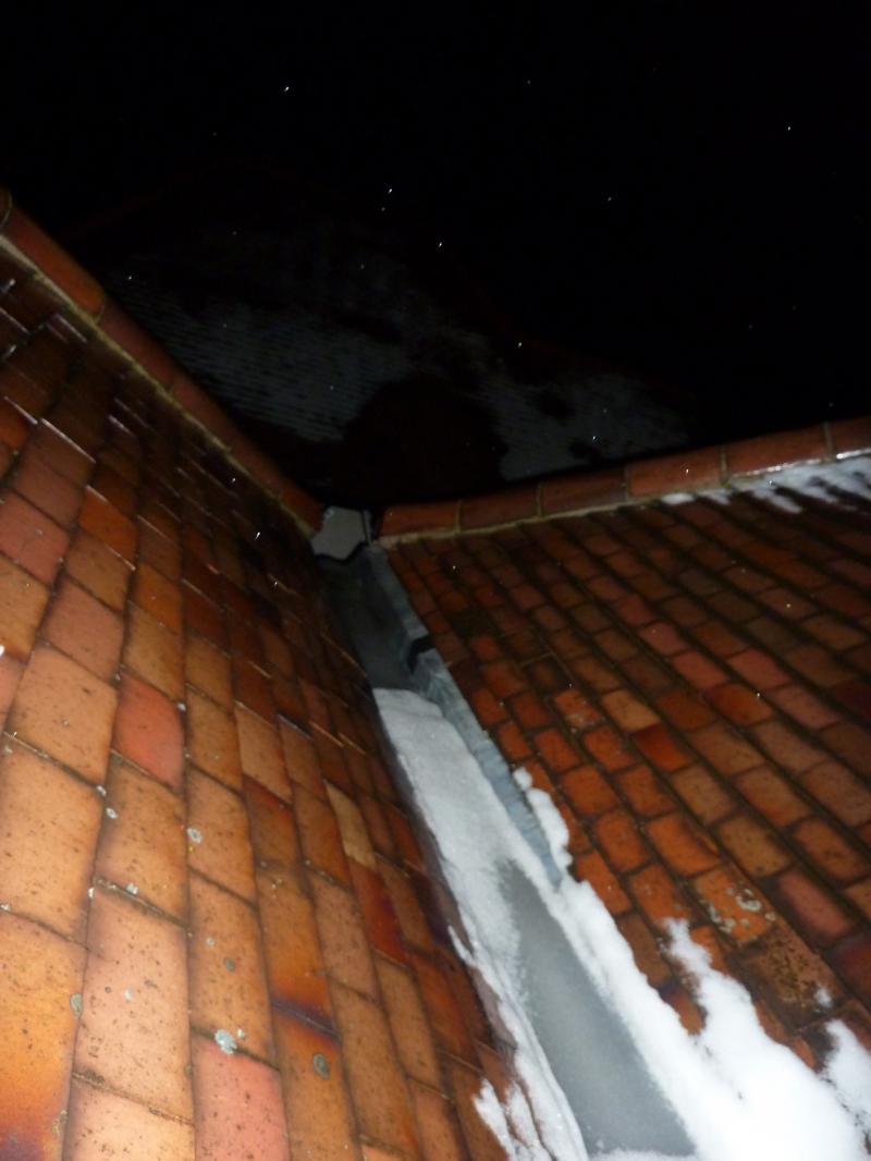

Here's a picture taken at about 8:00pm. No damp patch at this point.
Here's two more taken just 3 hours later. It's thawing quickly, and raining hard, and a damp patch has appeared on the ceiling. The top of the ceiling is damp from the attic, but there's no visible source of water ingress from above.
Poking the ice sat in the gulley and it's pretty solid. Two hours after these photos are taken the damp patch has spread to the largest size I've ever seen, and I'm collecting water in buckets.
It has to be tracking back in the bottom of the gulley. Is this even solvable? The design of the roof is such that I could imagine a devastating snow fall overcoming the gulley no matter how well it has been constructed.
