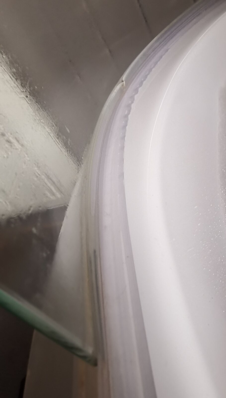

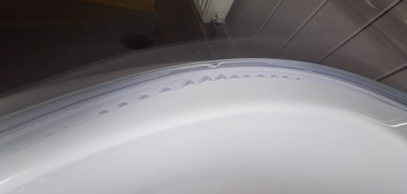

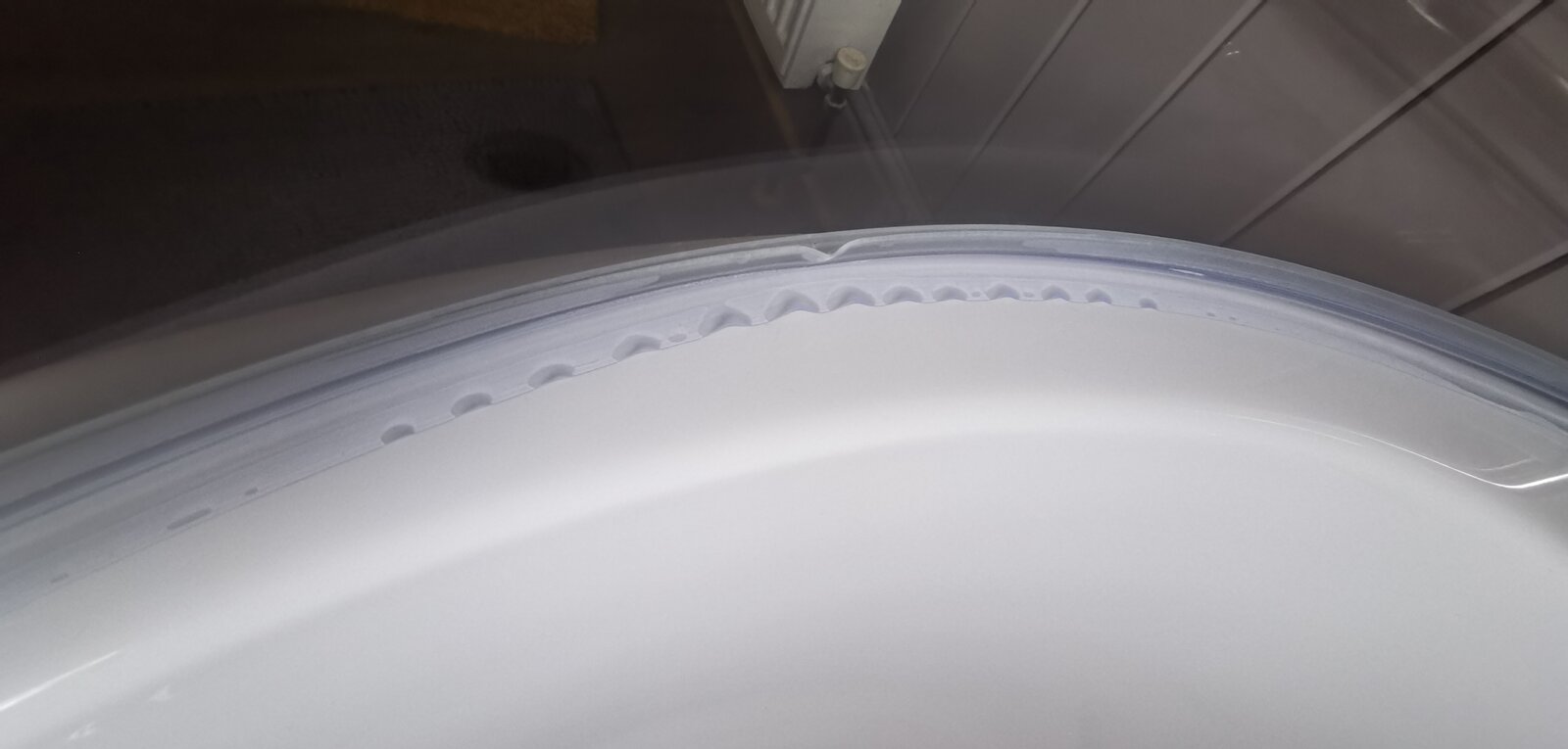

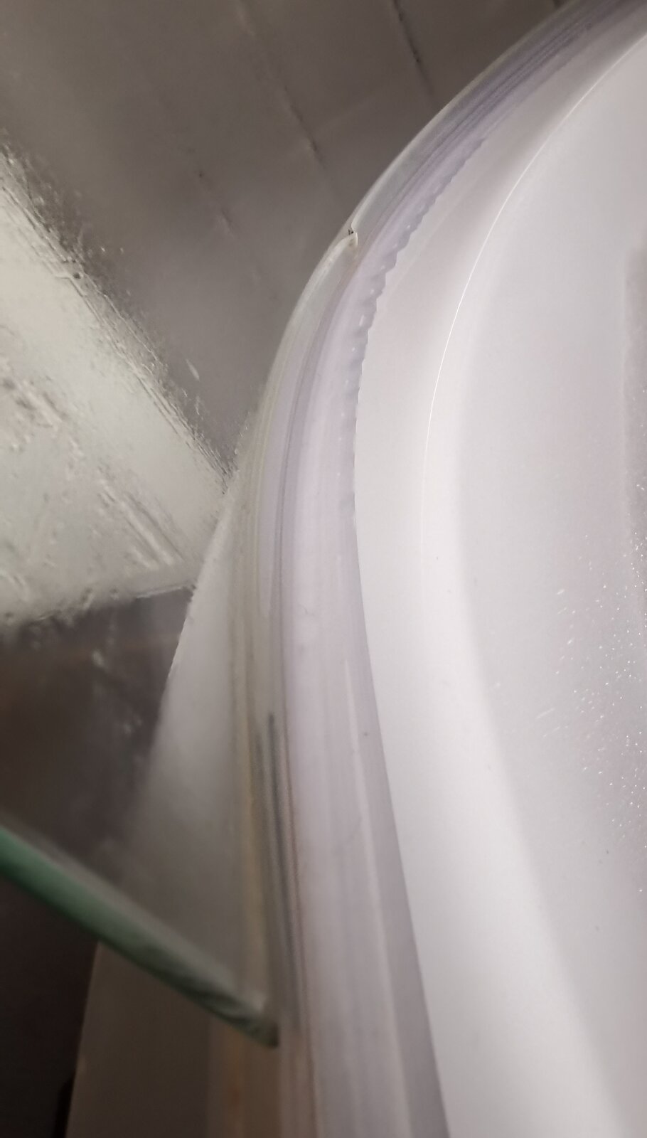

It clearly doesn't like this way round so perhaps it was on the correct way all along for this model ?

Looks like it might be the wrong seal, may need a pre-curved seal to fit that screen properly
Either that or it was curved to start with and you did have it on the right way to start with? I'd certainly be looking to get a pre-curved seal for that though if that one's causing problems.
I fitted one similar at our last house. The seal needs trimming at the hinge to fit closely around it. Can’t post a pic of ours as we moved out last December.
It was VP but a small corner bath so didn’t get the worst of the shower but it didn’t leak. Seal was replaced after 2 years as it went yellow with one from Toolstation IIRC and that didn’t leak either. Long leg of seal to the inside and silicone under the hinge, IIRC the bottom part doesn’t turn

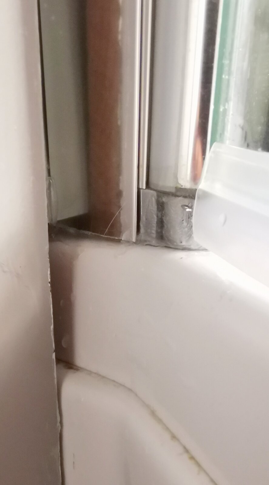

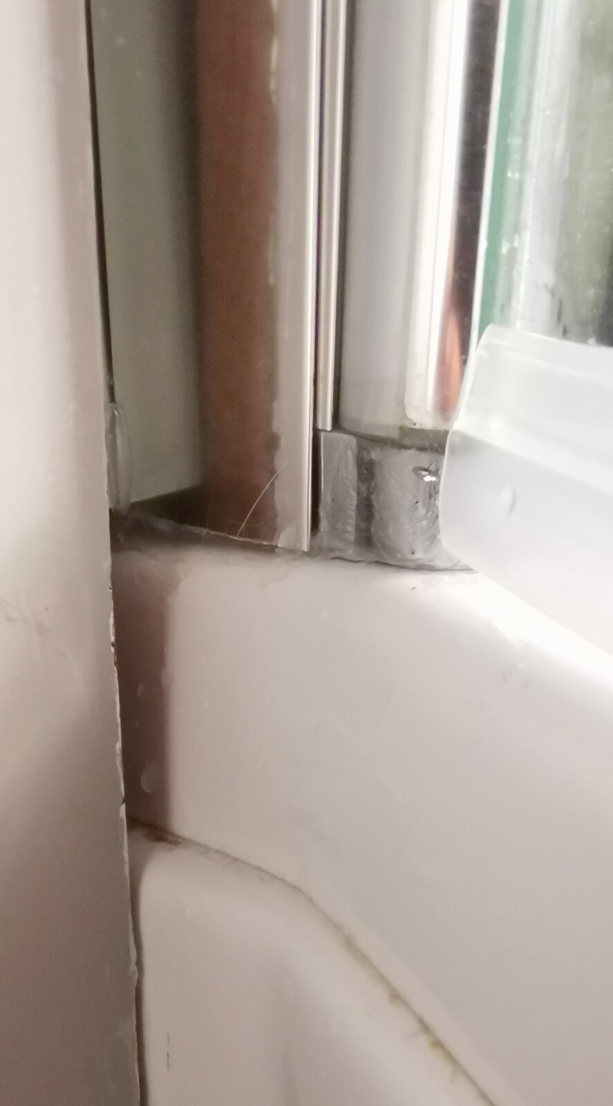

What I can't understand is its getting through under the sealant I did both sides of the bracket base that doesn't move. This is ridiculous.
