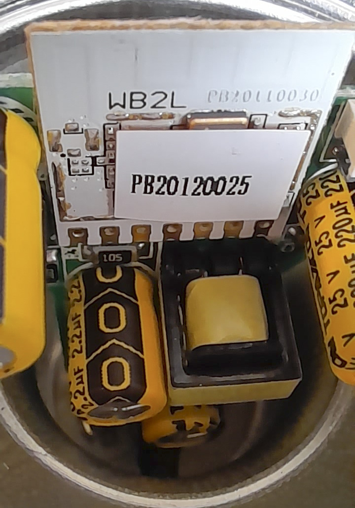

So the strip light I bought from our discount shop called Lidi, is colour changing and dimming and to do this it uses a PWM unit so a 2 meter strip is rated 22 watt it does not state lumen but it is high, uses zigbee control, but most of the coils of LED lights are for decoration not lighting, the Lidi one I have is unusual to give out so much light.

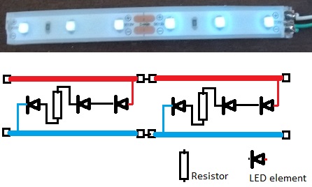

To get the best illumination use a basic LED strip such as this type. ....
The current through the individual LED elements is determined by the supply voltage and the series resistor, Therefore it requires a DC power source and NOT an LED driver,
The diagram @bernardgreen shows uses a resistor as the driver, so a white LED has a volt drop across it of approx 3 volt, so 9 volt used to light, and 3 volt used to heat, so if the LED chip gives out 100 lumen per watt, as a whole it gives out 75 lumen per watt.
The resistor changes the package from a current dependent device to a voltage dependent package. WIth an AC supply we can use a capacitor instead of a resistor, but we still need a leak resistor to sink any voltage raised with capacitive or inductive linking, and a rectifier.
So the bigger the package and higher the voltage the less loses and use a pulse width regulator and it can correct any voltage variation as well.
The resistor is NOT a driver, it is a current limiting device,
A driver forces a current through the lights. It measures the current and automatically adjusts it's output voltage to be the voltage needed to drive the rated current through the LED elements
For example a 100 mA driver supplying 10 white LED elements will set its output to be 30 volts
The same driver supplying 16 LED elements will set its output to be 48 volts
If a driver is used to supply a 12 volt LED tape where the current is controlled by a resistor then the driver will increase its output voltage to try and force the 100 mA through the LED elements and the resistor.

However it is the control of the current which changes the same LED chip from giving 100 lumens per watt to 60 lumens per watt, I have the boxes on my desk for two GU10 bulbs, one is a smart bulb with an input of 5.5 watt and output of 345 lumen and can only change the colour temperature, the other also a smart bulb an input of 5 watt and output of 500 lumen this was can also change colour red, green, blue etc. I had one of the latter bulbs fail and so could open it, a look inside 20220603_113820_1.jpg and clearly a lot of control stuff there.
My Smart LED light strip from Lidi does have a high output, I have one under the kitchen cupboards to light the counter top, and I have to turn it down to minimum output, it is rated at 22 watt for a 2 meter strip, no lumen output is given. But it is high. However with no lumen output it is clearly for decoration.
