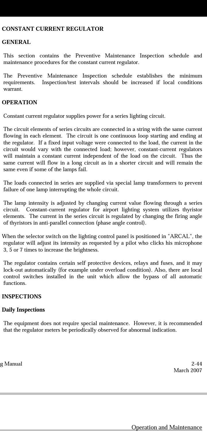

If it helps at all (which it probably won't! :) ), The whole circuit is fed from a constant current regulator -
Thanks. That helps quite a lot. I did consider that possibility, but wasn't too sure how one could engineer a constant-current AC regulator (it's child's play with DC!) - but what you quote explains how that's done, using 'phase angle control' with thyristors.
However, I don't think that alters the fact that there still must be something pretty 'odd' about the transformers. As bernard wrote, with a standard traditional transformer, the effective primary impedance (hence the impedance of all the primaries in series) would become very high if the secondary became open-circuit (e.g. due to a bulb dying) - so, unless the 'constant current regulator' was able to produce ludicrously high voltages (in an attempt to maintain the 'constant current') the primary voltage of all the other transformers would become very low - which clearly does not happen!
Kind Regards, John
Caveat - this information is from the "Remote Airport Lighting Manual" - ministry of transport - Ontario
(I can attach the .pdf if you would like - but it is 246 pages!)
I am 'usuming' at least some of this information is transferable ;)

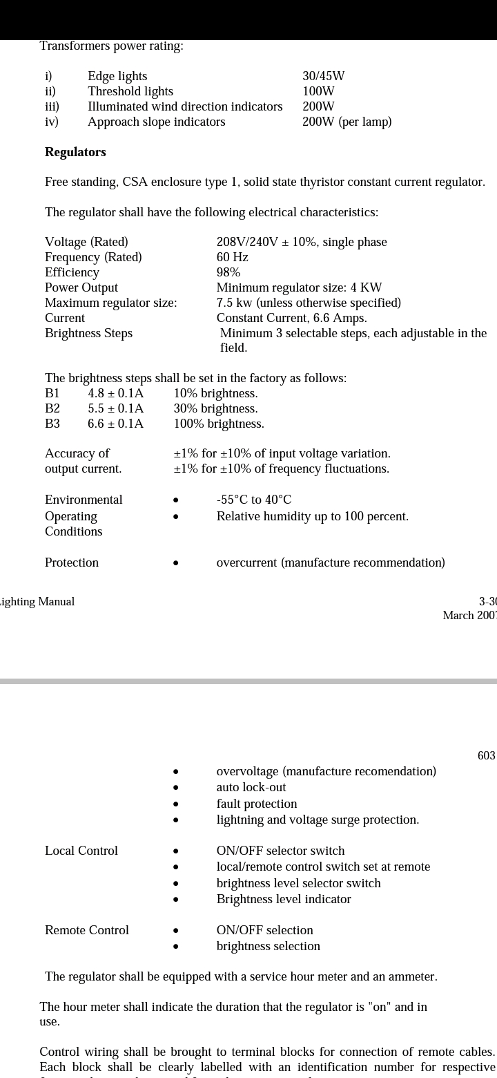

Is a kV ludicrously high? :)
(I can attach the .pdf if you would like - but it is 246 pages!) ... I am 'usuming' at least some of this information is transferable ;)
Thanks, but ....
... unless the 'constant current regulator' was able to produce ludicrously high voltages
I presume that comment results from your having divided the "maximum regulator size" (7.5 kW) by the constant current (6.6 A) and getting an answer of 1,136 V. Even if you had used the "Power Output" (aka "minimum regulator size", = 4 kW) you would have got an answer of 606 V
However, the material you are posting seems as clear as mud (at least, to me), so I'm not at all sure of the validity of your calculation. For a start, I'm not at all sure what "minimum/maximum regulator sizes" mean. I can but assume that "voltage (rated)" (= "208V/240V") is the input voltage, and one does not expect a 'regulator' to be able to provide an output voltage greater than the input voltage - so I'm already lost!
Even if the 'regulator' is more than just a regulator, and first transforms the voltage up to 1+ kV before regulating the current, I still struggle to see how that could be 'enough' if we were talking about 'ordinary' transformers.
I therefore remain pretty 'lost' :)
