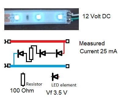

The current through the individual LED elements is determined by the supply voltage and the series resistor, Therefore it requires a DC power source and NOT an LED driver,
A driver forces a current through the lights. It measures the current and automatically adjusts it's output voltage to be the voltage needed to drive the rated current through the LED elements,
Which results in the un-formed DIYer ( and some "professionals " ) connecting a driver ( current forcing ) to a lamp and the LED elements in the lamp being destroyed by too much current being forced through them

Their illuminated table decorations were designed to operate from a 12 volt battery, each decoration used LED tape, 24 LED elements in 8 triplets connected in parallel.
When the room layout was changed and most tables were then close to a wall It was decide to replace batteries with a supply.derived from the mains,
As they were LEDs it was obvious that an LED driver was needed.
12 decorations were converted,
Switching on the first converted decoration produced a short lived very bright flash of light,
The other 11 wre restores to battery operation
Investigation
Supplied with constant 12 volts from the battery the 8 triplets per decorations took a total of 200 mA
A test rig was set up using triplets very similar to those in the decorations, they were destroyed when then LED driver was switched on.
The LED driver wanted to drive 300 mA through the array of elements and raised it's output voltage well above 12 Volts. A peak recording voltmeter recorded 32 volts on the supply to the triplets

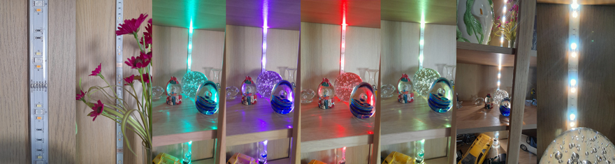

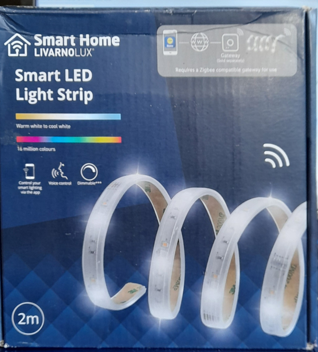

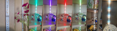

But the question was about light output, not the names given to devices, so a LED Light Strip 1656138508666.pnghas a number of components. The box Lidi-Smart-strip lamp.jpg shows what it is and this Lidi-Smart-strip lamp3.jpg shows what it looks like, it seems one can select either colour changing or colour temperature changing, the wires are labelled FW, G, B, R, C, VCC and there are three chips repeated D1, D2, D3 the D2 has 6 connections and is the colour changing the D1 and D3 are warm white and cool white and one can select the brightness of each to get the colour temperature required, there are three resistors to stop elements being over driven. The power comes from a wallmart (2) but this feeds the LED controller (5) the total power consumption is 22 watt, but the LED controller stops one using the white light and coloured light together, here shown lighting a display cabinet, also have one lighting kitchen counter.
This strip light is bright, in fact two bright, so never run at full output, however the two Ikea strips in the cabinets either side are not flexible, and no where near as bright. The Ikea ones would be useless under the kitchen cabinets lighting the work top, although they do make the ornaments look good.
The problem is one tends to buy strip lighting from the internet, so until it arrives one is not really sure what you are getting, and common not to have any lumen output advertised. The Lidi lights shown do not show lumen output, comparing with other lights I would guess at around 1800 lumen when full on, which is about the same as 4 x E14 bulbs. But the Ikea strip light would be less than one E14 bulb.
I would expect around 60 lumen per watt for more strip lights, although some can be down to 25 lumen per watt, but in the main they are for decoration not lighting a room.

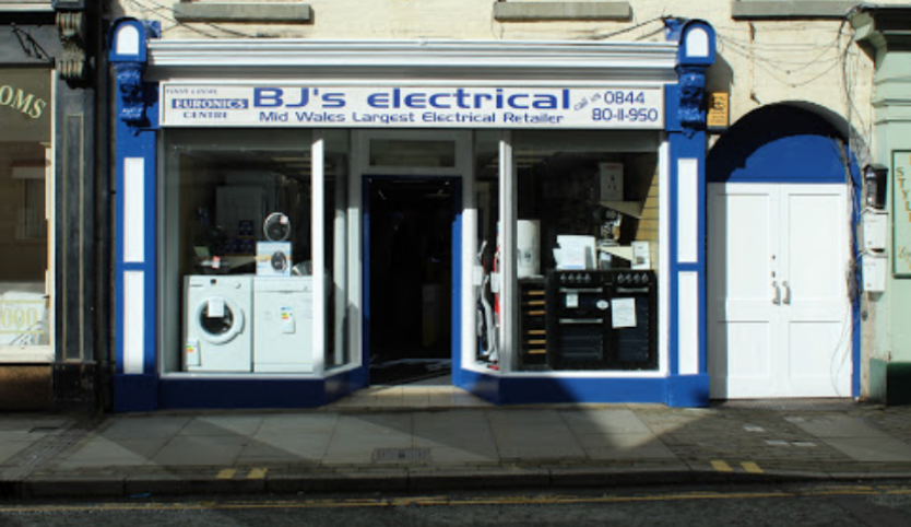

There are three local shops, and I will use them, but shops like this 1656145335243.png are rare now,
Sadly, that is very true. There is a particularly good shop for such things about 12 miles from here, which is either four buses, or a drive and struggle to part. They used to sell absolutely everything electrical or white goods parts. Unfortunately the original, knowledgeable owner either died, or retired, since when - run by a relative or paid staff, it has slowly gone down hill. No point going in now and asking have you a so and so, for a ??? - The best they can do is ask what it might look like, or can you see one yourself. Such a shame, no wonder people shop on line.
