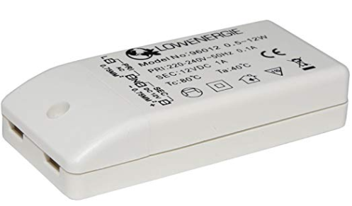

Led down lighters flickering
So I need to take the transformer back to the shop and ask for one suitable for Leds?
Yes, but what you have is a switch mode power supply. What you need is a 12v power supply for LEDs.
Like this one
So you are saying a driver is a constant current device?
I am saying a driver controls the current, it may be constant ( preset ) or it may be variable when dimming of the LED element is required
What is often sold as a driver is generally a DC power supply (constant voltage).
If a DC power supply (constant voltage = Vo) is connected to an LED element then either
(1) the LED element will not light if Vo is below the LED's forward voltage
(2) the LED element will burn out if Vo is higher than the LED'd forward voltage and there is no current limiting in the power supply
So what's the difference between these electrically?
The transformer I have works some of the time and flickers some of the time.
The SWITCH MODE POWER SUPPLY (not transformer) you have operates at tens of kHz AC. It is designed for halogen lamps ONLY.
The one I pictured operates at 12v DC. It is designed for LEDs.
As I have already said GU5.3 LEDs are designed (usually labelled even) DC or 50/60Hz AC.
