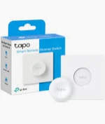

That is the bit I have read, did not go any further, so I would fit a TP-Link light switch, as easy enough once a year to remove mirror and fit new batteries, likely better using kinetic as already said, as no batteries required, the difference between the two is the Tapo (TP-link) will also connect to internet, so can use voice commands as well as a remote control 1732103429172.pngwhich look like a push button switch, but also has a magnetic back so can stick to anything metal, the switch comes with a sticky back metal plate, so could even go on the mirror if you wanted.
Moving the wires will be expensive, but maybe just fit the smart/kinetic switch higher up above the mirror, if not used, does it matter where it is?

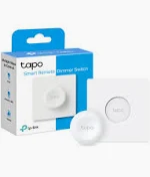

That is the bit I have read, did not go any further, so I would fit a TP-Link light switch, as easy enough once a year to remove mirror and fit new batteries, likely better using kinetic as already said, as no batteries required, the difference between the two is the Tapo (TP-link) will also connect to internet, so can use voice commands as well as a remote control View attachment 363386which look like a push button switch, but also has a magnetic back so can stick to anything metal, the switch comes with a sticky back metal plate, so could even go on the mirror if you wanted.
Thanks for the suggestion, yet another option that I'd not heard of before.
Plans to do anything with this have been pushed back to the new year so I'll have Christmas to decide in the way forward.
Thanks a lot for the suggestion :)
