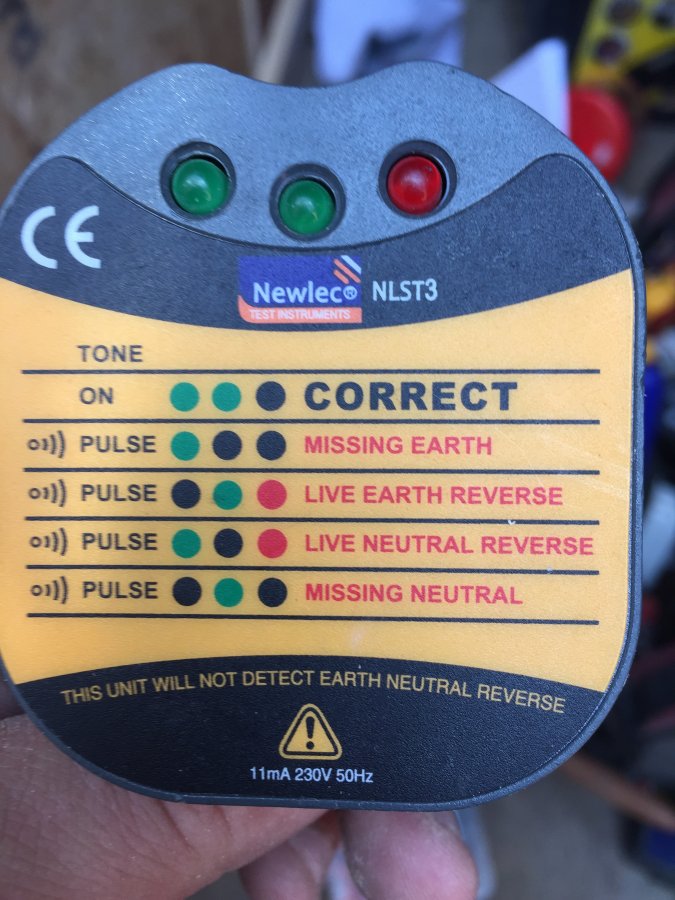

View attachment 81871 If it was a missing earth shouldn't this tester pick that up and not just guess at L N reverse
Yes, it obviously should. Furthermore, as I wrote earlier, it it's very hard to see how, even if it were designed badly or faulty, it could end up displaying 'L-N reversal' when the true problem was actually a missing earth.
Kind Regards, John
Which would it show if you had a missing earth AND reverse polarity?
I don't think anyone knows exactly how these testers actually work.
Presumably they just measure voltage and/or continuity between the terminals and compare with what it should be.
That is: should be 240V L-N & L-E and low ohms N-E.
Do they recognise actual polarity of AC?
You could swap the L and N in one of the sockets and see what the tester shows.
HOWEVER, the point is that, I hope, no electrician would, after it being shown as reverse polarity by one of these testers, just blindly go ahead and swap L and N without further testing with accurate proper testing equipment.
Neither should you.
If there is a missing earth, my Martindale one shows 'Missing Earth' whether the L-N polarity is correct or reversed. I think that makes sense since, in the absence of a usable earth, there's no way I can think of that the device (or even an electrician, if all they had to work with were the three terminals) could detect an L-N reversal.
I don't think anyone knows exactly how these testers actually work. ... Presumably they just measure voltage and/or continuity between the terminals and compare with what it should be. That is: should be 240V L-N & L-E and low ohms N-E.
The only one I've ever taken apart (a long time ago, so they may have changed) appeared to just look at the L-N, L-E and N-E pds.
I'm not sure what you mean. The one I took apart reported L-N reversal if the N-E pd was much greater than the L-E pd.
HOWEVER, the point is that, I hope, no electrician would, after it being shown as reverse polarity by one of these testers, just blindly go ahead and swap L and N without further testing with accurate proper testing equipment. Neither should you.
That's obviously correct. Given access to some 'known earth', the only 'proper testing equipment' one really needs is a voltage indicator or multimeter, but reliance on a plug-in thingy would be inappropriate.

Just to show that these things are not that reliable, what would it read where the socket was wired correctly but the cpc had become disconnected from earth and had become live(240V)?
Now that's interesting, particularly in relation to this thread. I've just tried that with mine, and it reports an L-N reversal.
If you think about it, that's logical - it is seeing 230V between N and 'E' and 0V between L and 'E'. An electrician who had access to nothing other the three terminals of the socket (no access to a 'known good earth') would presumably come to the same initial conclusion ('L-N reversal'). However, to be fair, that situation requires two simultaneous faults (CPC disconnected from earth and CPC connected to L), so it probably very uncommon.
