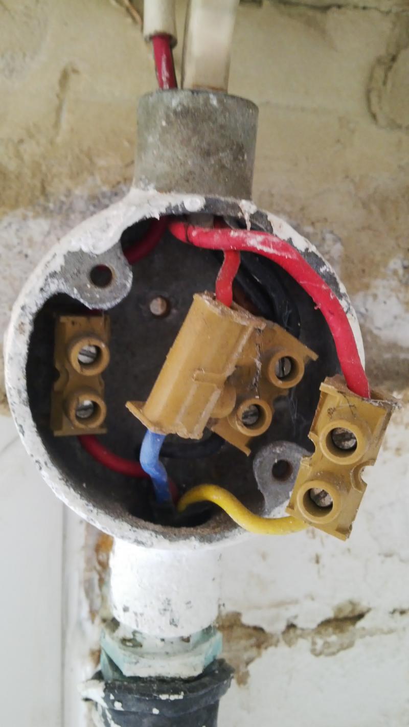

See if this helps any...
Main supply in garage. Mains incoming on right, marked dual supply. Main RCD for house along top. Outbuilding fuse box bottom left. (Third feed running off to right goes to solar panels).
There are four fuses. One 30 amp goes to a separate circuit for a shower. The other three (5A, 15A, 30A) all go to this metal junction box:
There are 4 incoming wires, red, blue, yellow and black, feeding in from bottom. Each colour is (presumably) connected to a different fuse and becomes the live for each circuit within the outbuilding at this point. All returning neutrals connect together here, connecting to the black wire and (presumably) returning to a common neutral in the fuse box.
As a thought, there is no earth here, ie although I have earth connected throughout the earth wires coming in at this point dont connect to anything - could that be a problem?
I haven't touched this, other than to open the box to see what is happening inside, unless pulling the yellow wire out has disturbed the neutrals here?

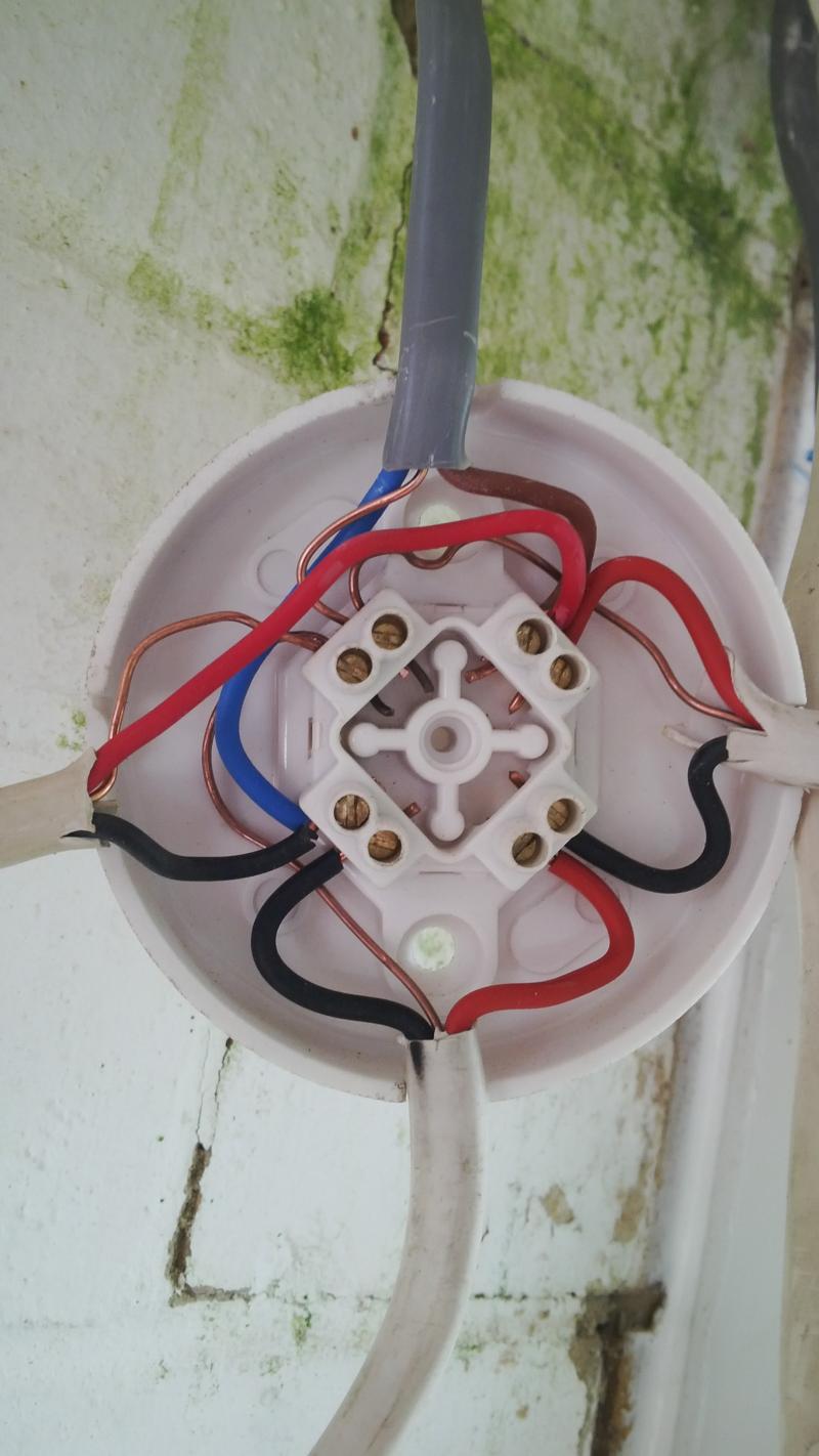

From there it goes to the first lighting junction box:
Incoming supply is on the left. Outgoing supply to next light is the grey wire at the top (so I have a thru live and thru neutral, yes?)
Switch is right cable, connected to live and loop, light is bottom cable, connected to loop and neutral.
I think you could do with an electrician to make sure things are safe ( earthed)
The thing at the top isn't an rcd.
Lacking earth sleeveing in outbuilding and possibly not earthed.
I can't actually see any earth running into that lower wylex board at all... Any chance of a wider shot that shows the electricity board meter and cable head to?
As to the fault, I'm thinking along the lines of a high impedance earth connection either through a deliberate earth electrode or by a path thats occurred through some other means (water pipe, etc). Lack of RCD protection (evident from the pictures) and the lights using the high impedance earth as a return instead of the neutral.
But to be honest it looks a bit of a mess; the 4 core SWA (the steel armouring is supposed to be the earth in answer to another point you raise) with three circuits and one neutral is certainly not permitted for a start. You really need to get an electrician there before the ceilings go back to sort the mess out properly as you more than likely have lack of an effective earth to parts of the installation
