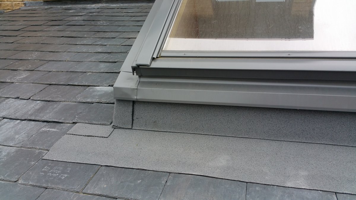

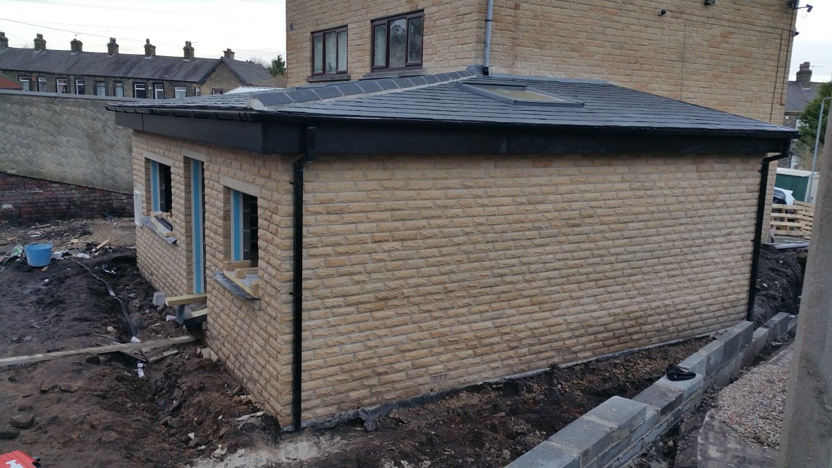

I understand what you guys are saying but the fact is I'm in this situation and need the best overall option removing the slate I'm not sure that's possible building control passed it but as you can see it's very low pitch. The first photo shows the roof without the Velux kerb those were added later as the windows were leaking through the sash but I'm in a difficult situation at moment

250 x 500 natural slate poorly laid the only way you stand a chance is the boarded roof with counter batten and torch on method. I would re position the down pipe from the main roof too. while its all off maybe swap the ridge tiles used for flatter hip tiles.....
Nailing a pitched roof through a flat roof is called bodging where I come from.
I am surprised that you have never come across this. It's been pretty standard for years and years as far as I can remember, approved by all the LA's around here.

Oh if a BC let's it through that's the be all and end all. It seems Building Control accepted slate on a flat roof to start with.
That said down this neck of the woods for lower pitches BC will allow ondutile (which is not permitted at this pitch anyway) or the proprietary seals* that go in between the slates, I forget the name, but again unsuitable for a flat roof like this, They will not accept your fudge.

However, no matter how many times you say it, a tiled roof on a shallow pitch looks WRONG. No architect/designer worth his salt should be encouraged to design something that has no architectural position.
You can still harmonise with surrounding materials using more suitable methods. It is still a bodge and it looks shoite, therefore should not be considered as a solution.
I agree with Nose on the fact that it looks crap with slate on pitches if they are too low.
However I totally agree with Woody and Datarebal, the felted method underneath is a tried and tested method. I have done it my self without a problem; layered as follows;
OSB deck
2 layers felt
counter battens
felted over
slate battens
slates
If you get any leakage through the slates it is highly unlikely that it will be down the nails and then it would have to penetrate through the felt run down the counter battens and find it's way through the counter batten nails as well. from memory, I think I went a bit belt and braces and used gutter mastic along the top of the counter batten felt before fixing the slate battens.
