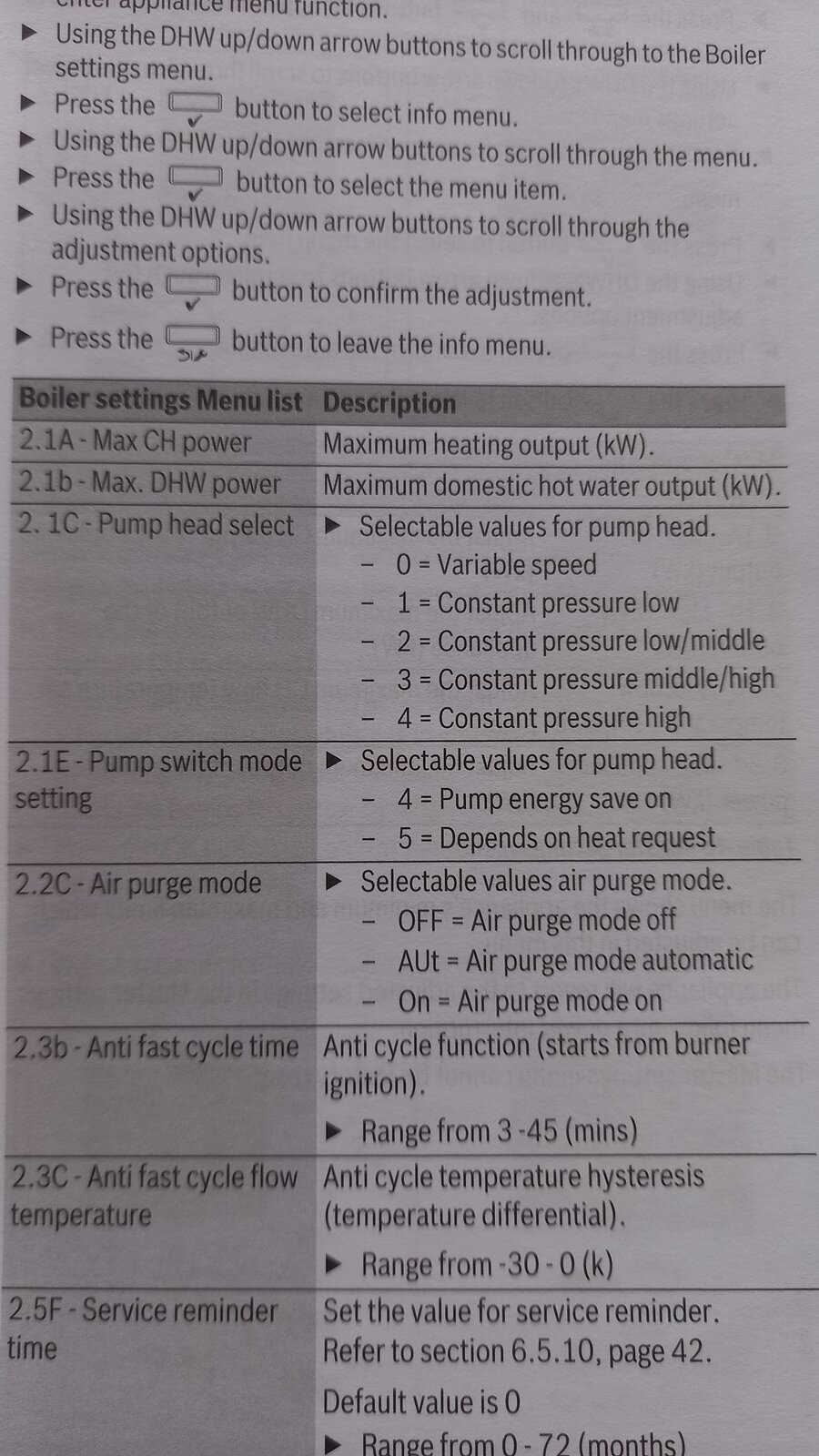

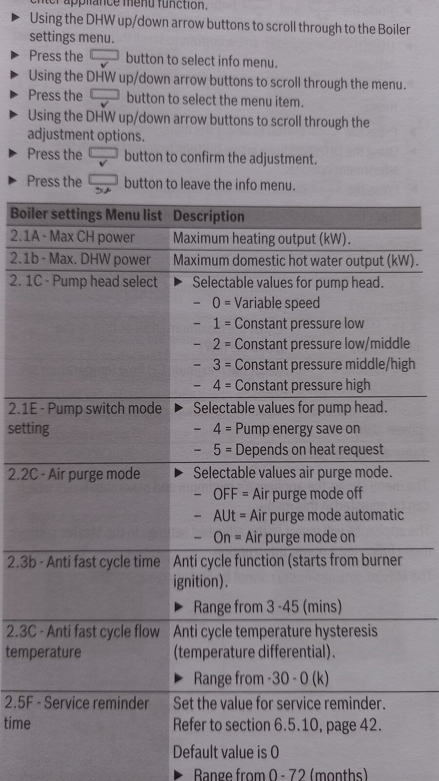

The boiler pump head is set to "4 = constant pressure high".

In addition to all this, I have set the pump head setting to 1 (it was originally on the highest, 4) so the speed of flow is reduced, and I have reduced the central heating output from the maximum 24KW to about 9KW. These settings have caused no problems for me.
