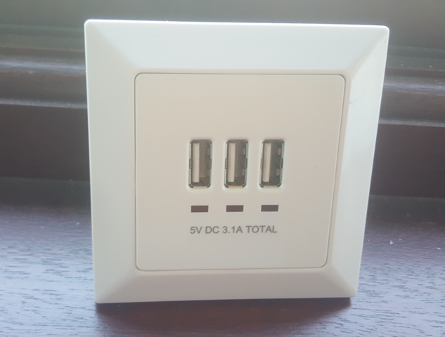

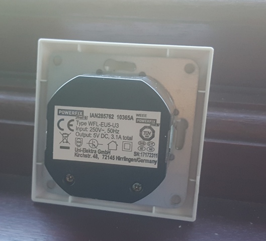

Lidl did a three way version sometime ago, i bought one and never fitted it. If i can find it i will put up some pics

found the one I got ages ago from lidl, must get round to fitting it!!

Thanks for the photo, links and info.
I was thinking of installing one on each side of a double bed. The MK socket switches off when the cables are removed, and there there may be some slight safety improvement in this; however, it has just the two USB outlets (not 3 or 4 as per Knightsbridge and others).
Presumably 2 USB outlets per socket is fine for most people i.e. charging a mobile - I'm not sure how many other devices people are charging via a USB socket.
