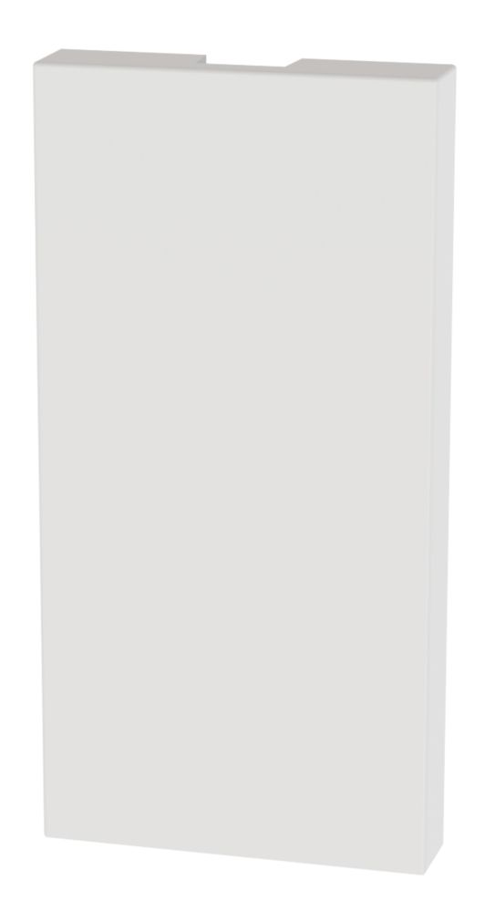

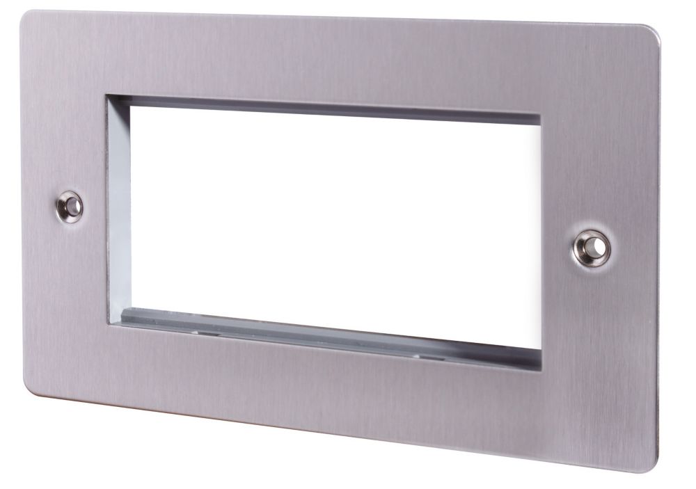

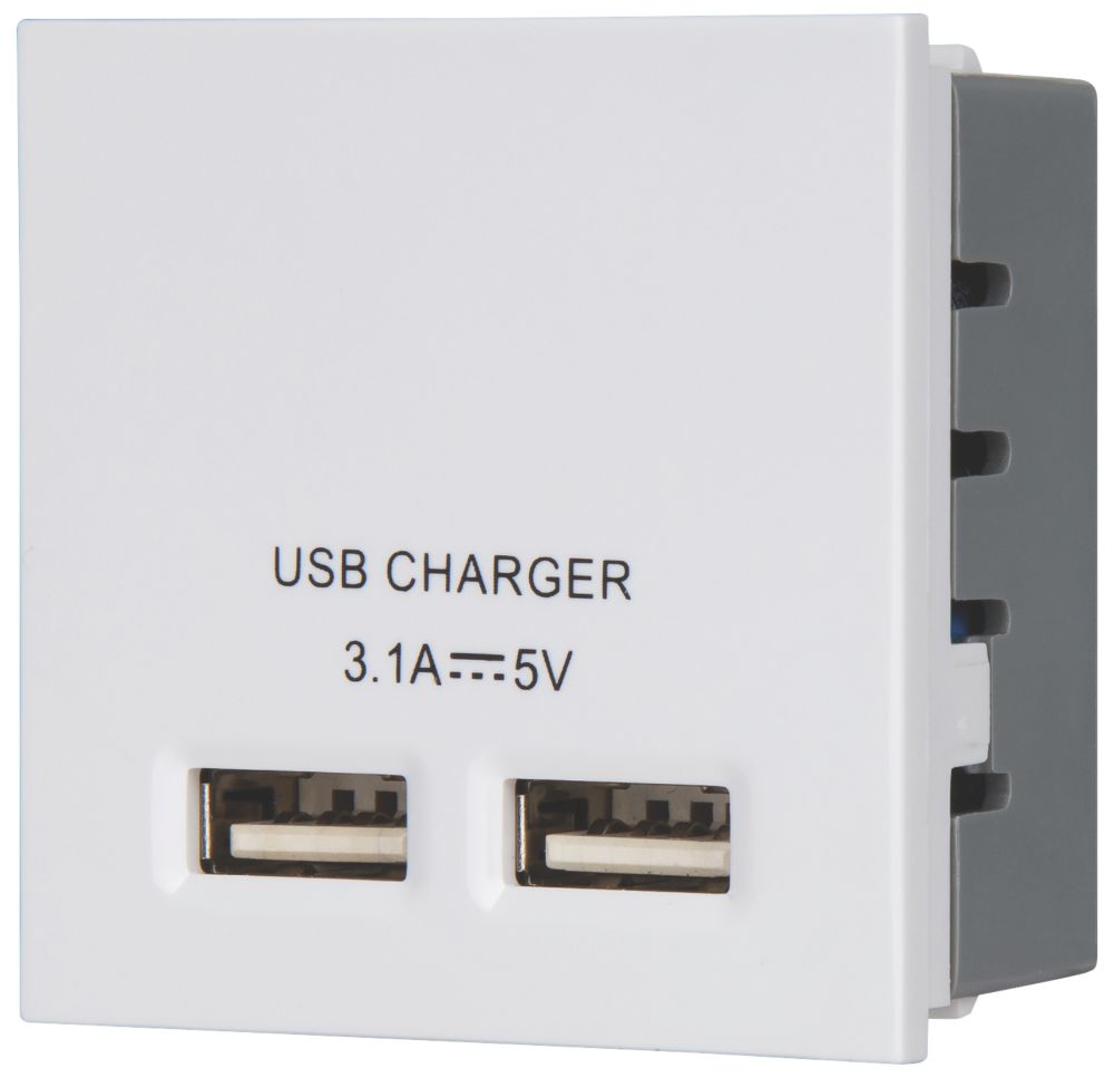

You can use a grid system
ae235
a USB outlet a couple of blanks
94852_P
and a face plate
46537_P
and you can make a USB outlet to suit what you want, may be brushes
ae235
so with LAP grid system you need a double back box, other makes may have a single module for brushes and USB, I have used LAP from screwfix as easy to build what you want, it seems Legrand do a single modular unit but can't find it in UK pounds so not sure.

That's a very good idea thank you. Shame though, like you I can find a single module brush outlet but only a double USB module so have a to be a double grid. Never mind I can probably sort something out. Many thanks.
