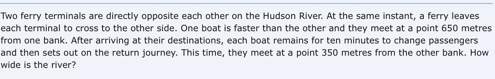

MATHS HOMEWORK FOR A 12 YEAR OLD

That question is wrong.
If the boats waited after the first crossing, until they could both start their returns at the same time, then things would be as the answer suggests. But that's not what the question says.
The faster boat gets 650/1000ths the way across going out. It would therefore arrive earlier, and after its 10 minutes wait, would start earlier on the return leg than the slower boat. Therefore it would get FURTHER than 650 yds across before meeting the slow boat. 350yds from the opposite bank, is impossible.
I wonder how many people couldn't see it so thought they must be at fault?

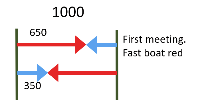

I don't think the wording allows an actual solution.
For the first crossing, given the answer, blue must be 1000-650 = 350
If they leave at the same time, later, ignoring the 10 minutes, it works as in the second meeting shown.
If the fast boat turns before the slow one, as suggested, then the second meeting would be nearer the left bank, But we know that's at 350.
We know they both turn round so no funnies there; it hasn't come up behind it to meet it, etc.
Did you understand wot I rote?
I think it's valid, but words can have more than one meaning etc.

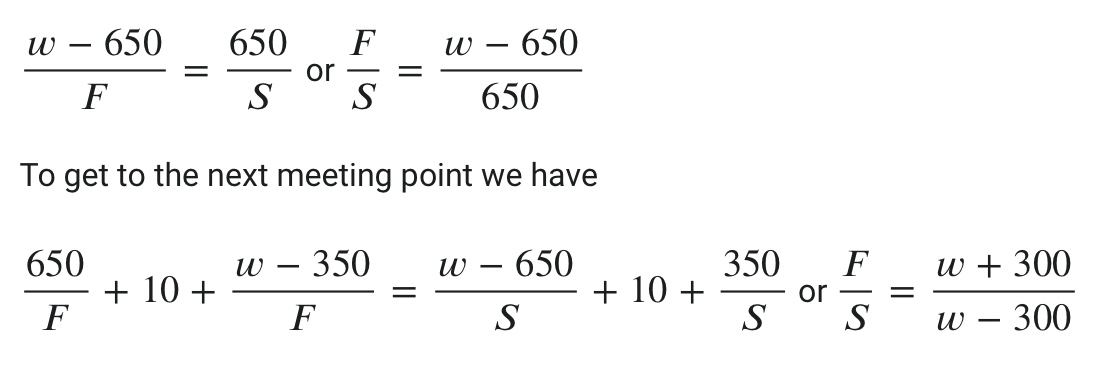

Let F be the speed of the faster boat and S be the speed of the slower boat ( both measured in meters per minute) and let w be the width of the river in meters. Using time=distance divided by rate we get the first meeting at:
Equating, multiplying and solving: W = 1600 meters

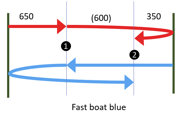

First, there's more than one way to work out what the boats did, from the question - it needs to be drawn out. If you assume boats leave the other sides of the river it's an unhelpful detour!
Second, forget about time, after knowing that during the first crossing, the slow boat did 650m, and the fast boat did the rest. Yes you can work out the ratios of the speeds of the boats if you want to and use it to work out what must have happened, but you can just draw it instead. The ten minutes' stop is a distractor. They both stop for once for 10 minutes, so it doesn't enter the equation.
Not to scale:
You're given the 650 and the 350.
The "Three crossings" thing is now obvious, that BETWEEN THEM the two boats have done three crossings.
They have NOT done three crossings each.
You know that in the first crossing (of the two boats between them) the slow one did 650m.
So for each of the crossings, the slow boat's "contribution" if you like, is 650m
The "solution" is misleading if you read it as saying the slow boat has done three crossings; it hasn't.
You can say that during the three crossings, the slow boat's contributions must have been 3 x 650m, = 1950.
Then look at the pic to see that by itself it's actually done one crossing, plus 350m, so take the 350 off to get the 1600.
Then everything fits and you wonder what the fuss with the speeds and the distances and cancelling out of denominators....... was all about...
