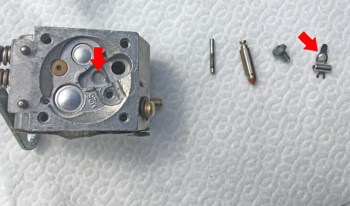

I did take it apart last night & clean with carb cleaner but will do it again.

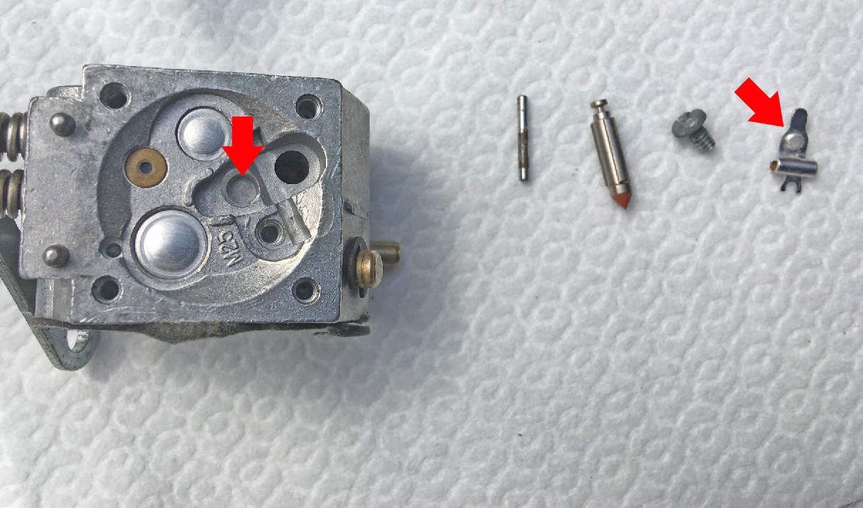

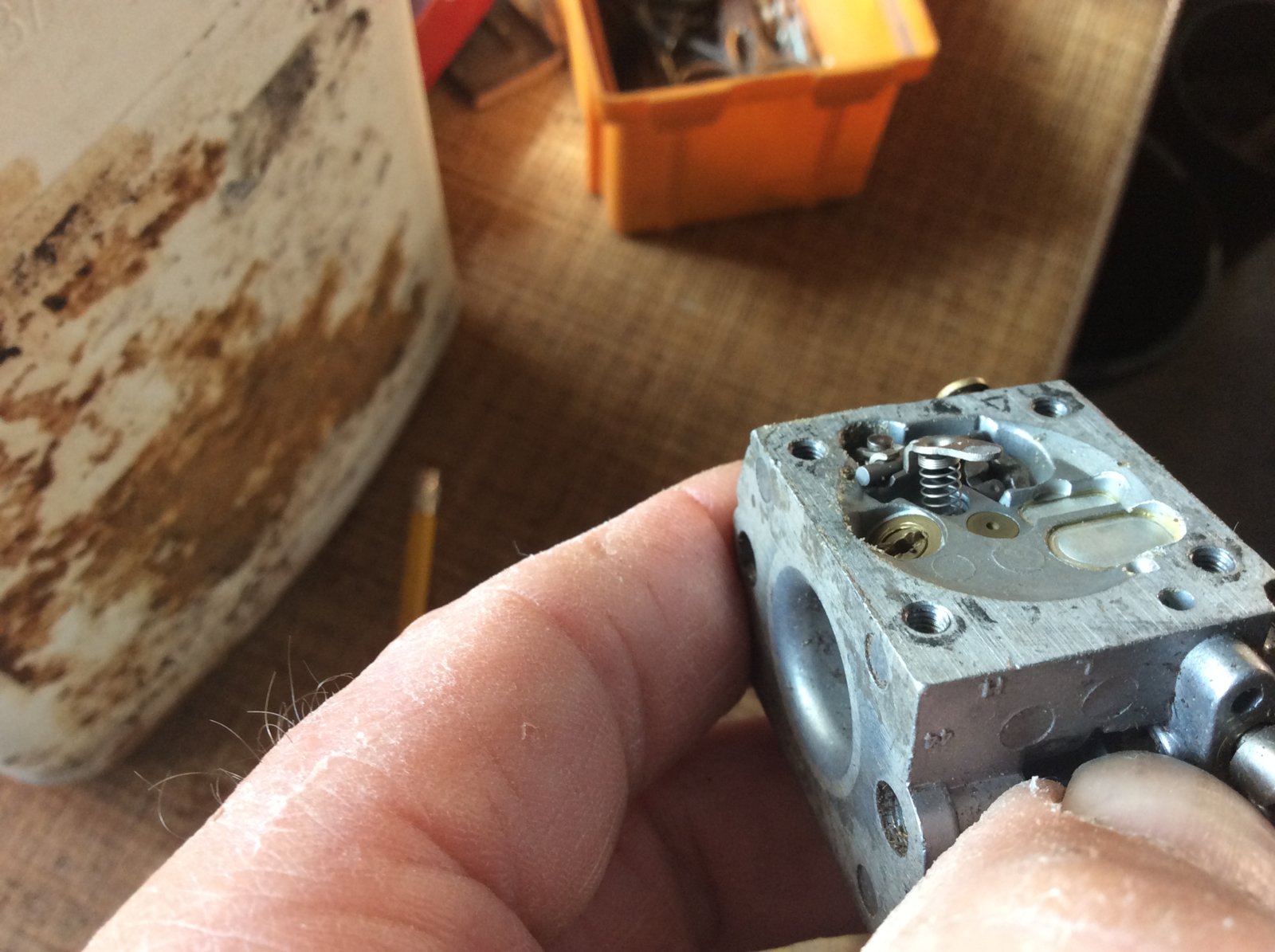

Question please.
Ive now got it apart again & cleaned with carb cleaner.
With with regards the item in the photo should there be a small ball bearing etc.
I have the following.
1 x screw
1 x needle valve
1 x pin
1 x plate which connects to the needle vale & then the pin fits through it.
I was thinking that somthing should go where the red arrow shown in photo is pointing because there is a hole in the plate as if it should rock on a bearing etc.
Also there then is an empty space under it so why even drill out the space is not is to go there,same for the plate why the hole if there no use for it ??
Sorry you are correct and my mistake.
There is a spring & now refitted.

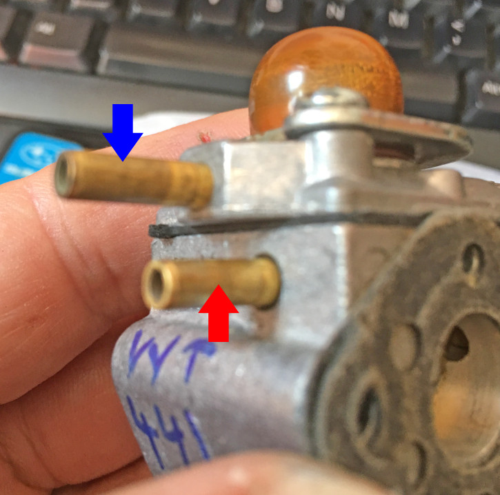

Now just to cover something else to cover my tracks as i cant go by how i took it apart should the owner have taken it apart.

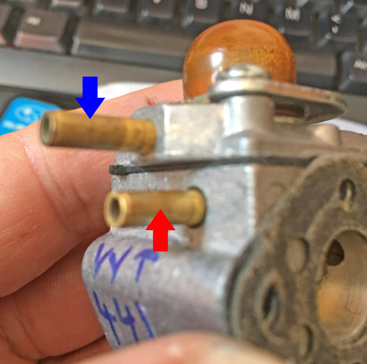

The 2 fuel pipe connections.
We have one marked red & one blue.
Which is inlet & which is return ?
The one marked with the blue arrow.....If i put my tongue over it & press the primer bulb then the pressure in the primer bulb raises & becomes hard to press.
When i remove my tongue the pressure then comes out of that pip & the bulb is soft once again.
I dont see any kind of reaction at all from the lower pipe connection.
Both pipes are the same diameter.
One is fitted to the main carb body where the other can be removed with the primer bulb plate.
I can then continue once advise so i then cover all my tracks.
Thanks for your time.
Thanks.
So red is the return.

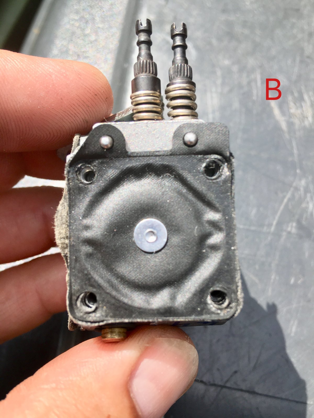

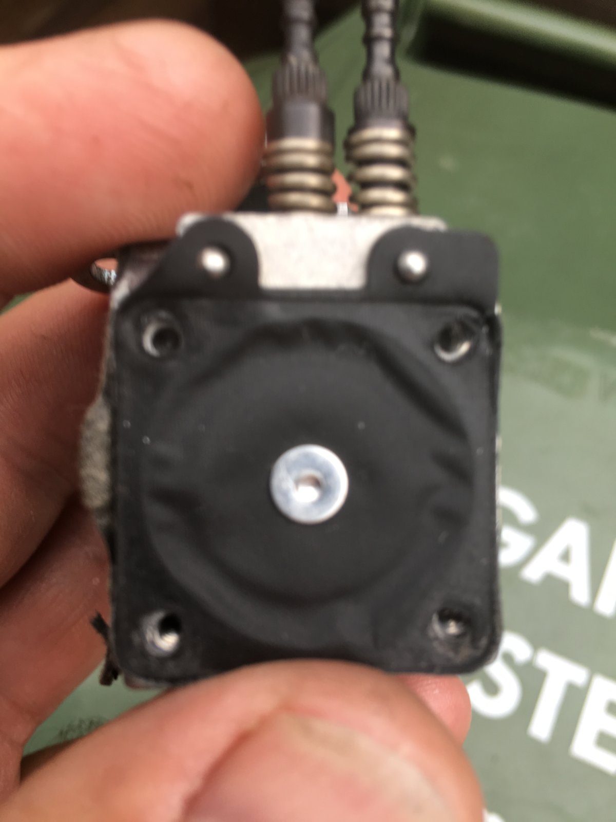

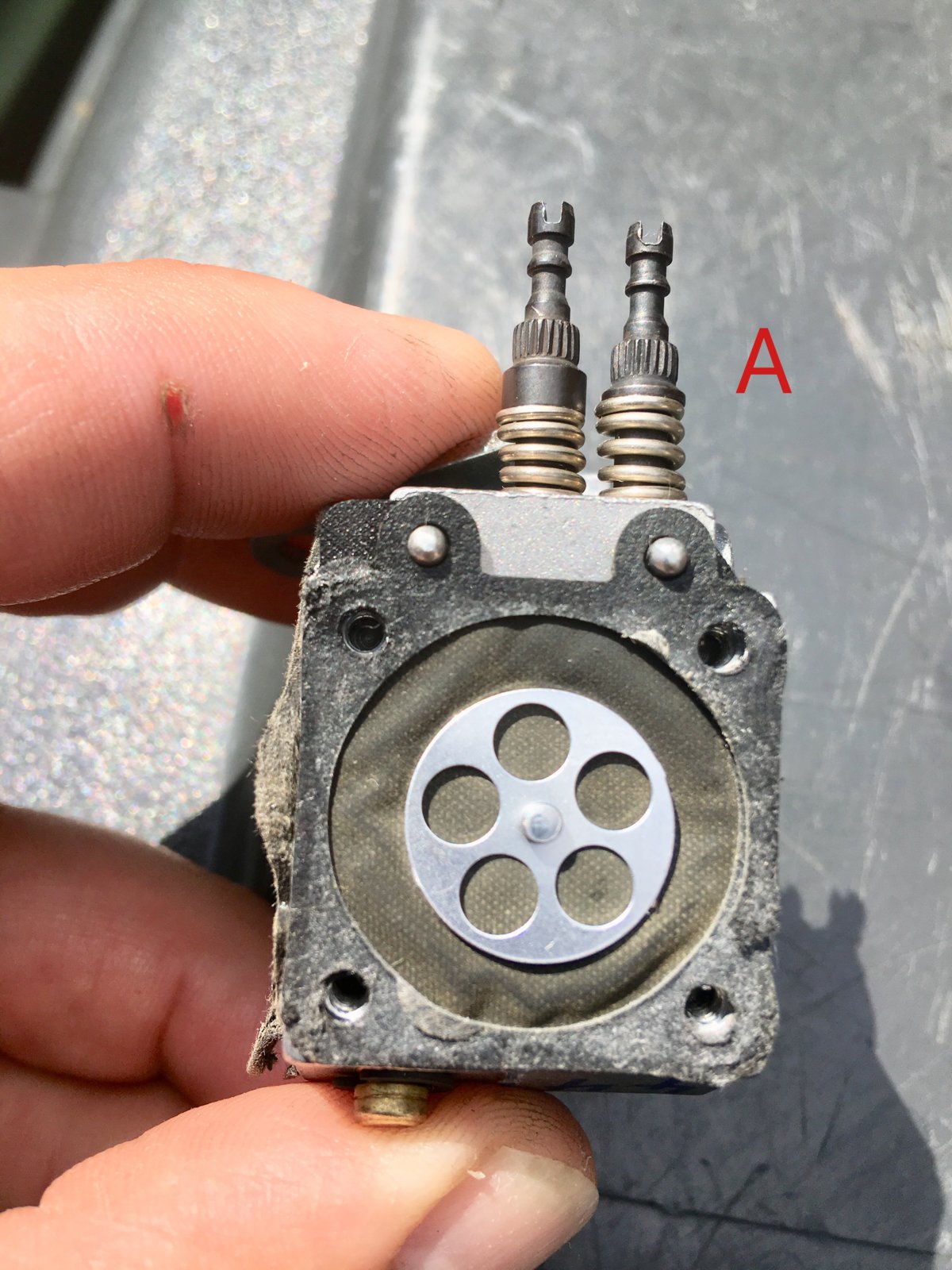

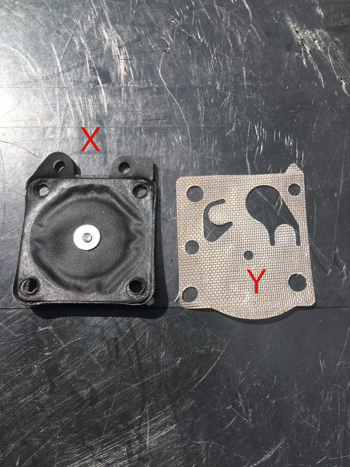

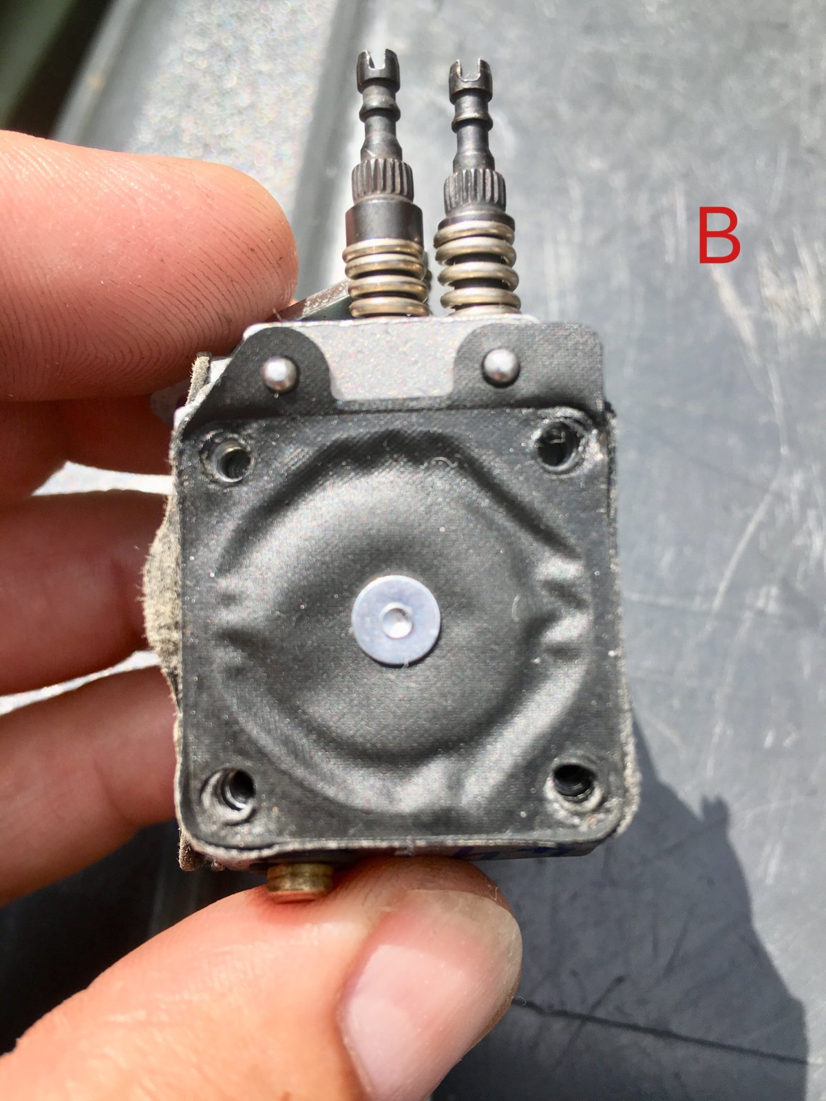

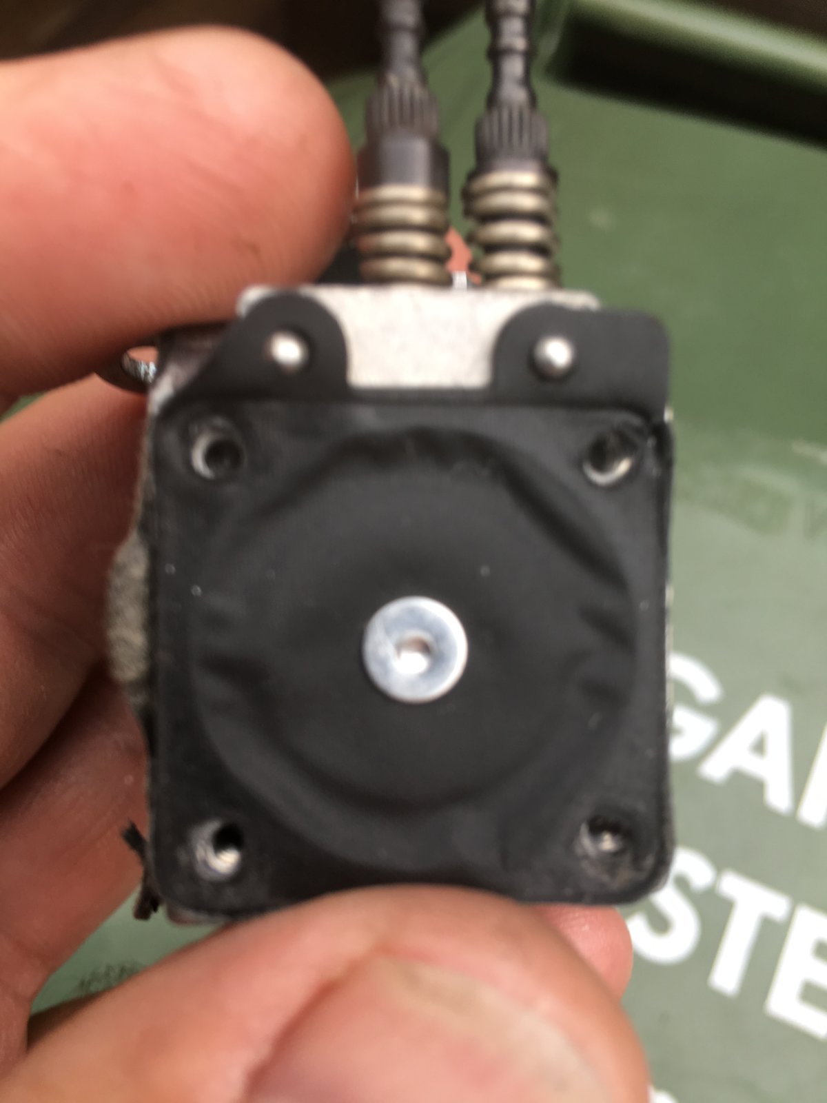

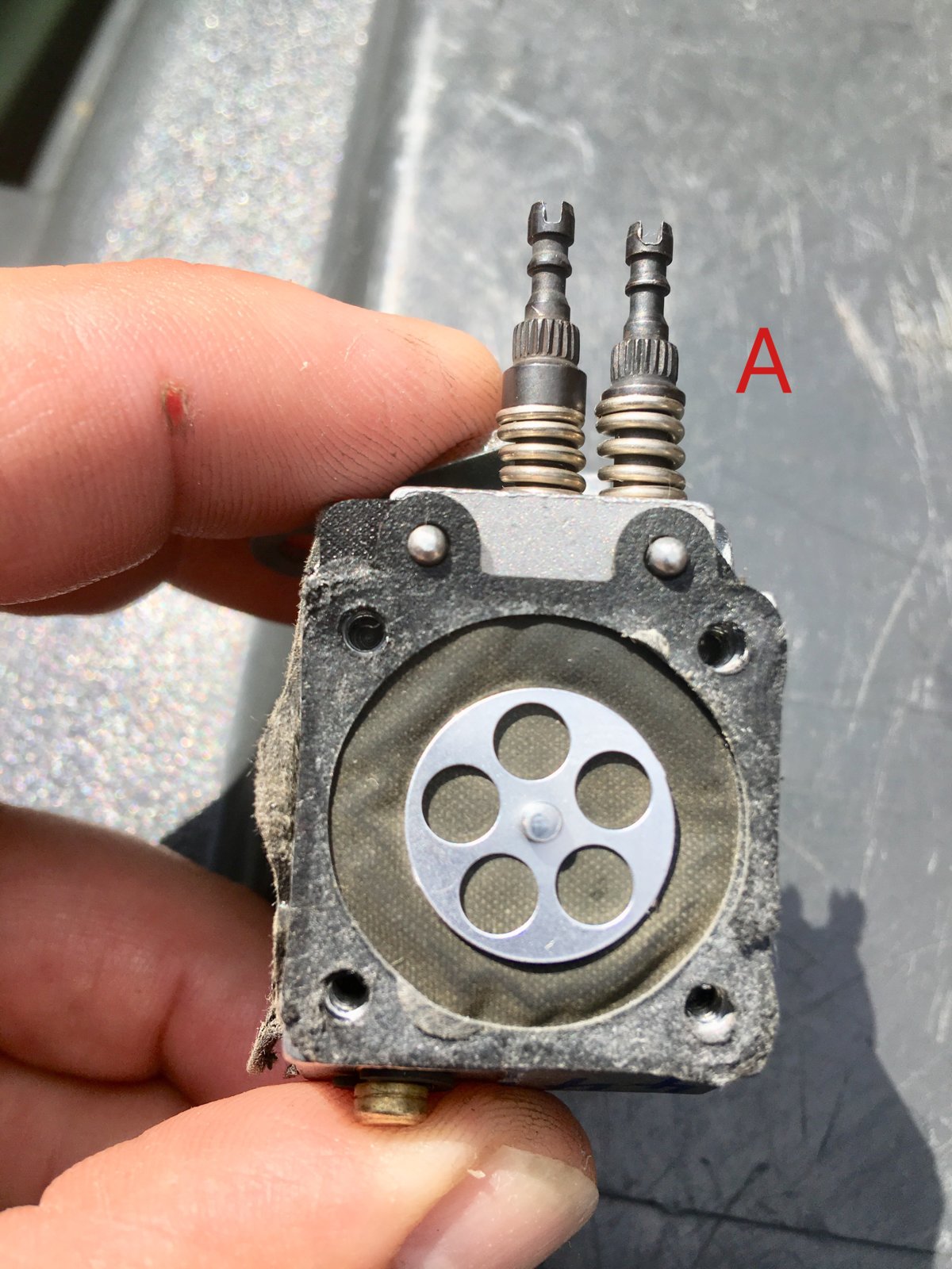

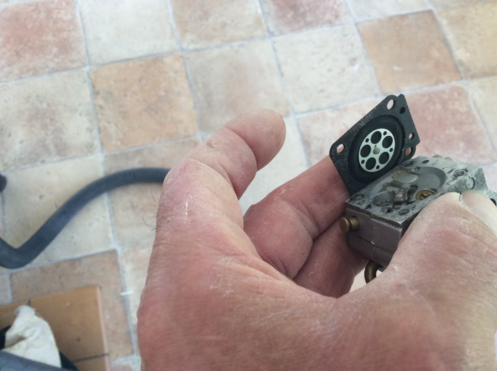

I have attached 3 new images.
Looking at photo A & B which way round is correct.
Then once I have that the correct way around which is fitted first X or Y
Thanks.
Hell, this is getting like University Challenge .......
The diaphragms fit close to the carb body, with the gaskets next.
A is almost correct but the diaphragm is upside down.
John :)
The diaphragm is either fitted like A or B due to the two locating pegs.
So when you say A is nearly right but upside down then it must be fitted like B

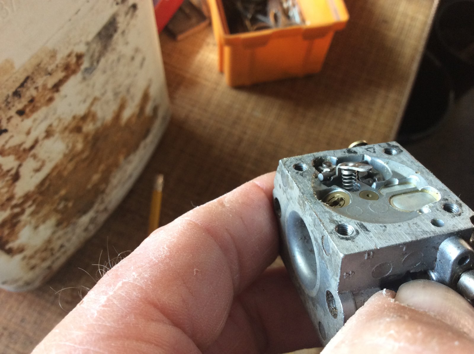

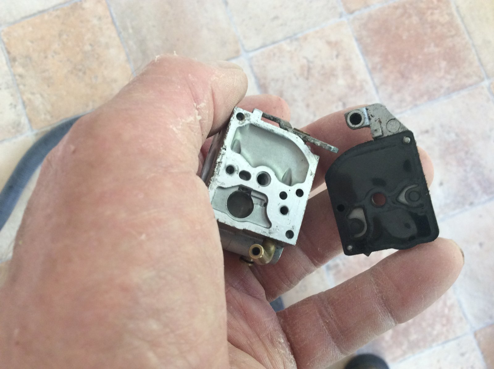

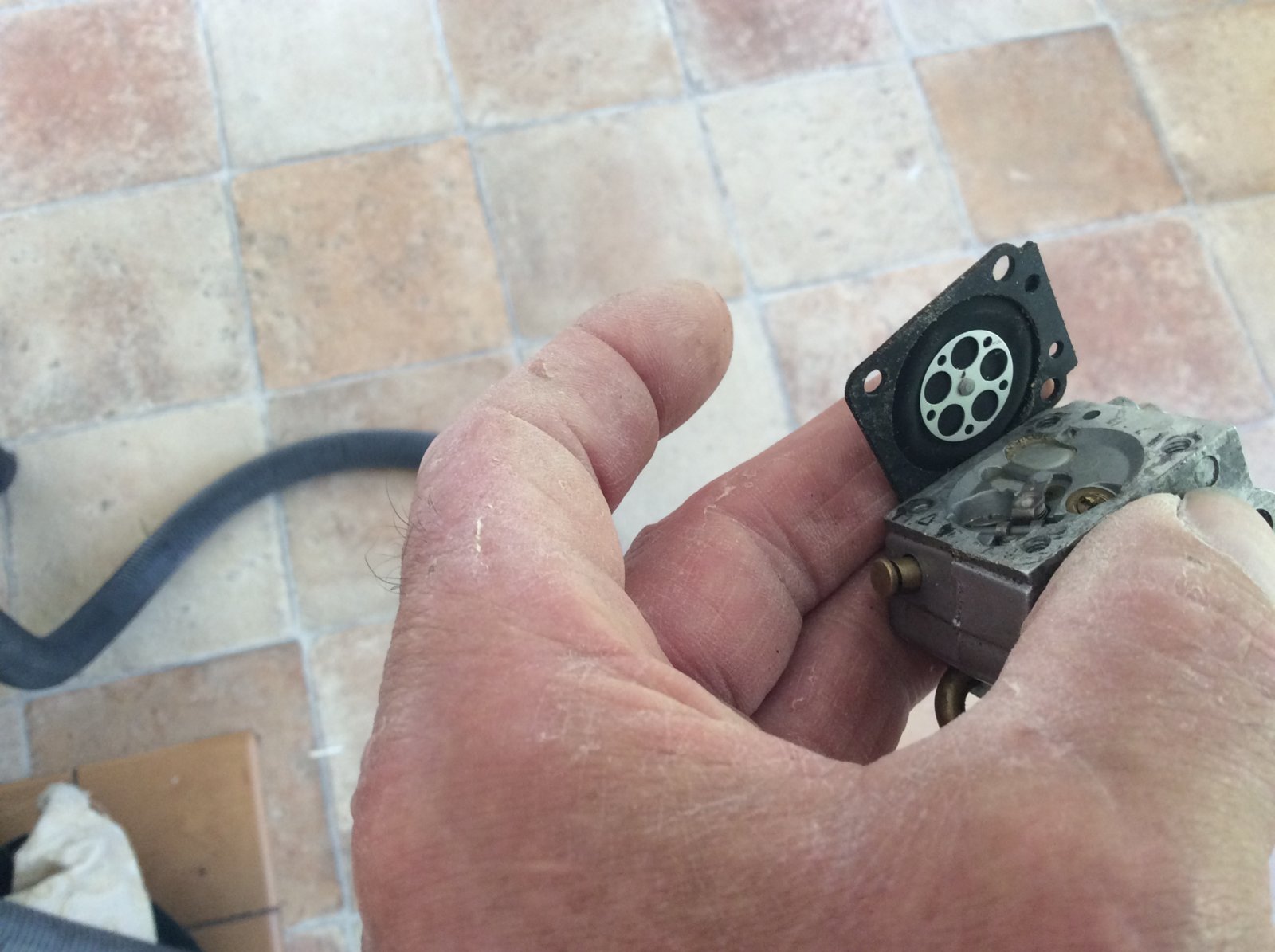

So this is the correct way to fit the diaphragm as shown in attached photo correct ?

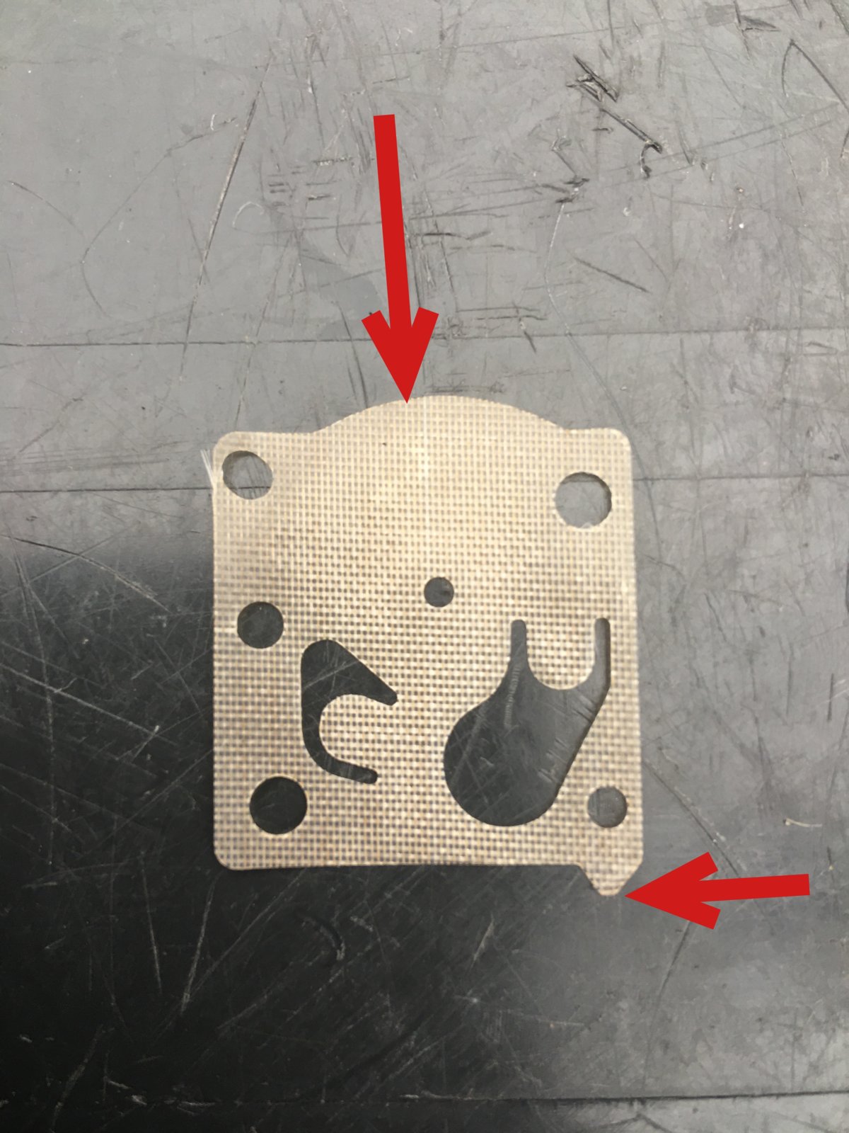

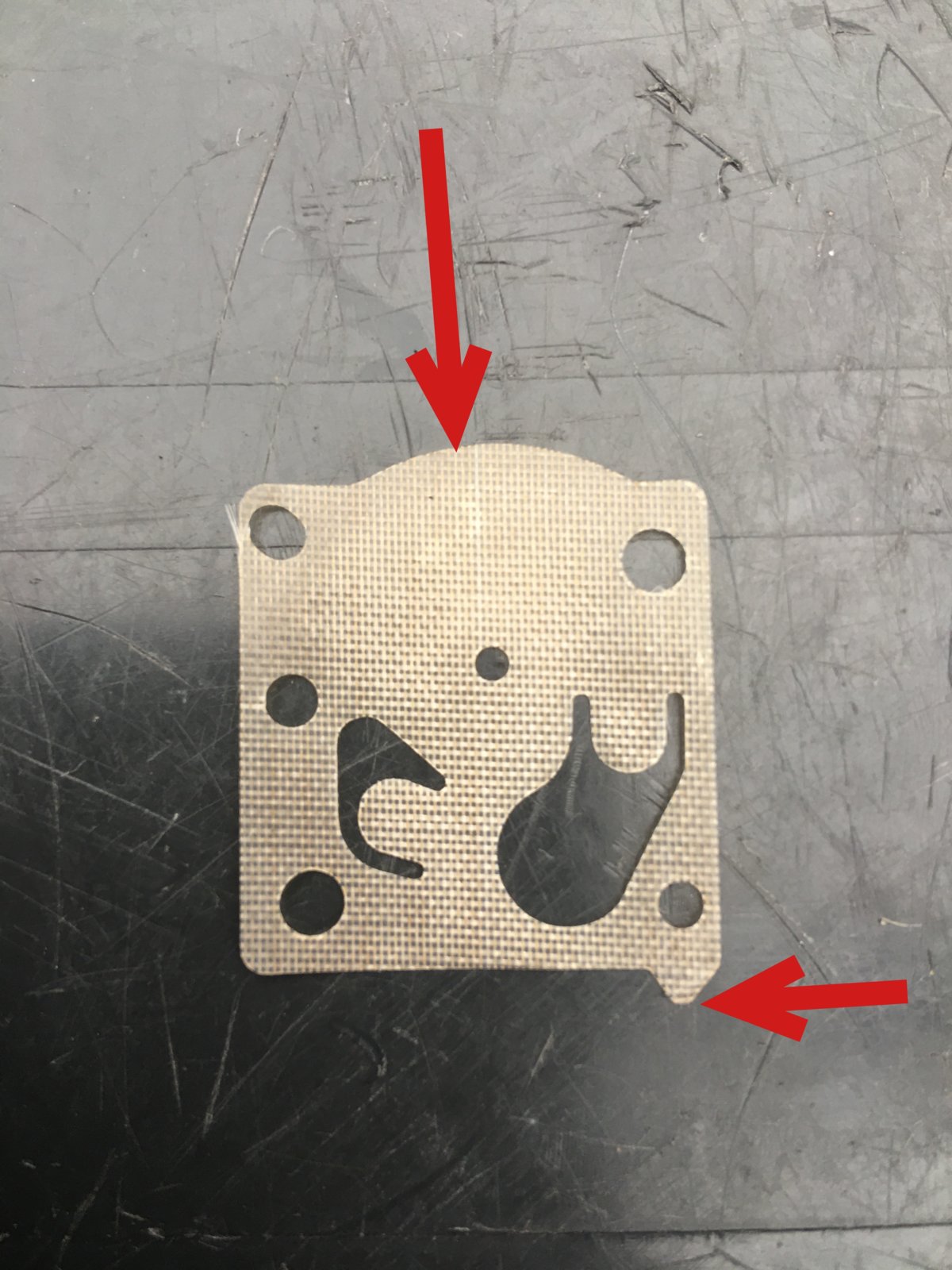

Then the flimsy brown gasket.
I’ve positioned it in every possible way but it doesn’t line up with all 4 holes unless it’s raised / dished etc.
So starters for 10 we have w the hump one end & the protruding part the other end.

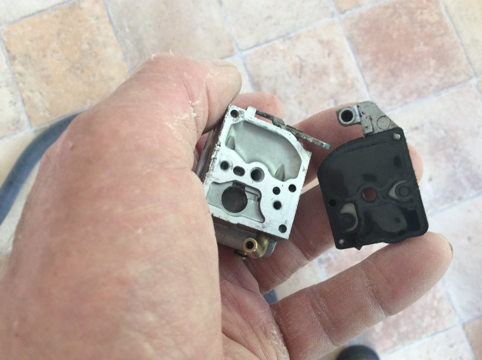

The first picture shown here is correct, now add the gasket.
The other photo is of the pump diaphragm and that fits direct to the carburettor body so those U shaped flaps cover corresponding drillings in the carb.
John :)
First picture is correct, can you post picture of the pump side of the carb where the brown gasket fits
