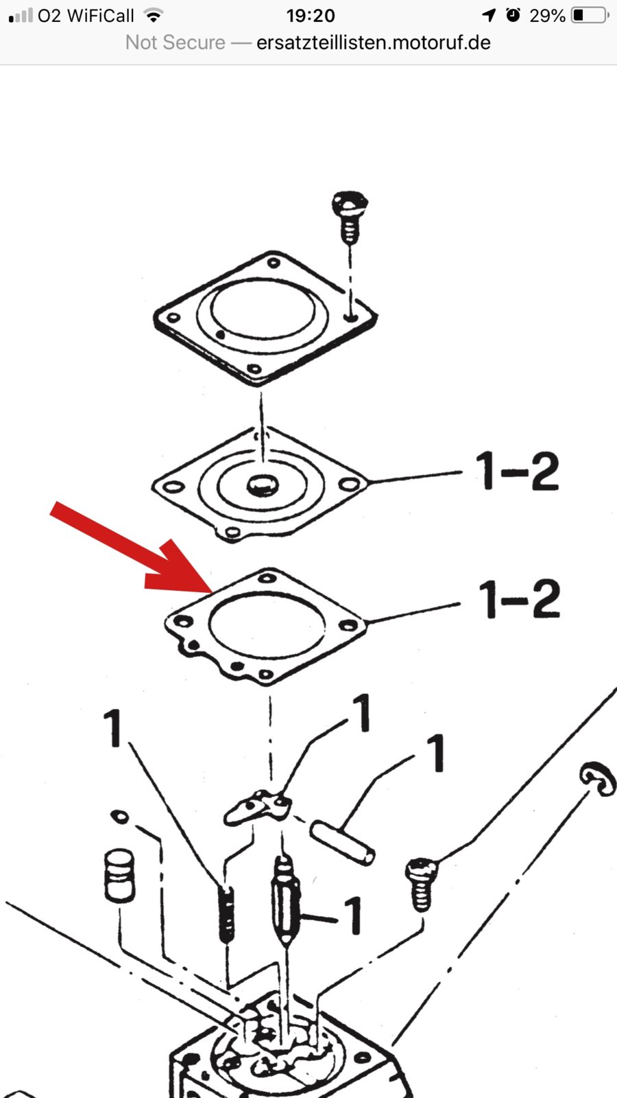

I have found a pdf for this walbro wf441 carb and it doesnt show this brown gasket.
What it shows is a thin gasket with a large hole in the middle so basically acting like a spacer.
So because of this i left off the brown gasket & put the carb back on.
The trimmer would not prime up & no fuel in the see through plastic/rubber primer bulb.
I then swapped the pipes around and i could feel a different response straight away & could see the fuel then coming into the primer etc.
Having said that it started & run for say 3 seconds after the third pull but the next 6 7 8 pulls nothing.
The H L screws are 1 full turn out
That carb is different and so it that gasket on that sheet.
I found a pdf file for WALBRO WF 441 But all looks correct apart from this item in question.
What they show is the same shape as the cover with a large hole in it. Image the screws were to long and you need a spacer then this is what you would use to loose the excess gap.
Anyway what they list on the odd sheet is also different to what is fitted.
Either way I don’t know if it’s previous history so maybe somebody just fitted it some years back and it shouldn’t even be there ?

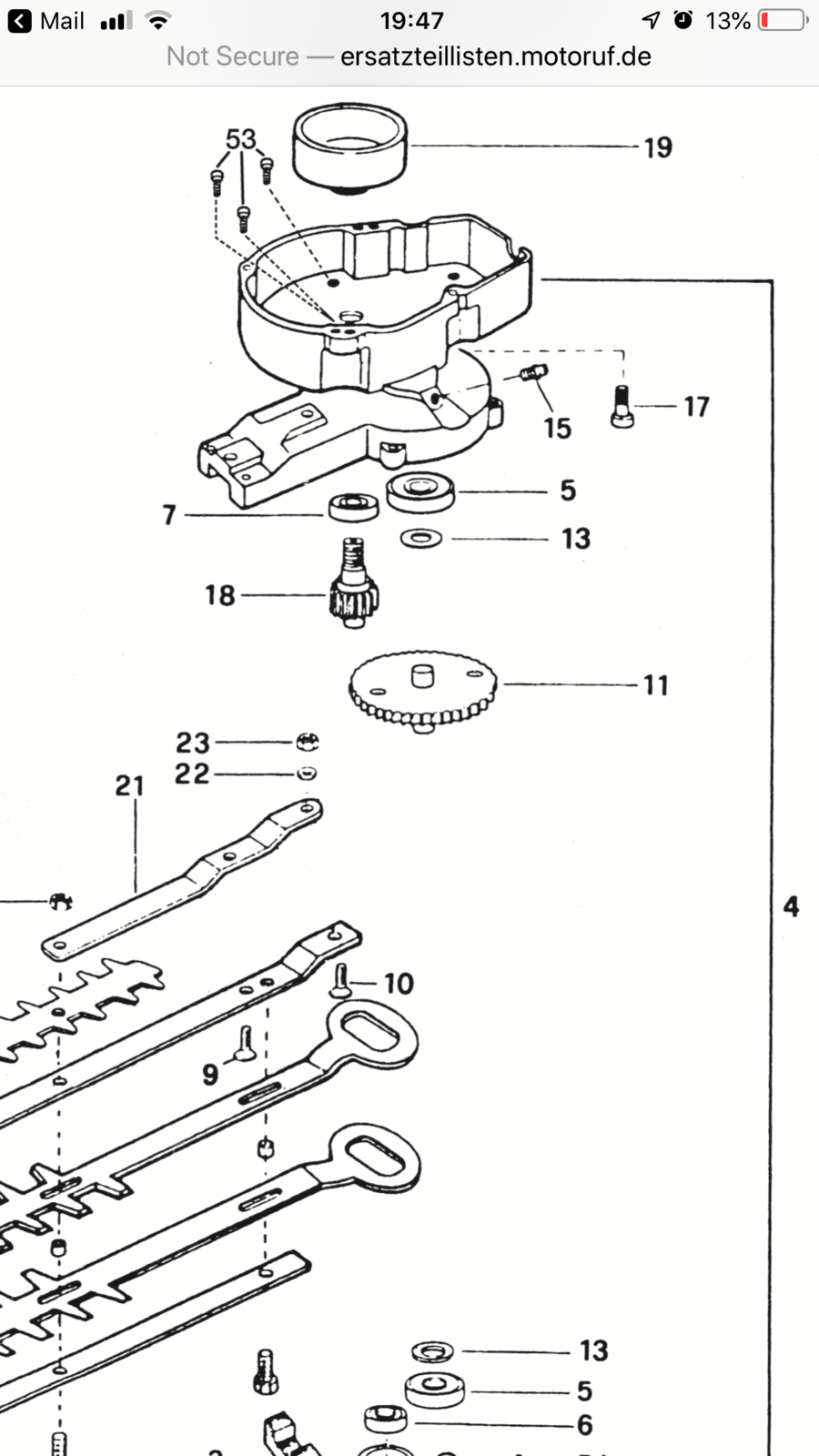

I think I’ve done as much as you can with the fuel side of things so what about ignition.
Changed the plug with a known working plug until the new one arrives in the post.
Still no joy.
I’ve seen videos on checking the coil with a multimeter but that’s providing you have the coil off.
I quickly did the following hoping to get the the coil but had to stop.
Removed grab handle.
Removed throttle handle.
With the unit then side down removed all the screws that hold the bottom plate on.
With this removed there is plenty of grease on the rotary workings for the blades.
At this point I stopped as I wasn’t sure without advice how to continue.
I assume I need to remove the blades and there must be some kind of connection from bottom of engine to this part where I am as I still couldn’t get the next section off to expose the coil & the magneto, is that what you call it. Part that coil generates spark with.
Maybe you could advise them tomorrow I can check with multimeter the coil is clean up connections etc.
Thanks.
That’s a 447 carb where mine is a 441.
Anyway see photo below which the 441 & 447 look the same but mine is different.
So like I say I left it off.
Thanks.
Thats the metering side not the side of the carb that the brown pump gasket fits
I posted to show where the coil is located not for the carb
Ah ok.
I know where it is but as the engine is upside down so to speak I need to navigate this part first.

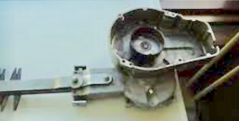

Afternoon.
Im looking to take the lower section off from the engine so i can gain access to the coil so it can be checked.
Last night i found a photo of which is attached of the item in question,please check it out.
Ive now got all the bolts removed but it will not separate so please advise how or why its still connected.
Once off i can check coil & clean up contacts etc as i need this running by Saturday.
Many thanks.
Bamber G.
When i pull the start cord the blades do move against each other.
This should not happen until the engine runs above certain revs so if you cant split the sections the clutch could be stuck inside the drum but not too sure without it being in front of me.
