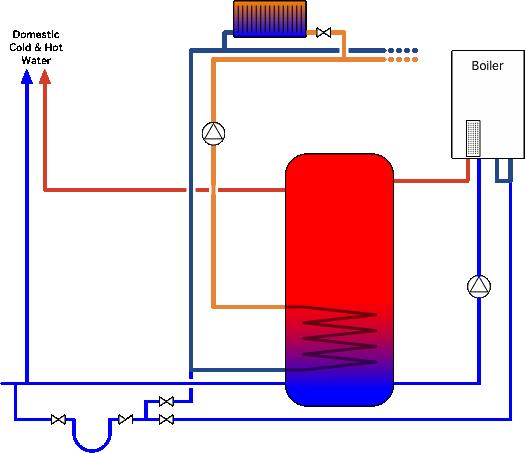

This only all applies to using the stored water as potable water. Using the stored water a heat transfer fluid, a normal boiler is the cheapest way.
a) Use a combi to heat the cylinder
b) Use only the hot water section to heat the cylinder
c) Use the coil for the CH
I think this is something like you had in mind. I've omitted expansion vessels etc, but included the fill loop (which could be done in several ways). The cylinder stat would need to be below the level of the top of the coil to ensure the cylinder is always recharged to low enough to heat the coil.
That is it. An off-the-shelf unvented cylinder would do it. The cyl stat is usually below the top of the coil which will be used for CH only. A pipe stat on the return to the combi would help and render the cyl stat position not too critical, as when this is 58C or so, the cylinder is up to temperature all the way down maximizing the energy storage.
Some combi's limit the hot water to 60C, others via the software can be cranked a bit higher.
Come to think of it, just having a pipe stat on the return to the combi right near the cylinder would be OK. A switch could be used to switch between the cylinder stat and pipe stat. A summer/winter switch, or an eco switch. The pipe stat also prevents over heated water entering the combi - the immersion could have been used.
As the cylinder is heated top down, that is a line of 60C heat moves down the cylinder, when the line of 60C water hits the cylinder stat the boiler cuts out will ensuring that the bottom third stays cool, not heating the full cylinder. The Winter mode will ensure the full cylinder is heated.
The pipe stat is best to have a pocket with stem stat that protrudes into the cylinder tapping. That means a tee at the point of the tapping.
That is simple. You could have the two stats operating as anti-cycle stats when in winter mode. Quite simple to do.
Look at the diagram. If DHw is being draw off, say for a a few showers, when the cylinder stat call the boiler the boiler will be pumping 60C heat into the top of the cylinder which most will be extracted by the showers. The boiler and stored energy combine to, in effect, extend the size of the cylinder.
