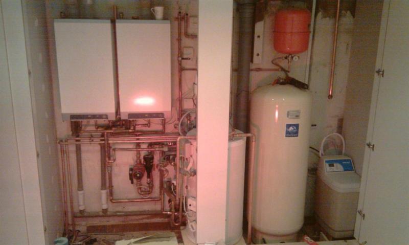

We have fitted several of those DPS (now Specflue) units and their performance is excellent. The idea is to have a large output system boiler to drive the plate as hard as possible.
Mikrofill only do huge units mind you.
Here are the last two DPS ones we fitted. Rather embarrassingly, the first one was one of the last ones DPS made before going under, and there were several components incorrectly fitted. Made for a rather noisy reheat :LOL:
Indus. The second photo there is a VERY similar base requirement to yours - albeit peak demand was far higher than normal loads - which is another advantage of the system - you are heating a fraction of the water.

They will not. Just uprate the cylinder and plate size and DHW delivery is improved to whatever you like.
Anyone specified a heat web/DPS unit lately,I did the other week it was nearly £6k,would have cost no more than £2.5k previously,spec flue have put prices up beyond belief.
The units aren't that good to justify those prices,which is a shame as I've fitted loads.
View media item 19282
That does 6 bathrooms with 2 baths and 5 mira discovery showers quite easily.
Only reason I went for it was for solid fuel input otherwise 2X HD70i would have given the same if not better flow/temperature range,and based on today's DPS prices would have been 2-3K cheaper.
What size is the cylinder doing 6 bathrooms?
Is it plate dhw delivery?
Edit. Think I see it on the left hand side. Nice job.
Yes it's plate heat,but like I said chosen because of the 40Kw solid fuel burner.
