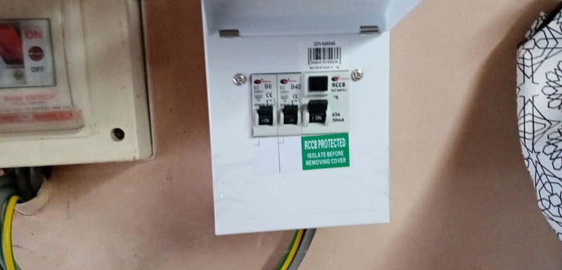

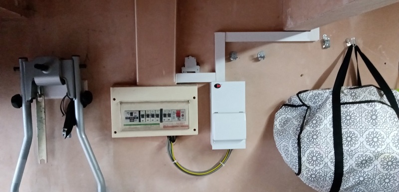

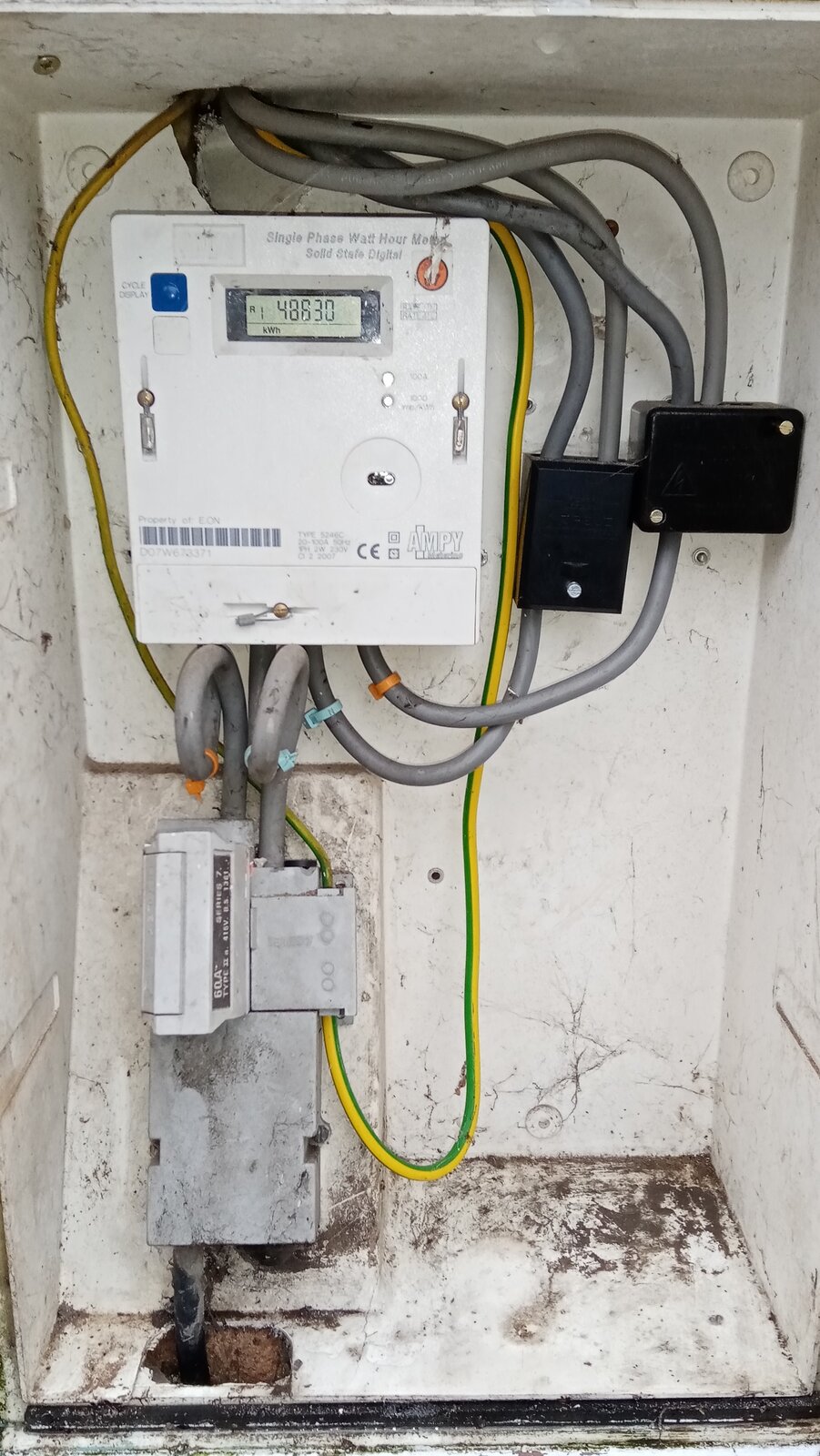

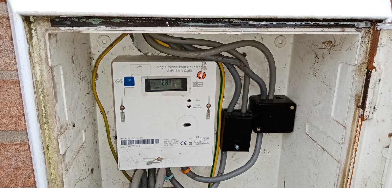

They could be, but that wouldn't make anything live on a lighting circuit if, as we've been told the secondary CU only feeds a shower (which sounds pretty credible).I think that additional CU needs checking, tails stuffed in the live side of the other CU main switch maybe?
I thought of that, but more-or-less dismissed the possibility because of ...Bathroom refurb. Shower and lighting wired into a separate 2 way board to provide RCD protection.

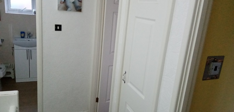

It might not even have been a lighting circuit, but I decided that it was very unlikely that it would be fed from a circuit created during a bathroom refurb.I then went to change a standard light switch in an upstairs bedroom. .... I brushed the tip of one of the red wires with my hand and got an electric shock.
just as predicted by many on here.Just looking back at the queries, there are no fluorescent fittings in the bedroom.

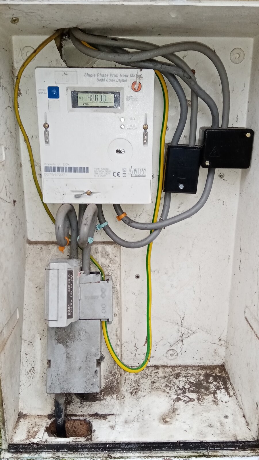

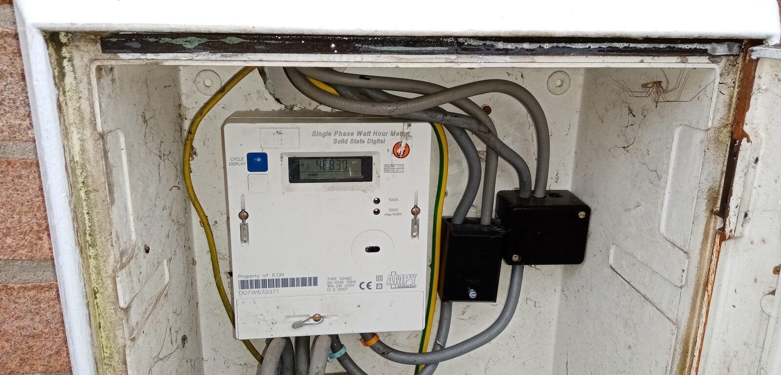

Here's the meter. It's immediately behind the CU on the exterior wall (the CU being on the inside of the garage wall).
View attachment 215547 View attachment 215548
To get around the need for bonding in the bathroom the shower guy has moved the upstairs lights to the RCD protected circuit in the 2 way, did it trip out when you had your shock?
