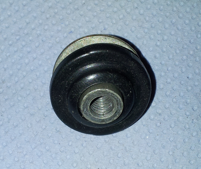

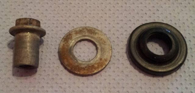

After analysing the leak some more, I believe I found the cause. The cover clamp bolt is designed to bottom out leaving a precise gap between the cover and the engine. If there is any shrinkage in the gasket, warpage on the cover or debris on the bolt, a leak then results. The entire mating surface of the previous china gasket was soaked in oil, suggesting the cover-engine gap being too large, a shrinkage happened, or gasket manufacturing slightly off. This appears to be a problem even with people using dealer gasket. The problem is most likely a design flaw, or a designed trap that insists on both the gasket and the cover being perfect in measurements. This is not appropriate for real world conditions.

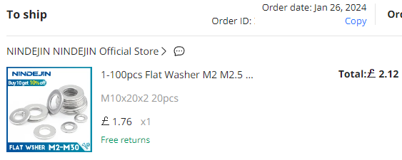

The solution is a thicker clamping washer to reduce the cover-engine gap. The OE washer is 1.47mm thick x 22.71mm OD x 10.04mm ID. The standard M10 washer sizes are 20mm OD or 25mm OD. These are available in 2mm thickness and in stainless steel. The OE washer is a tight fit. So, the 20mm will have to do. 15 washers are needed and can be bought from china for 3-4 £.
