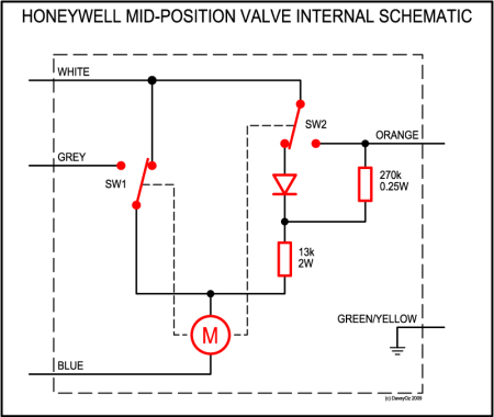

so by time an EICR is due what are the chances that the packaging still exists? Other than some thing like this mid-position-valve.jpg mid position valve where 13 kΩ plus resistance of motor means less than 17 mA DC is pulsed, most items will only cause DC if there is a fault, I did consider if the three port valve was reason for the warning use type A with Bosch boiler, however it seems likely over 6 mA pulsed DC so would need type B to be sure which you can't get as a single modular width RCBO so it would mean you could not use the valve in any home using RCBO's, and the three port motorised valve has been used well before we started fitting 30 mA RCD's which seems to point to there not being a real problem.

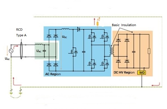

I did find this image:
From: http//www.kynixsemiconductor.com/News/57.html
Where type B use is discussed.
