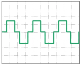

From reasonable early days I knew there were different types of RCD, however I thought the type A was designed to work with
a simulated sign wave, and was under the impression used in narrow boats and the like, and also the whole idea of the active RCD was so if there was a volt drop it would fail safe, a RCD used with a 55-0-55 volt supply may fail to work as the voltage is too low, and finding a RCD rated at 55 volt to earth was not easy.

From reasonable early days I knew there were different types of RCD, however I thought the type A was designed to work with View attachment 229579a simulated sign wave, and was under the impression used in narrow boats and the like, and also the whole idea of the active RCD was so if there was a volt drop it would fail safe, a RCD used with a 55-0-55 volt supply may fail to work as the voltage is too low, and finding a RCD rated at 55 volt to earth was not easy.
