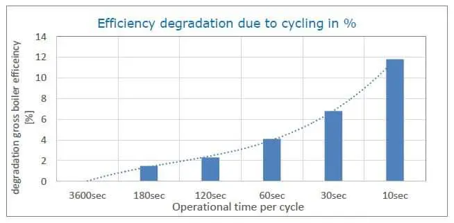

How short are the burn cycles?
With my current settings for the heating partial load, flow temp and three UFH zones active the burn times can be hours before it cycles.
With just my study UFH zone active with the same heating partial load and flow temps set it can cycle initially after 30mins, then every 10mins perhaps.
I think that's what you mean by burn cycles anyway. Let me know if I have misunderstood.
I meant how long does the boiler come on and burn for, before turning off. You seem to be saying, with just the study zone active, that once the boiler is up to temperature, it burns for ten minutes before cutting out? That sounds like a decent burn. Have you seen this graph from heatgeek?
Thanks yeah I have been over all the Heatgeek articles.
I will measure the burn times accurately tomorrow and see how long it actually burns before cycling. 10mins was a rough guess from what I have been able to observe so far going back and forth to the boiler between working at my desk.

A few sums will give a worst case but use your own numbers.
If you assume your minimum heating at 2kwh for say 8hrs/day for 365 days/annum then total reduced requirement is 5840kww/annum.
Gas consumption at 88% efficiency = 6636kwh
Gas consumption at 83% efficiency = 7036kwh (assumes a efficiency degradation of 5%)
Extra Gas consumption = 400kwh
Extra cost @ 10p/kwh = £40/annum
Some worry about wear & tear but a combi boiler cycles for up to dozens of times/day, every time a HW tap is opened, so?.
Vaillant's are one of the worst boilers in firing up on the first refire after a cycle due to remaining at ignition settings for 60secs before releasing the burner to modulation causing burner shutdown at SP+5C, especially if your running with very low flow temperatures.
