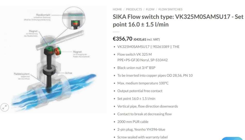

I'm following this post with some details of the Sika switch as requested.
We did look at the Sika before draining out the system - there was nothing untoward being loose. It is bolted to the plant room floor amid loads of other pipes, and there is no scope to alter that.
No we didn't look at any voltage the Samsung controller put down the switch line, but I'd be surprised if it were any more than a sub-12V DC logic or relay voltage. Putting down mains voltages would invoke extra safety considerations for routing that connection.
We did test the paddle-switching-open-to-closed-circuit when removed, and can say there was no no sign of anything loose, so have not attempted to dismantle the head connection as there was no indication of a fault there.
But:
As the fault has been totally eliminated by putting in the new motorised valve, I don't see how the Sika can be the source of the fault - unless there is some sort of exotic interaction between the two - but that still implies a feature of the motorised valve opening character that developed over time caused the issue.
Please post either a picture of the Sika switch, or a link to show the spec of your switch.
I only found a single Google find for the full spec of the label attached to our Sika switch: VK325M0SAMSU17
That result was here:
SIKA Flow switch type: VK325M0SAMSU17 - Set point 16.0 ± 1.5 l/min
This was the ONLY Sika switch website listing that not only displayed the set point, it was correct for our system.
Hopefully this won't tread on significant copyright toes:
That indicates it is a reed switch activated by a magnet on the far end of the visible paddle, as you indicate.
My "VK325M0SAMSU17" Google search only returned one other Sika switch, but only as far as the VK 325 M designation, and doesn't confirm the flow switch setting.
..., however reed switches are not immune from vibration so my suggestion, after the recommendations above, is to check the security of the output terminals, followed by pipe support in the area of the switch; the important part is to eliminate or significantly change the resonant frequency of the pipe at the connection point into the water system - a block of wood will do for now.
To repeat, it is bolted to the plant room floor amid loads of other pipes, and there is no scope to alter that.

Samsung say that current units use a more elaborate flow gauge which would eliminate such a paddle switch, so this "fault" has probably been addressed - so no intention at dissing Samsung ASHP units.
Any metod of determining if the flow through this switch is lower when on DHW duty?
Set point 16.0 ± 1.5 l/min​
I wonder if there is enough play in the drive mechanism, or spindle, to allow it to signal 'in open position', but with the actual valve not properly opened?
Is this a settable setpoint? can it be set as low as 14.5LPM & as high as 17.5LPM, and if so (or not) what is the alarm hysteresis?.
