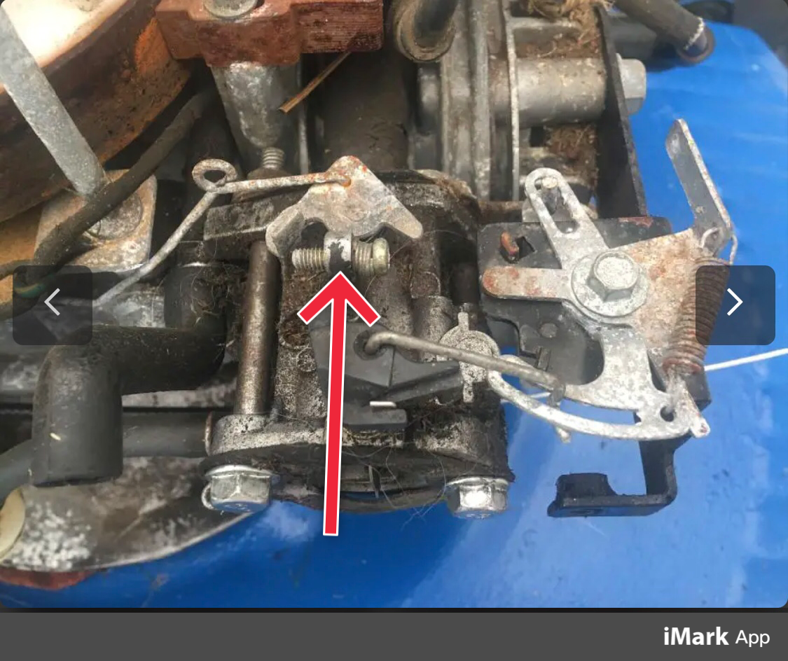

Pic 4 of the original shots......the tickover screw seems well turned in.
Does turning it anticlockwise reduce the excess speed?
John

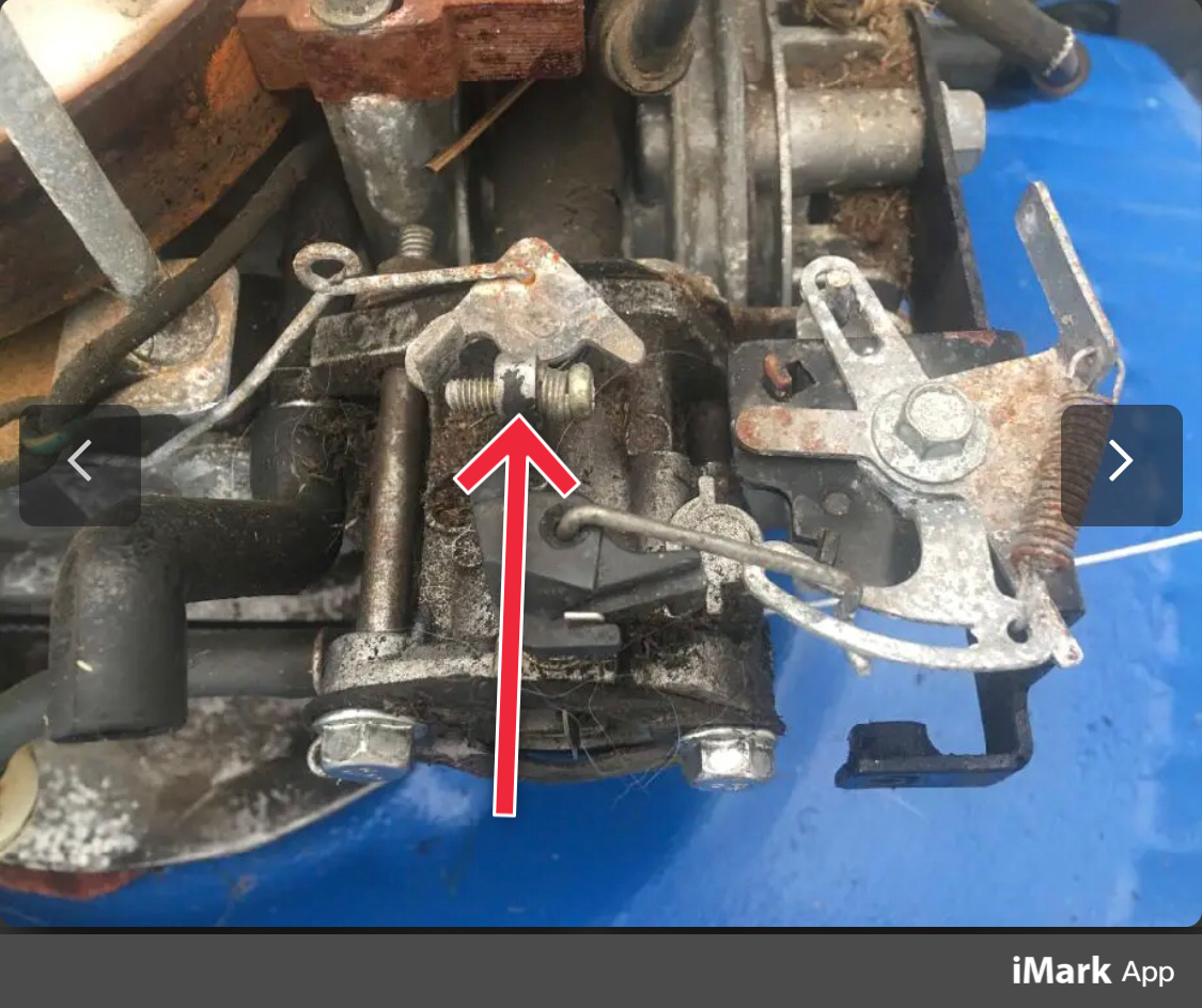

I assume you mean this one.
Job for tomorrow.
That screw will make no difference as the lever that touches it isnt even close when its running.
I bent back the lever of which the spring that was missing connectrs too.
It now runs a lot better thanks.
