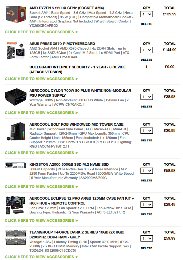

just had a look at his list and there doesnt appear to be a graphics card on there, nor PSU
Ian said he already has a 1660 graphics card (I presume GeForce GTX 1660), but yeah, no PSU.
my bad, i missed that.
Attached is what i found, all components are same or equal to (in some cases better,). in terms of speed and quality etc
I would also advise going for the X570 range of motherboards, these are AMD's fastest mother boards, and they are also the most future proofed, meaning that in the future all you / your boy has to do is upgrade components as it suits rather than a whole new PC.
the X570 motherboard should be good for at least 3-5 years which is a life time in electronic terms.

Might also want to add a wifi card, unless ethernet cable is going to be used.
Can't help thinking something else is missing too!?

I am no expert but consider buying the fastest kit I am prepared to spend on... Future proofing to some extent.
-0-
If he is gaming, forget the use of WIFI, go hard wired ethernet only.
I'd up the CPU the to a ryzen5 3600 (not the X) also look for an EVGA 500w psu.
The video card should cope and can always be upgraded should the need arise.
More RAM would be a benefit, also dont forget the cost of the OS.
If you can make the NVME?SSD 1TB it would be bale to store more games on and once you start using Steam then your library tends to get quite big, games are about 50gb+ a pop these days.

Thanks, your screen shot looks all good to me, which site was that from?

That screenshot was from box.com
The bundle looks good value, the processor is very good and the motherboard is good too, just make sure it's from a UK supplier.

My only thought is and i might be willing, but the G in 3400G means graphics, but as using a gpu, there might be a better cpu for same price? Not sure though.
I would buy intel suffix 'K' CPU (10% faster than non 'K' types out of the box - with overclock if required) also spec onboard graphics - backs up the use of graphics card, good aid to problem solving possible graphics card problems and keeps the mc useable in the event.
