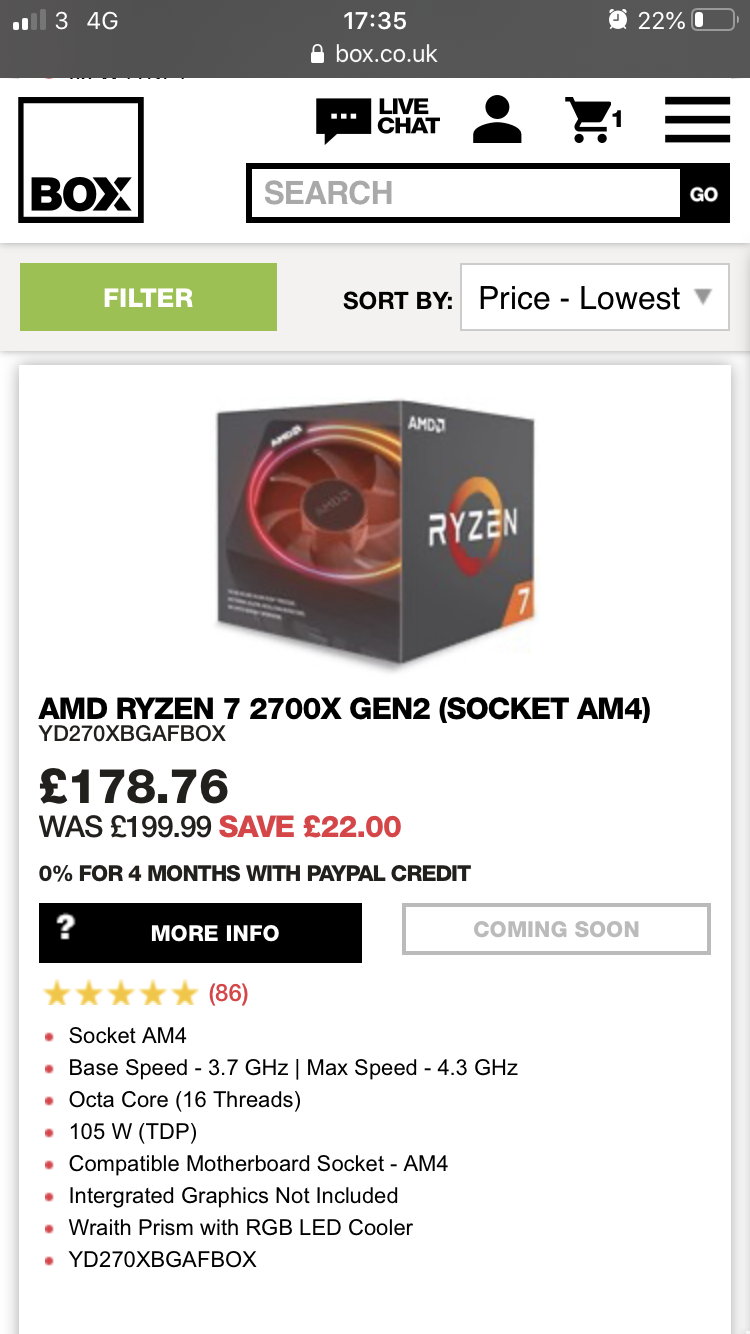

Which is better between these 2 processors?
I’m thinking the 5 because it’s a 3rd generation.
The 7 has 2 more cores, all depends on how fast it can access the memory I suppose.
It "should" be able to process 33% more code for a given time frame.
As said above though maybe best to ask your lad!.
fwiw I have the 5/3600 and it works well - not had any problems yet.
Everything I play runs on high settings :)
I'd go for the 5. It's very unusual to find applications that can use that many cores well, it's more common to have things that are limited by a single thread. The 5 is nearly as fast in all metrics but has a far smaller TDP. That means it'll be generating less heat and with the same cooler should be able to be cooled, keeping you in the boosted range for longer. Also it's a more recent generation and that typically means more processing power per GHz (Instructions Per Clock, or IPC).
Then again the 7 has a cooler with integrated LEDs, so you could go either way.

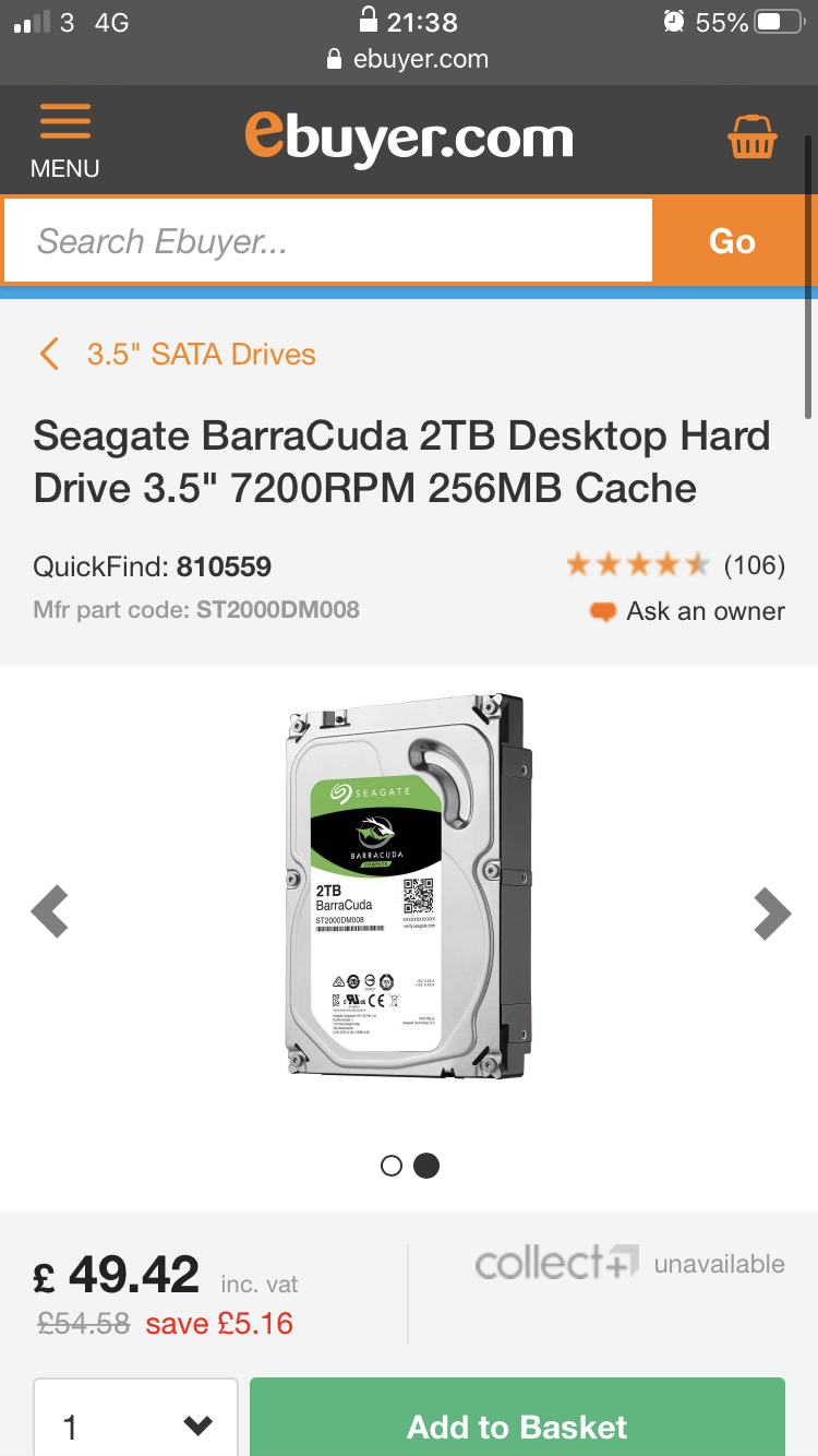

I think I’m missing a HDD hard drive, the case and operating system.
Can anyone recommend a good HDD? Ebuyer seem really good with price and delivery but not sure exactly what I’m looking for. If I swapped his hard drive accross to the new machine would it then work with the operating system already insts
