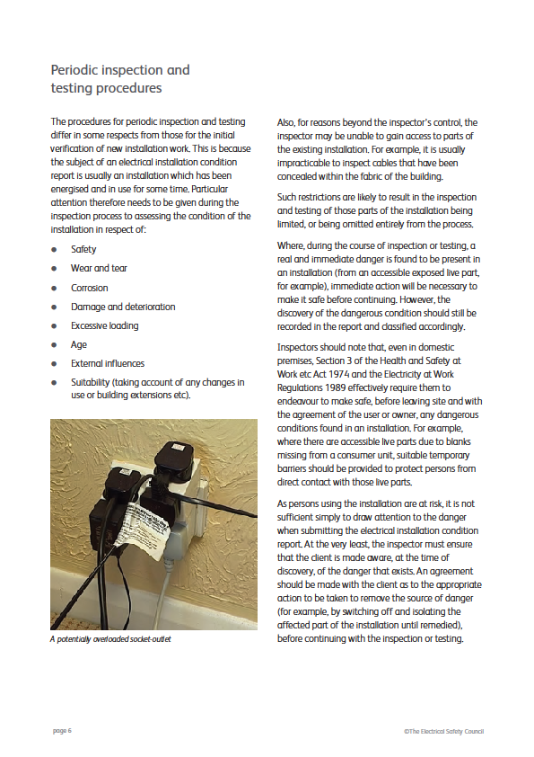

I have read PIR's and EICR's and gone to look at what is involved to correct the points raised. I have many times scratched my head wondering what the tester has seen as a fault and been unable to find it. The reference is so vague. Looking at the guides they list things which to me has nothing to do with fixed wiring. The multi adaptor into multi adaptor may cause a strain in the socket, and is of course as a result something which should be pointed out. However it is nothing to do with the fabric of the building and when some one returns to fix it, it may no longer exist, the same as extension leads under doors.

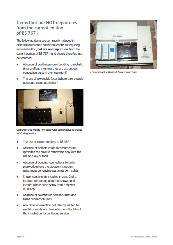

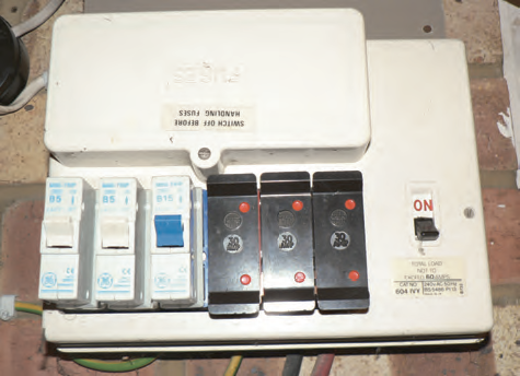

The old previous edition has become the new C3 but it shows
as an example of not being departures and other than being plastic it would conform today, I still use a pair of fuse boards like that in my house, both supplied from separate RCD's so yes until Jan this year it would have complied, where it would get a problem is 533.1.1.2 and 560.7.5 refer as with many other regulations to skilled persons, having a adaptable box with built in DIN rail holding two RCD's is OK for me as I am skilled, so is every male in the family, however if I was to rent my house then maybe that box would not comply? I see this as a problem when doing an EICR as the person in control does matter.
I've always been under the impression that rewireable fuses weren't permitted in rented properties as the risk of the tenant replacing the wire with something unsuitable is unacceptably high. It is certainly something I used to experience quite a lot when I started, and Wylex standard boards were all over the place. It's far less of a problem now with MCBs in the majority of homes.
Perhaps I'm wrong. IIRC I read it in a booklet provided by the NICEIC as information about electrical safety for landlords.
Sensible though that sounds, if it were true, what rules/regulations/laws would it be that "did not permit" that in rented properties?
Kind Regards, John
533.1.1.2
Fuses having fuse links likely to be removed or replaced by an ordinary person shall be of a type which complies with BS88-3, BS3036 or BS1362...
So it appears there is no regulation saying rewireable fuses shouldn't be used.
