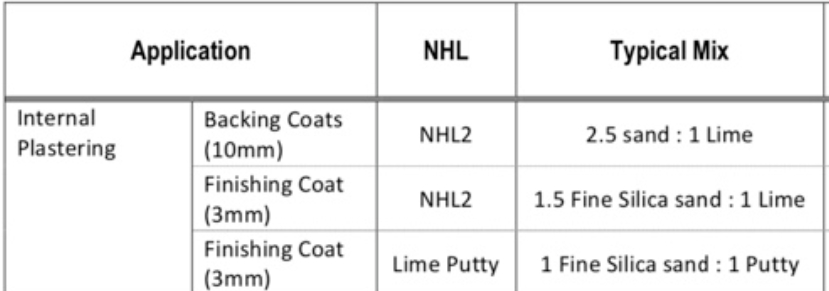

If you go plasterboard then use damp resisting adhesive but dont go mixing anything with it - best for me is to not use plasterboard but, after removing all trim and skirting, hack off to bricks from floor to ? and render with a sand and NH lime render.
Thats the go to solution in damp work nowadays so dont ever use any gypsum plaster for dampwork.
Leave the bricks for a drying out period if possible and then go on to clean brickwork with the sand and lime only render
