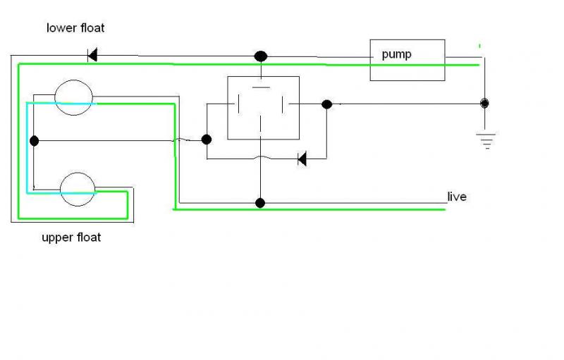

And the diagram has not worked and you can see why look!
I could even hear the switch burning out
Always wondered what that noise was in the past, thought it was the pump not getting enough power now I know it was the switches fizzling out

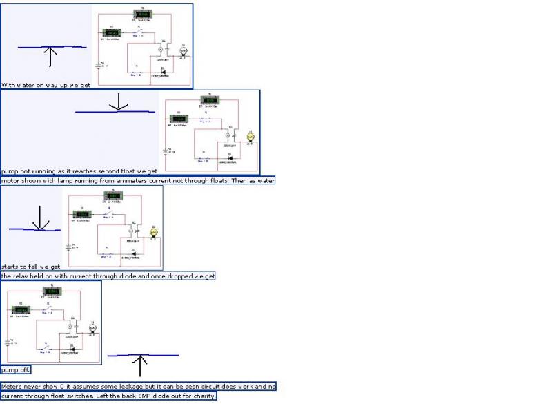

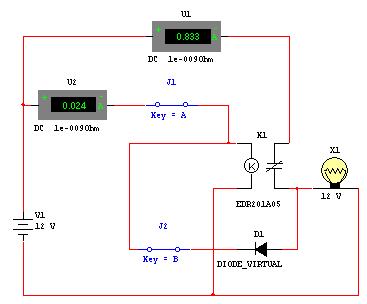

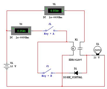

I have looked at wiring diagram and if "Live" is "Pos" then the current should not flow through diode. However is either AC or "Live" is negative then current will flow. In which case the diode across the coil is also wrong.
If DC and wrong polarity just turn diodes around if AC then swap relay to one with two sets of contacts.
For interest only as I think overkill in your case. A PLC is a programmable logic control they were called PC until IBM registered it as a trade name.
They have a number of inputs and outputs plus a load of timers that can inter react with the inputs and outputs so for example if it takes 30 secs to activate float it could be programmed to reduce delay and if under 20 secs to increase delay so one can get it to do all sorts of complex functions.
But at around £100 for cheapest not really what you need. I will try to redo your circuit in multi-sim and show different functions.
With water on way up we get
pump not running as it reaches second float we get
motor shown with lamp running from ammeters current not through floats. Then as water starts to fall we get
the relay held on with current through diode and once dropped we get
pump off.
Meters never show 0 it assumes some leakage but it can be seen circuit does work and no current through float switches. Left the back EMF diode out for charity.

No, the current cannot flow in the direction you have indicated on the diagram as the diode prevents this.
If you missed the diode out of the wiring then yes, you could overload the switch. As I have said on a number of occasions now, you need to fit the diodes. As you look at a diode the white line corresponds with the line across the diode on the diagram.
Or as Ban-all-sheds is heading for, double poled devices will work too.

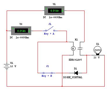

I would think all that is wrong with old one is diode has gone short circuit!
K is the coil of relay and U1 and U2 are ammeters to show you very little current through floats.
They are the labels the program auto uses. It allows a simulation so I can check there are no mistakes before I build.
To see details of relay click here To ensure the latch and pump are never connected the correct way around in important.
But I still think new diode would be a lot easier!
Will that one not just work on the upper float switch though?
Both the 87s are common to each other so is just like connecting the upper float switch to the supply rail.
