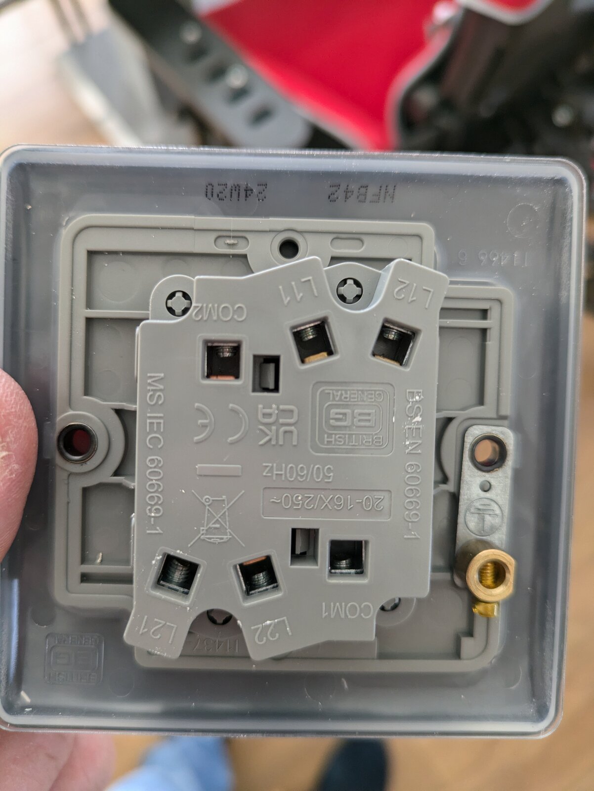

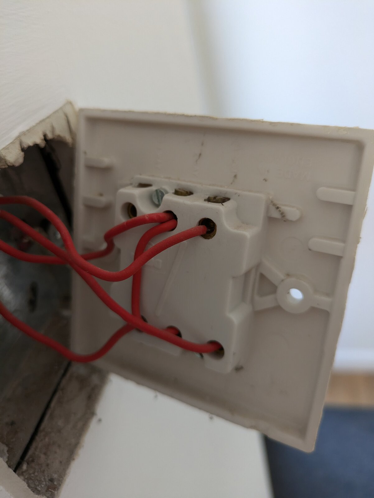

Hi i was wondering if anybody can help Im baffled when wiring a new light switch in my hall, Ive changed the 1st light switch in pic with no probs but its the 2way at the other end of the hall see pic of old white switch wiring, which i cant seem to get the wiring right as this also witches the outside light on/off, my new 2 gang 2way has the new L11 L12,L21,L22, com1, com2
Any help would be appreciated

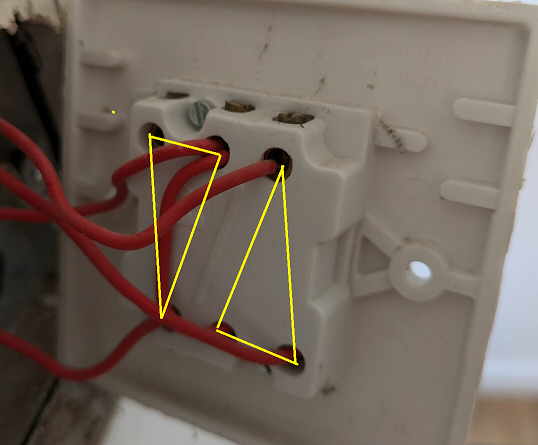

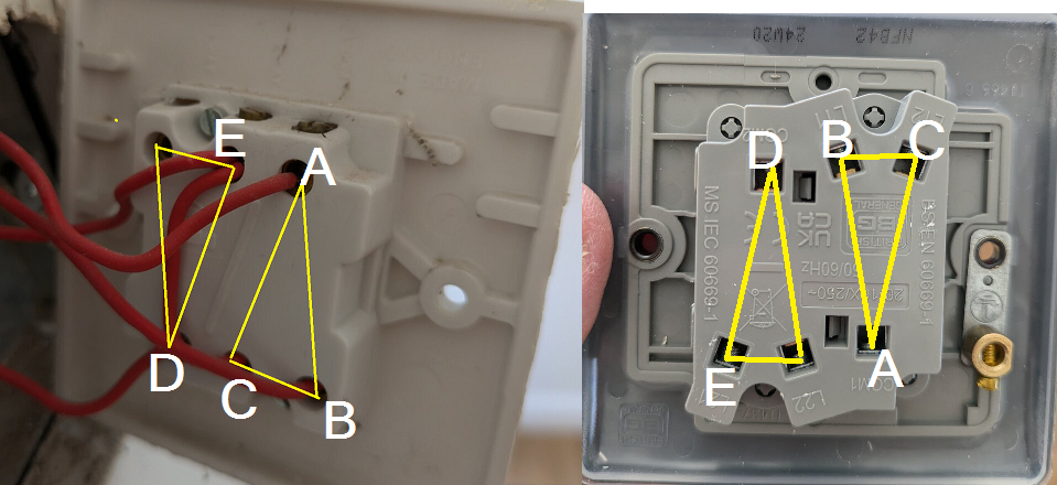

The switches are both two triangles but the new switch has left and right the other way round.
Mark the wires before disconnecting and just transfer the wires
Is the white switch how it was originally wired? Looks like a link across the switch.
Yes, i took this photo before i did anything, so how do i wire it so i can use hall light and the outside light, please

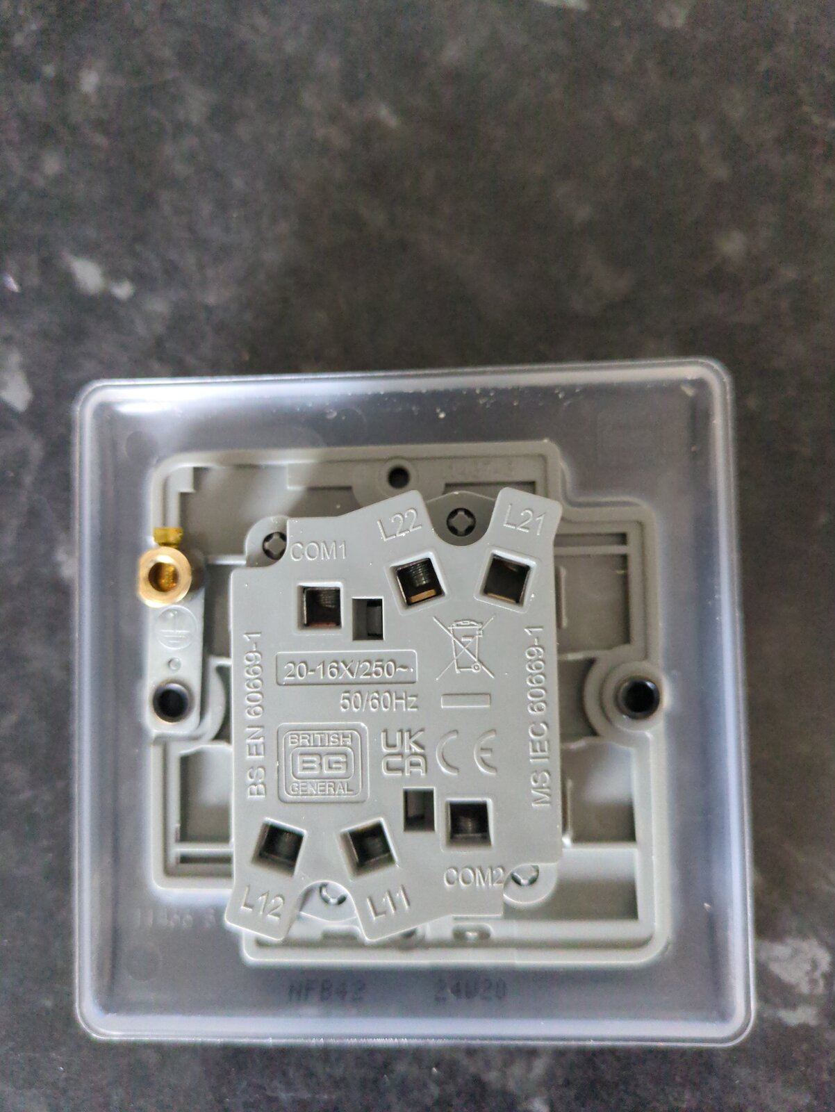

The two photos would make more sense if the new one wasn't pictured UPSIDE DOWN.
Sorry never thought
