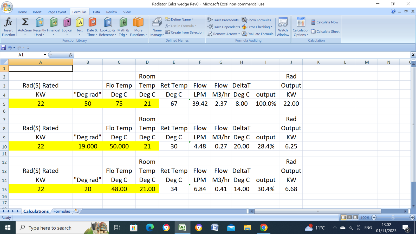

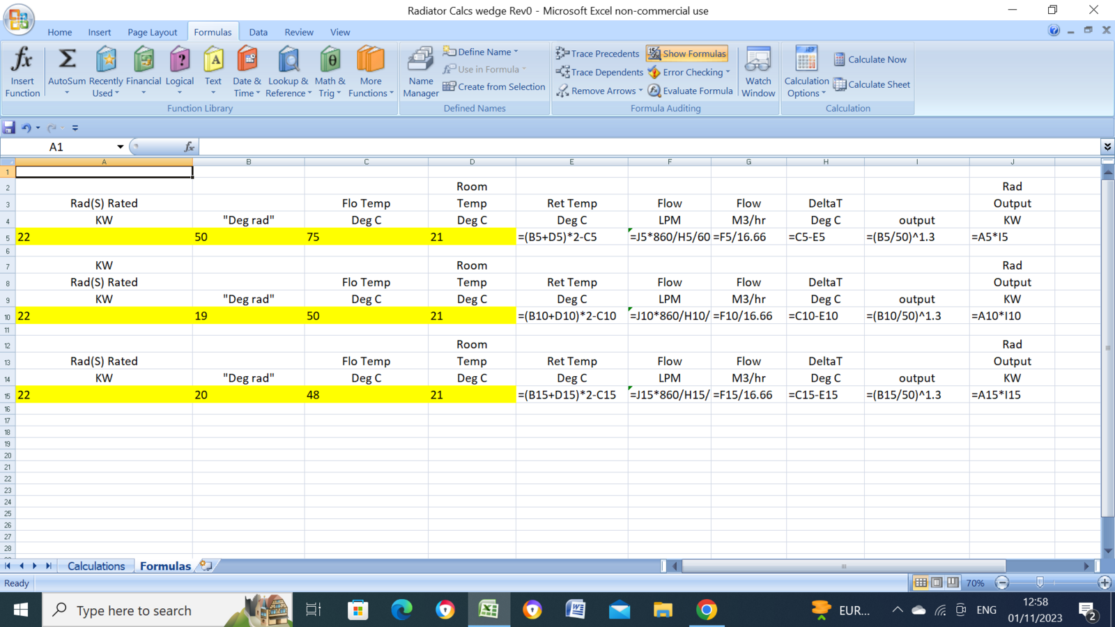

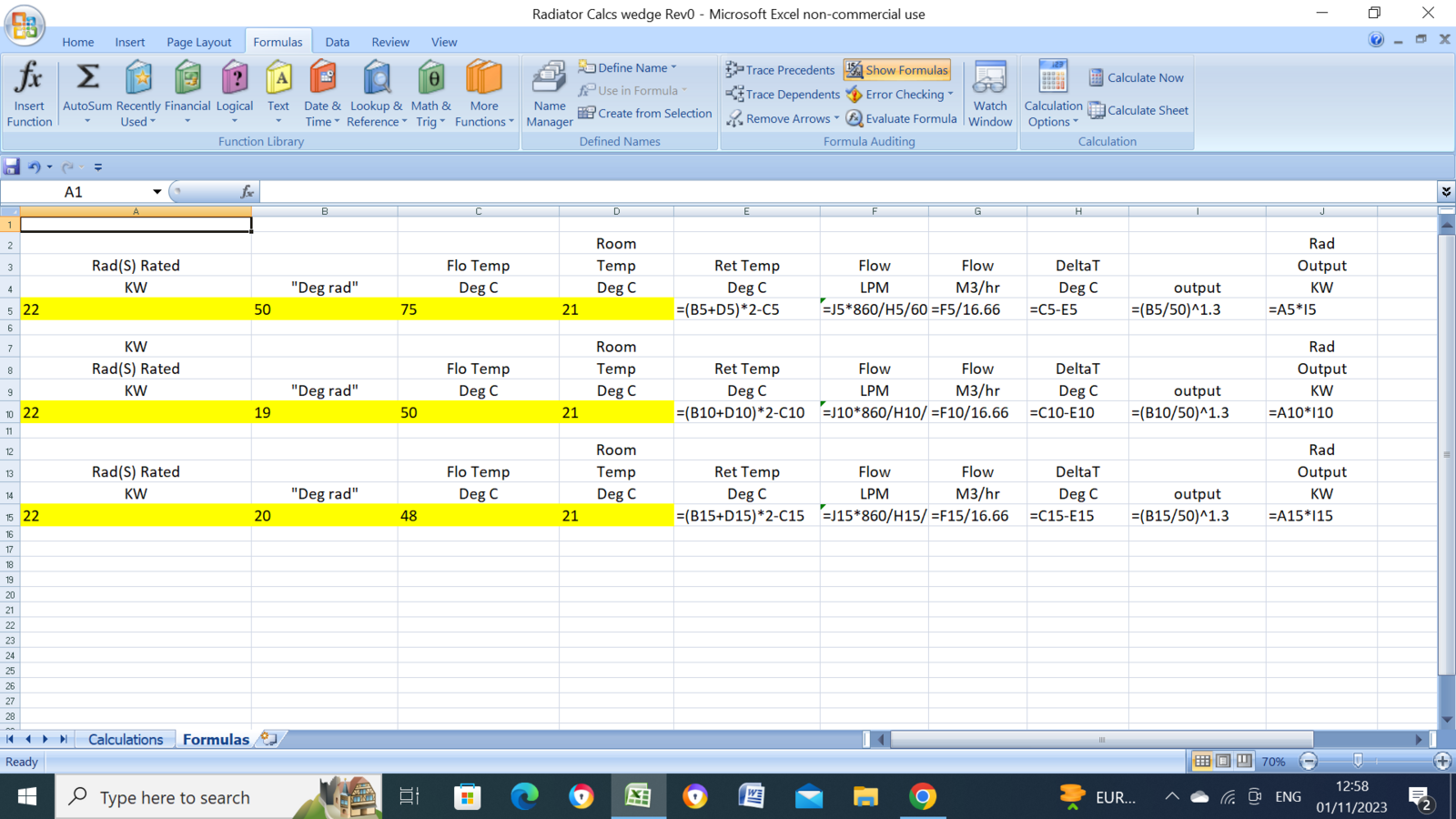

Cant post the actual spreadsheet but you can see the formulas (calcs) I used, you only have to put them in for the first rows and then just copy and paste to create as many rows as you like, these reflect your numbers but you can play around with them, have fun.
Only change the values in the yellow cells.

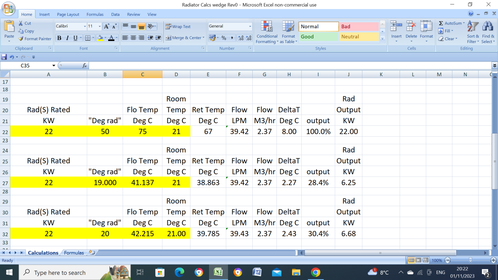

So this is an accurate reflection of the current setup, i'm trying to get that extra 4 degrees out of the DT
One thing not on the sheet that i need to know is the pump speed for the CH (c) and Modulating Pump (c.)
I guess i can add an extra couple of columns in and play with the formulas unless you know?
thanks!

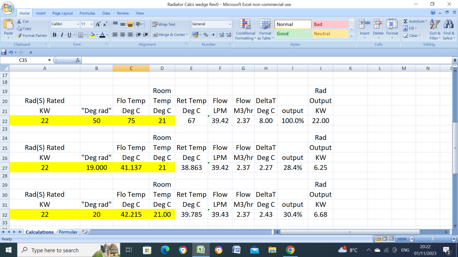

Sorry also assuming that Deg Rad is the radiator temperature
No, the deg rad is the T rating to give you the required output, a 50 deg rad is a T50 etc to give you 100% output, the 20 deg is now a T20 because of the reduced flow/return temperatures and gives 30.4% of the output if it was running in T50 conditions.
The required flowrates are shown above so you will have to adjust the pump speed to give you that bearing in mind that a higher pump speed may be required on boiler start up to prevent tripping on overtemp before the boiler modulates down from its ignition conditions.
I will post another set of readings later showing the nearest outputs as above but with the same flowrate as that required for T50 (100%) conditions. Some boilers now like Vaillant will automatically control the pump speed to maintain a settable dT of, I think, between 10C and 20C, others, will change the pump speed between 100% at full boiler output and something like 70% at minimum boiler output.

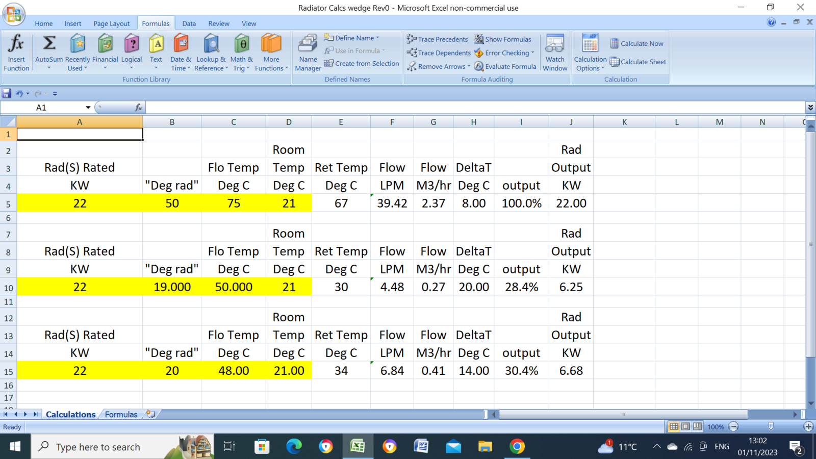

Just to clarify the T50, T20 etc
The "50" or the "20" etc is always the mean rad temperature minus the required room temperature.
So the T50 is (75+67)/2 minus 21 = 50
and the T20 is (48+34)/2 minus 21 = 20

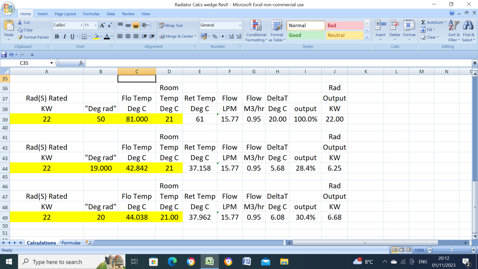

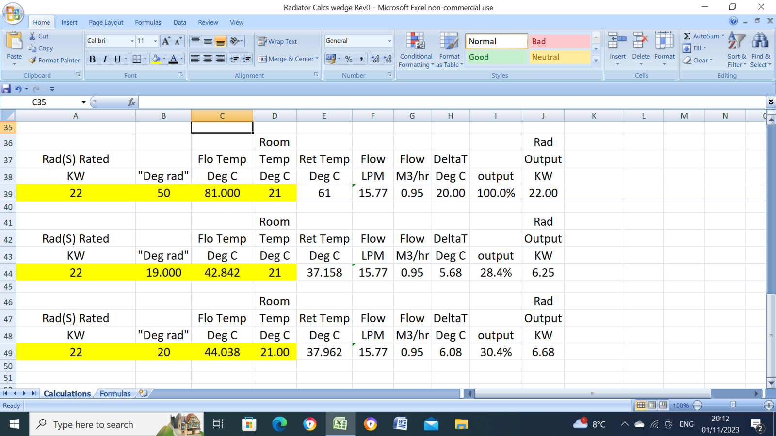

Below shows the data if the flowrate was kept at the T50 rate of 39.42 LPM BUT in practice you would need a enormous pump head to drive this through the boiler heat exchanger, the pressure loss through most boilers is based on a dT of 20C to give a reasonaby low pressure loss through the heat exchanger, a 22kw boiler should be limited to a max flowrate of 15.767LPM, (22*860/60/20).
The second set of data, below, gives the realistic numbers and even though the dT is very low with the T19 & T20 outputs, the return temp at 37C/38C still gives excellent condensing with very high boiler efficiencies.
Thanks very much i think this makes sense to me now
The boiler should do 24kw, so 17.2LPM and that should mean that i can run down to 44 on the flow temp, return of 38 - 17.15LPM.. but i think from a "beat the crap out of the pump" perspective, it would be better at 45 degrees with T20 and flow LPM of 12.86
Amazing that 1 degree difference does to the flow..
Let me know what you think of that, i'll have to play with he settings
thanks very much for the help much appreciated :D
Yes that calculation above is correct, I think the 12.86LPM is a good choice as well.
