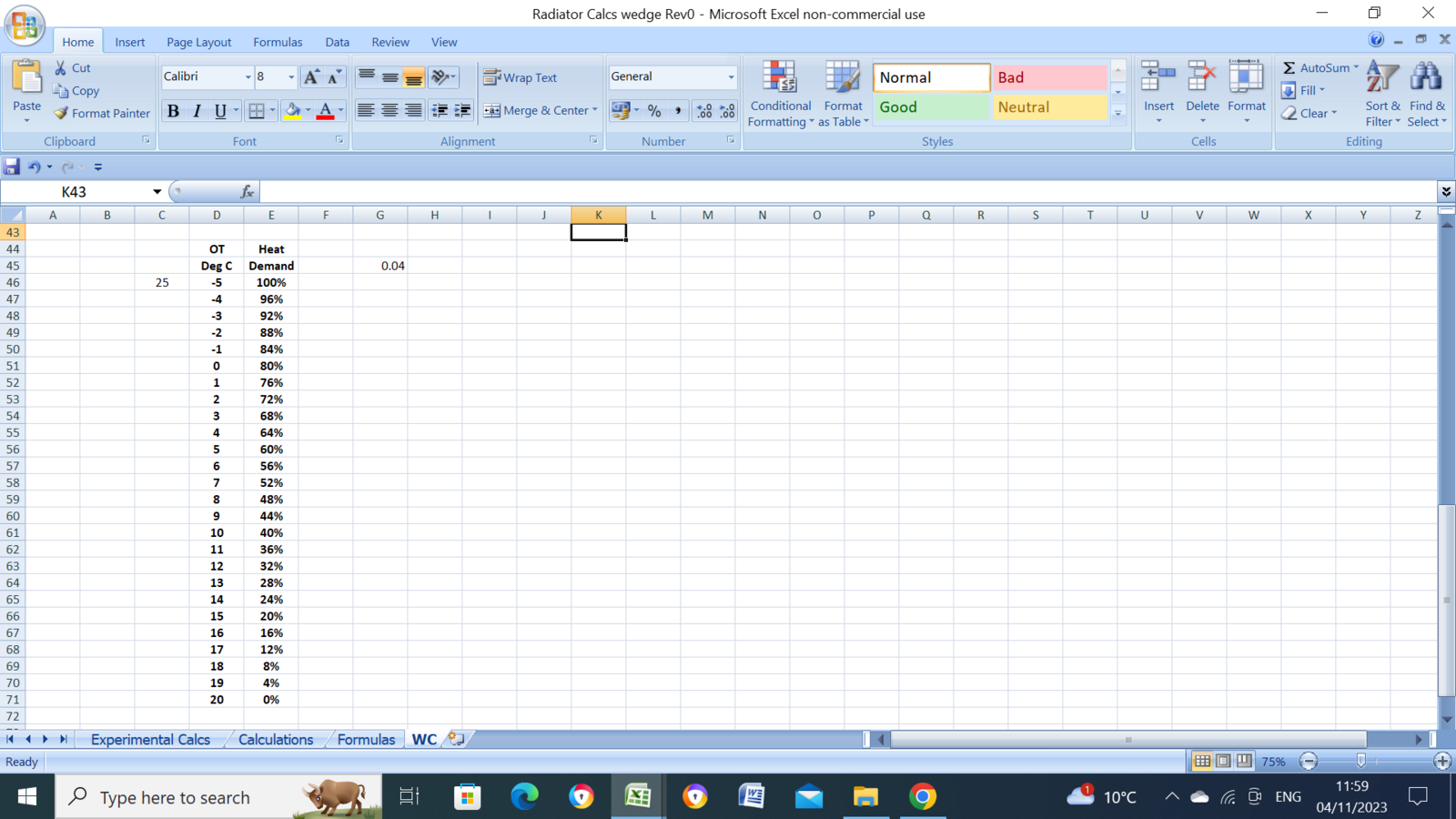

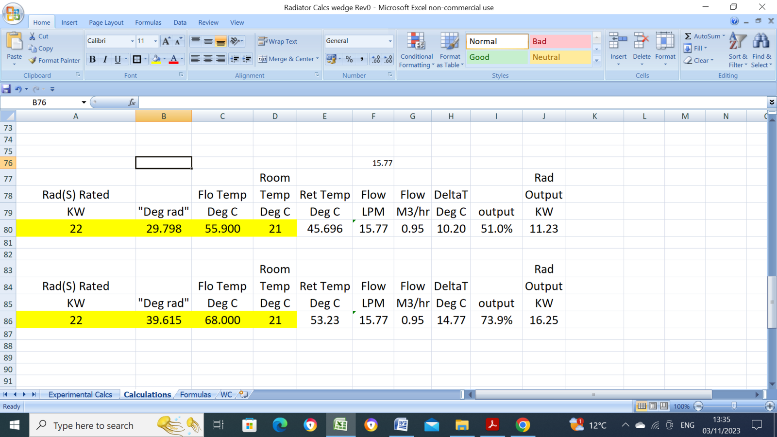

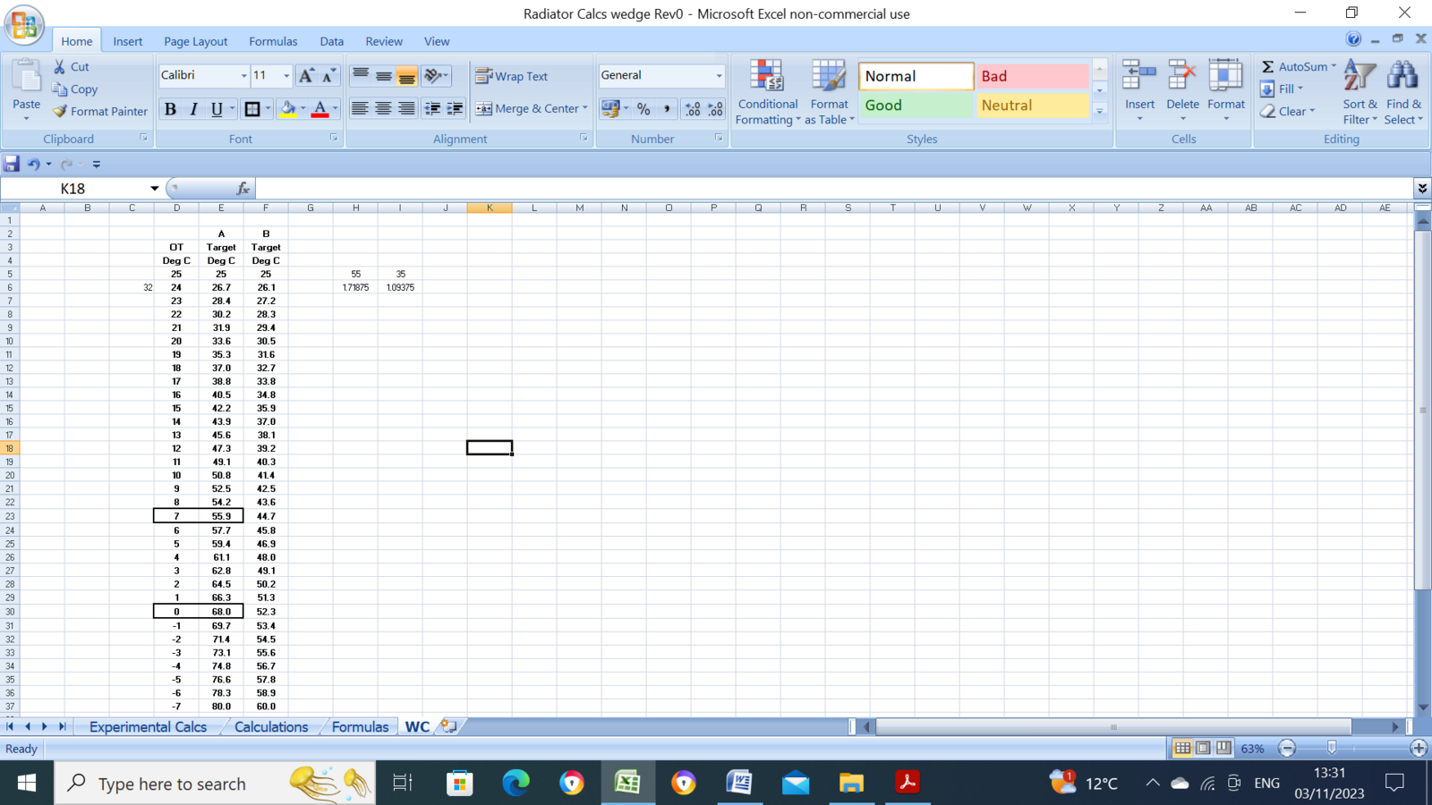

Just did a few numbers there using the factory set WC where a OT of -7C to 25C = Boiler Target temp of 80C to 25C.
Assuming your rads are T50 sized to 22kw then you will still get 16.25kw at a OT of 0C and 11.23kw at a OT of 7C (fairly typical OT temp around here) assuming the room temperature of 21C is achieved.
It states you can change the WC parameters in 10.3 but I read somewhere else that this is only possible on some Intergas models.
Edit: at -5C OT this curve will give 20kw at a target temp of 76.6C, might be enough??.

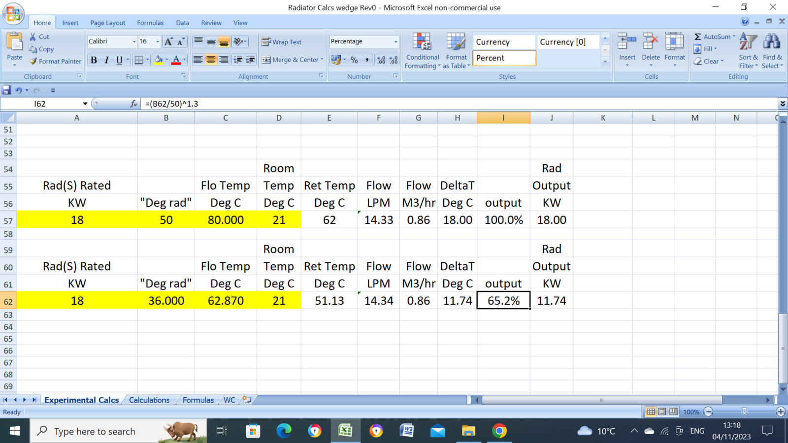

No problem, forget about T50 or T30 for the moment, you do/did a calculation on the heat required to heat your house from -5C OT, you came up with ~ 22kw, you could supply that heat with all electric heating or UFH or, in your case rads, it doesn,t matter because 22kw must be supplied. All rad manufacturers now use this T50 standard when sizing their rads and the rads you have installed have been based on this because the sum of their outputs is ~ 22kw, if you now decide to run the rads at reduced temperatures to become T30 rads then they will only output 51.48% of what they would at T50 conditions, 22X51.48%, 11.33kw. You have just converted the T50 outputs to T30s which is mathematically correct but doessn't change in any way the heating requirements, you will be able to heat the house to 21C if running with T30s once the OT rises but you don't have to rigidly stick to the T30, you just increase/decrease the boiler flowtemp to suit the conditions, this is what WC is doing in effect, its changing the boiler flow temo so the rad outputs as a T50 or T45 or Twhatever to give you your required room temperature.
So theoretically you are saying at 5degC the boiler flow shold be 59.4 as per the Excel table of OT above to heat the house effectively, correct?
I did something similar but I agree with John that boiler flow needs to be adjusted as per outside Temperature. I keep mixing OT open therm with outside temperature. Outdoor reset is a US term for WC.
PM sent to John
Read your PM so I'll answer it here.
re table, above, yes, thats what the Intergas chart shows, there is a linear relationship between heat loss and heat demand (I'm a bit skeptical about this but this is what the gurus tell us). the heat loss may be designed for a 20C room temperature for a minimum ot of -5C, a 25C dT and you size your (T50) rads for this, now suppose the OT rises to 7.5C, then the heat demand is 50% but a T25 rad will not provide this because rad output has this 1.3 exponent so a "T29.3 rad (say T30) is required and that's why WC use (or should use) curves, the intergas one looks linear.
Your heat demand is 18kw so based on a -5C to 20C basis, your query re ~ 63% output, 11.34kw, (a T36 rad) should, theoretically mean that the OT has risen to 4.5C.
Thanks John, Yes that's correct 11.34 is what I require based on my designed temperature is 5deg C outside temperature so my dT would be 15degC (assuming room temp of 20degC). or What flow temperature should I be running on in my scenario?
Don't know what the boiler output is but assuming 20kw then the flowrate to give a dT of 20C will be 14.33LPM, based on this then you will require a flowtemp of 63C.
