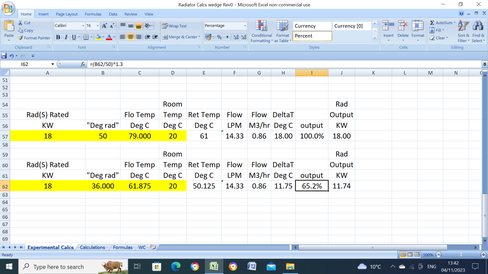

No problem, forget about T50 or T30 for the moment, you do/did a calculation on the heat required to heat your house from -5C OT, you came up with ~ 22kw, you could supply that heat with all electric heating or UFH or, in your case rads, it doesn,t matter because 22kw must be supplied. All rad manufacturers now use this T50 standard when sizing their rads and the rads you have installed have been based on this because the sum of their outputs is ~ 22kw, if you now decide to run the rads at reduced temperatures to become T30 rads then they will only output 51.48% of what they would at T50 conditions, 22X51.48%, 11.33kw. You have just converted the T50 outputs to T30s which is mathematically correct but doessn't change in any way the heating requirements, you will be able to heat the house to 21C if running with T30s once the OT rises but you don't have to rigidly stick to the T30, you just increase/decrease the boiler flowtemp to suit the conditions, this is what WC is doing in effect, its changing the boiler flow temo so the rad outputs as a T50 or T45 or Twhatever to give you your required room temperature.

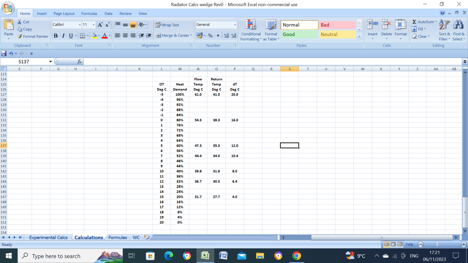

Here is a flavour of what you might expect from your system if your heat loss is fairly accurate, all the calcs are based on a fixed flowrate of 8.72LPM which IMO is the very lowest you can go to allow the boiler to fire up at ignition conditions. I have only done some numbers for fairly typical OTs.
