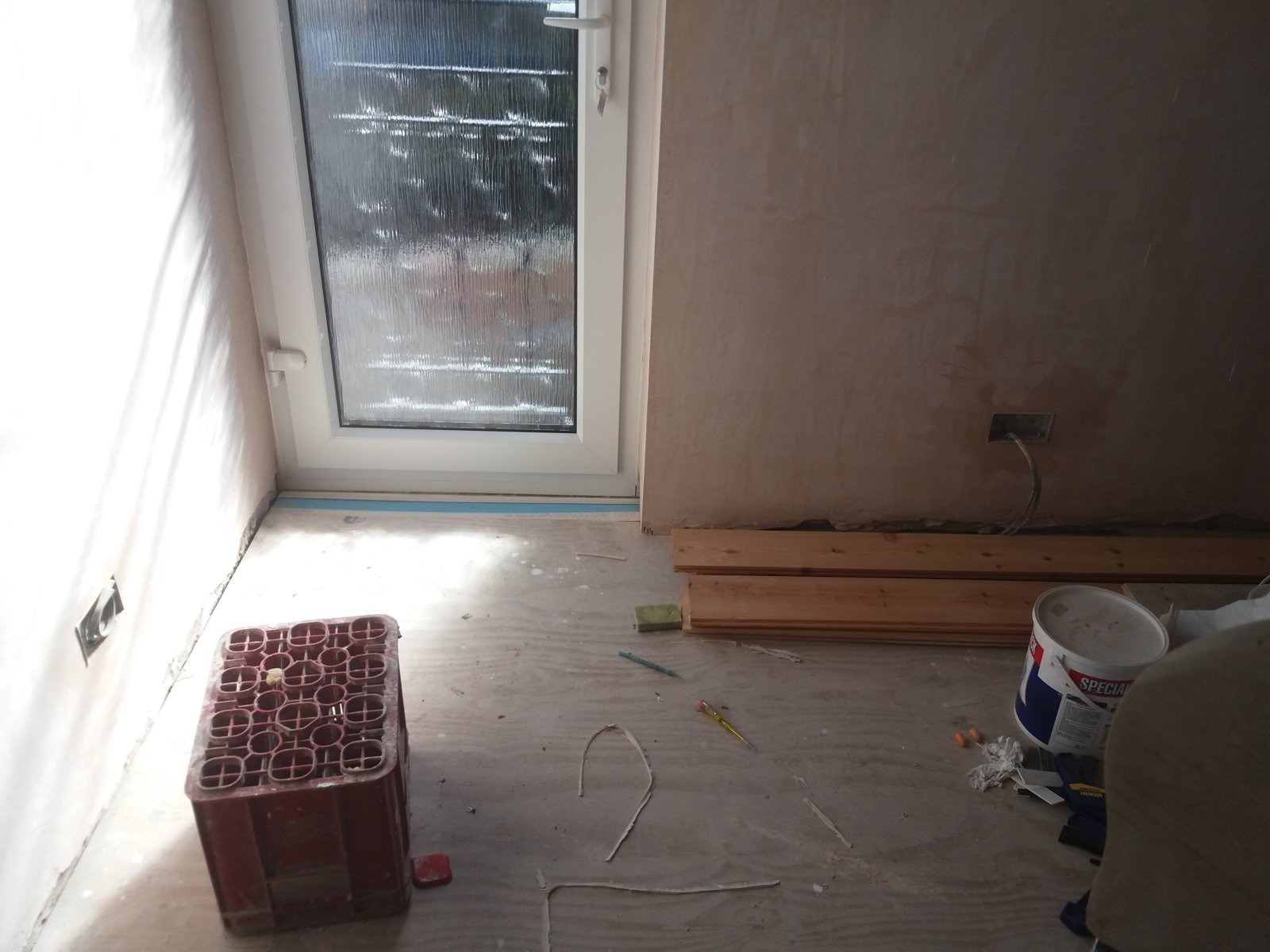

Do I need to earth the back boxes in a new ring main? And do I need to sleeve the earth cables (regardless of wether or not the boxes need earthing)?
Thank you.
There isn't any power being supplied to that room at the moment, I just want to get the 5 sockets in the room connected to one another. They won't be connected to the house mains for a while yet.

But, to be more helpful, if the boxes have one fixed lug, then it is not strictly necessary to run the earth to the back box. But it is good practice to do so.
And of course, the bare earth wires must be appropriately sleeved with green&yellow sleeving.

Thank you, green/yellow sleeves all round it is then.
I have a new CU going in soon, in the room next door. The spark can look it over then.
It seems that the front plate screws will earth the back box automatically, but best practice says put in another earth to the screw fitting in the back box.
That's correct. Be aware that the same is not usually true of plastic switches (like light switches), since they have no earth connection, so cannot earth a back box via faceplate screws.

Separate issue but those KOs are quite proud of the plaster. You might be ok with basic white plastic sockets but anything beyond that and they’re gonna look naff.
