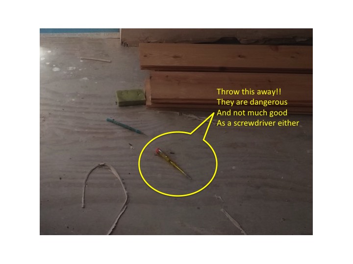

They are appalling screwdrivers and not a definitive test. If a current is indicated, you may not be altogether sure where it's coming from, granted.
If a current is indicated, then it is travelling through YOU. That's why I'm concerned for anybody who uses one of those.

They do not indicate current. They may possibly indicate a voltage of some sort.
I think that is verging on quibbling, so I'll add a little more ... they may be intended to detect voltage, but what they actually 'indicate' is when current is flowing through the neon - and, whilst the amount of current involved is tiny and of no consequence, it was the fact that the same current would also be flowing through part of the user's body that TTC was wanting to make.
Also they can glow when touching an Earth or Neutral if the person using it is close to a Live cable ( switch drop for example ) and NOT glow when touching a Live conductor.
They can give fatally inaccurate indications.

Lamps do have current flowing, but there are indicators that indicate by using electrostatic forces, no perceivable current flows other than that required to charge the capacitance of the indicator.
