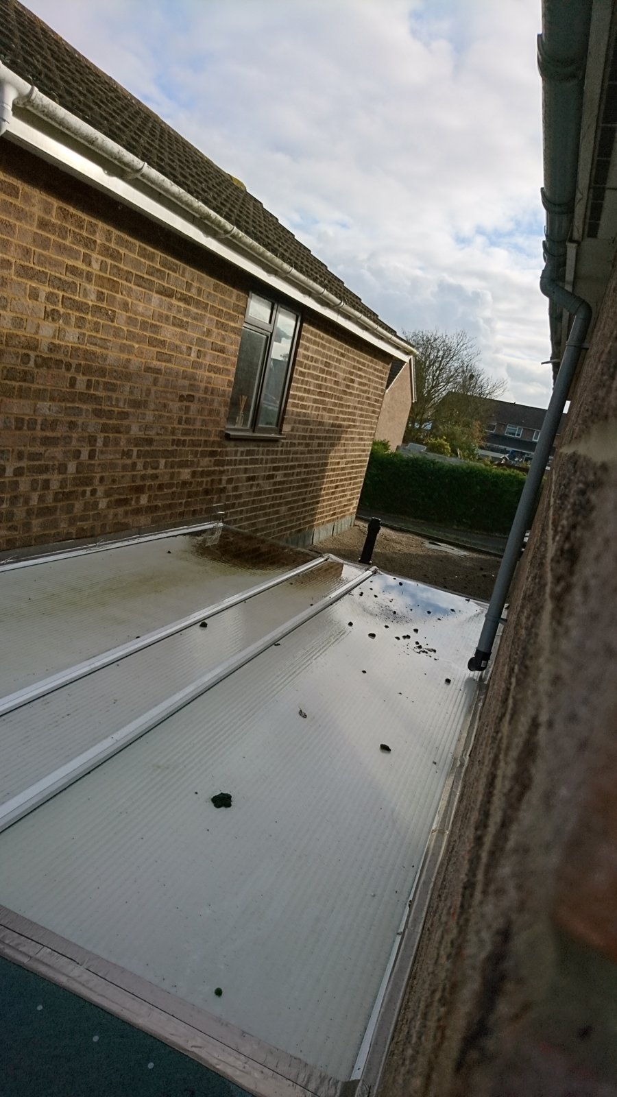

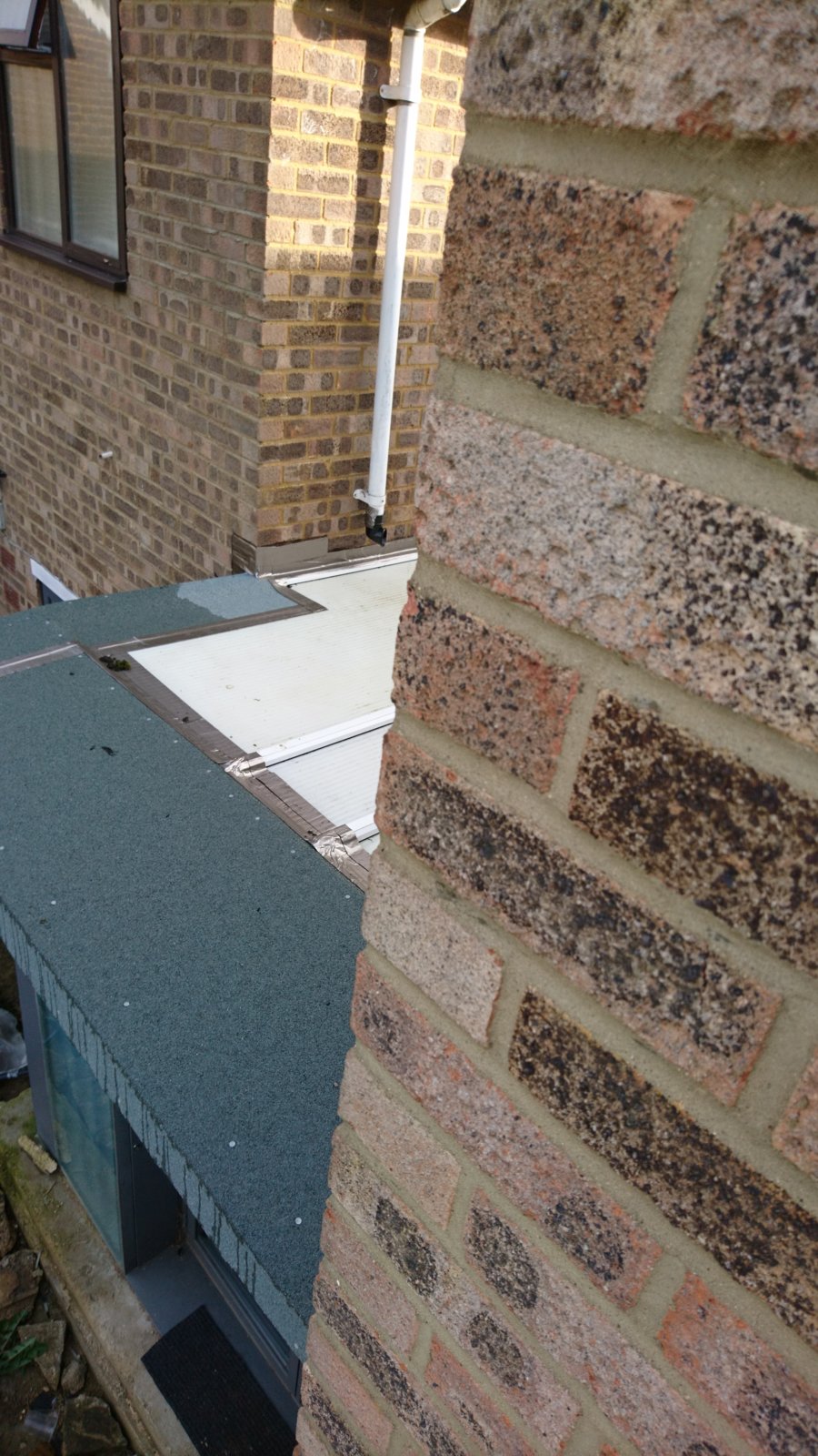

I have managed to take a picture of the flat roof from sticking my arm round my exterior wall to get a closer look of what is going on. This is the first time I have seen the roof from this angle. The flat is from what I can see through the sliding doors they have on the front looks as tho it is build like any flat room with roof trusses that seem to be bolted to my exterior brick wall.

where did your rain water gutter previously go?

I'm going of what I have currently on my side that the guttering down pipe went directly down my wall and into the floor connecting to a storm drain. As I said previously they have been doing Alot of work on the property (it needed it) and I had a idea that something was being built there as I had something similar with a flat room (not connecting to the neighbouring property) that is used as a cover to get from back door to garage. I have no problem it being there what my problem is the attachment to my property. If it was amended with his own exterior wall that's the goal.
If you don't have a problem with the flashing then he could retrospectively construct some sort of goal post arrangement to ensure his roof is not supported by your wall. I'd want the drain sorted too, I wonder how he's built over that?
What does the front look like - does his garage have its own wall on your side?

I am looking at doing a extention on my side in the same position some time next year and have looked into the plans for permitted development and drainage so I'm well aware as to what needs to be done. My other concern is there should be a storm drain for my guttering and his on the side where his (green house) is... I have no idea what has happened to that! My goal is to maybe speak to him when I get the chance to explain my concerns and ask if it be corrected with his own exterior wall and to remove his roof support from my wall. Would be interesting if I could get a inside look of it but think that's maybe mission impossible.
I think you should contact the Enforcement team at the council and say you consider it a fire risk and say you believe it to be an extension rather than an outbuilding, which it surely is as its clearly attatched to the house. I think it is a fire risk because the roof covering looks flammable. Also your drain could be cracked depending on what they have done by way of foundation.

I understand you don't want it attatched to your wall but were it built correctly to building regs it is probably better if it is attatched, rather than have a tiny gap you have no access to.
It is pretty worrying because there is also the fact that the garage may not have a fire door so you could get very rapid fire transfer from his garage to your roof.
I would like to think the council would come out pretty quick because it looks to me like a potentially very dangerous construction. It would be interesting to read what Woody thinks about this aspect.
