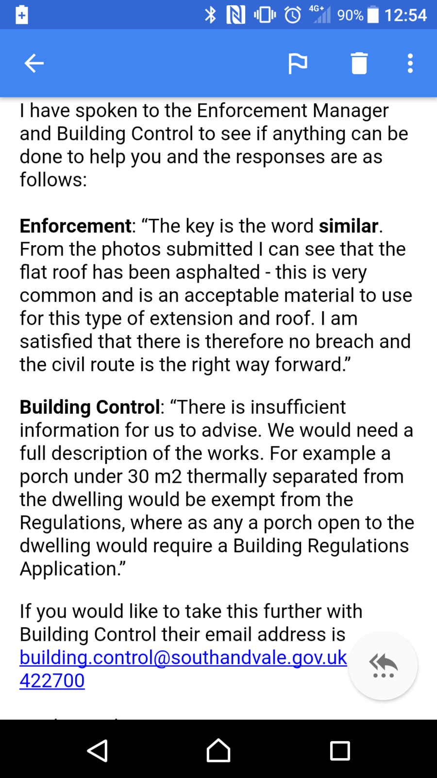

This is the latest update I have received from the planning department. I have mentioned all aspects of it including the alterations he had made to my guttering and the damage he has made to my brick work attaching his flat room but they don't seem interested at all.

Well there is still some hope on the Building Control side. You could telephone the Building Control department and say you have some concerns about the work and would they be able to take a look when they are in the area?
It should be obvious to anyone that a building with water gushing onto it may not meet the regulations in other ways.
I do wonder if they are encouraging you to take civil action so that they won't have to spend money on action themselves. The thing is if you go down the civil route it could be very expensive if the neighbour won't back down, whoever loses if it went to court could face some big legal costs. Do you have legal cover on your insurance?
Then there is the remedy. You are looking at dis-attaching from where it hits the wall and re-instatement of the drainpipe to the drain.
Perhaps if you give the right notices he will accept the reality and take the thing down. But to give the notice you have got to be very certain you are legally right, or he might take you to court over it.
The thing is you haven't so far seemed very sure about where the boundary of your plot is. Until you look at your plot outline and look on the deeds about the drainage and the drain ownership it is hard to do say who is in the right over this.

The council are doing everything they can to point you in the right direction.

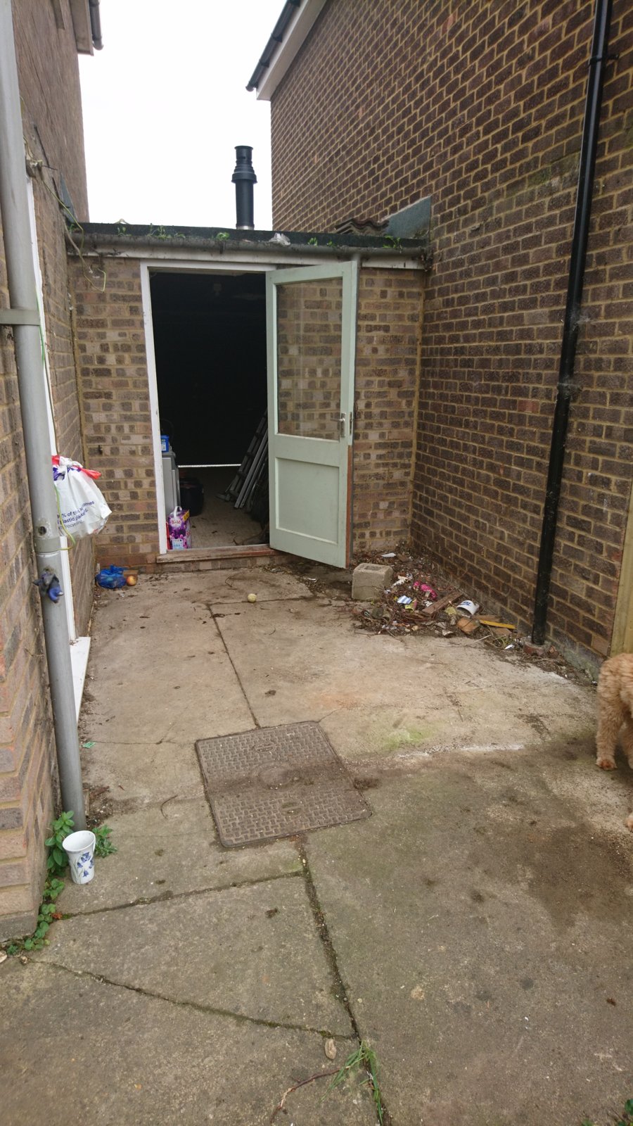

To give you abit of a clearer picture of what is should look like without anything there (this is my side) as you can see the storm drain cover and both mine and the other neighbours downpipe. I think I will try to speak to him about the situation and see if we can maybe resolve something.

Thanks for the photo it is most helpful.

Is that drain cover now under concrete??? If so I think you should take the photos into the planning office.
Are you able to take a photo from the back garden showing the rear of this 'extension'? It looks like a slab of concrete has been put down from your photo from above.

About the drain cover. Are you sure it's a storm drain because I was wondering if it is a shared sewer. I don't think rainwater drains generally have inspection covers on houses like yours. I was thinking perhaps you have a downstairs loo on one side of the house and the bathroom on the other side, and that the sewer might be shared drainage. Point is the guy must need a 'building over agreement' if it is a sewer. I don't know if rainwater drains have the same requirement, they quite often just go off to a soakaway, hence no drain cover.

When you bought the house you do get a plan of the drains. If you ring the water company and explain you think your neighbour has built over a sewer drain cover I think someone will drop by to have a look for you. I got them out when the shared sewer drain was blocked on my neighbours land, the guys that travel about doing this work are very friendly. Once you can get the call centre to allocate a repair guy to come the service is very good. I mean if it is a sewer and he has cracked it then they do take this stuff seriously as it is a health hazard.
It could be storm or foul. It could a private drain if it only takes your neighbours waste. If its public then it needs a build over agreement.
Your response from bc seems they dont want to get involved......
