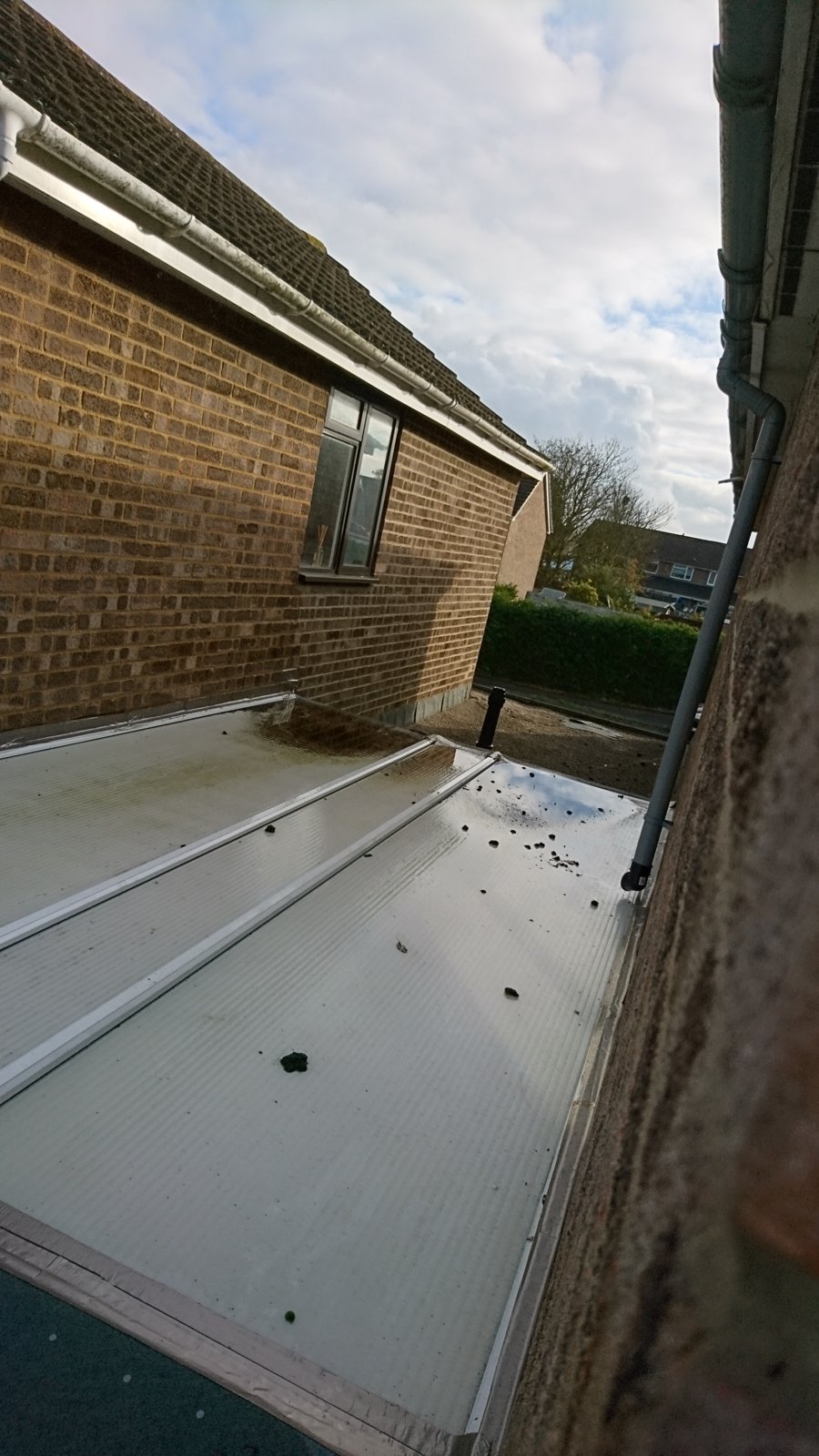

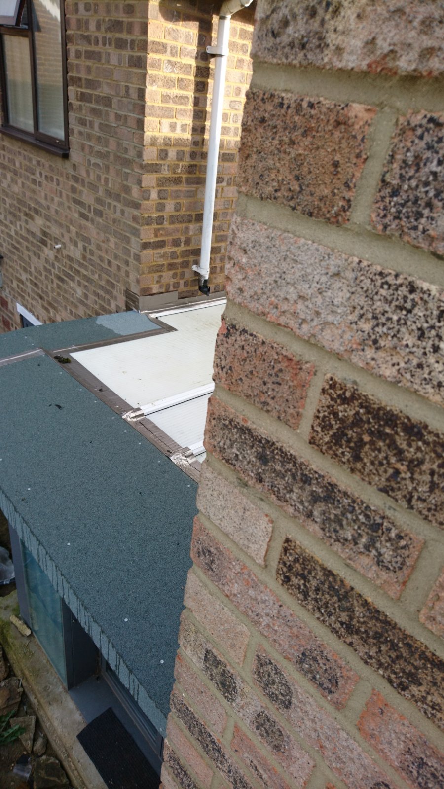

Neibour building attached extension to my linked detached house!
I have contacted the council about it and sent over pictures (only the first original pictures). There response was it's aloud to be there under permitted development laws and its a private matter regarding attachment. I never explored the safety aspect of it with them and would be interested in there response. Do you think it's maybe worth exploring this to see if there ears prick up if I mentions safety aspects of it...? I don't want to fall out with the neighbours over it as he has most likely spent some money building his green house for me to tell him it's not aloud is going to be like slapping a horse from behind!
Not to mention it doesn't look strong enough to take a ladder, so maintaining the roof just got a whole lot more expensive due to the need for more complex scaffolding.
Tommy the council are right when they say it is permitted development but all extensions have to comply with building regulations which is why you need to contact a different department, the planning enforcement team. These are the guys that can order work to be done if a building is not safe. This is especially true when it comes to electrics and fire regulations. It really doesn't look safe to me. Also it isn't your fault if your neighbour has built an unsafe building, it will be dangerous to the occupants aswell as yourself.
I'm not sure building regs apply? it looks like a conservatory/outbuilding? Sorry I'm not an expert on this.
This is what the Enforcement Officer is for though, to come on site and give their opinion as to the building's status. There will be a lot of case law on it but as it is attatched or touches the neighbours house it could well be an extension. I understand what you are saying but I would like to think it legally is an extension.
It does look like it is touching from the photo.
Did you tell them that it is not in accordance with the PD guidelines, and therefore is not PD?
I haven't yet spoke to them again but I'm going to try and speak to the enforcement side of things. Now I have abit more info from you guys I can dig abit deeper with it and send over the new pictures I managed to get yesterday of the roof. I did manage to speak to my other neighbour today regarding it and she also told me she had a storm drain the same as mine on her side so they must run along the back of the houses in line. Now the question is what has he done with his... Neither my gutter down pipe or his is going anywhere so I'm wondering if he has maybe covered it over and discarded it... Then this causes alot more problems and will also involve the water board because I'm pretty certain he wouldn't of contacted them with a build over agreement for his storm drain for his greenhouse!!

This is what I managed to get from leaning out my bedroom window...
