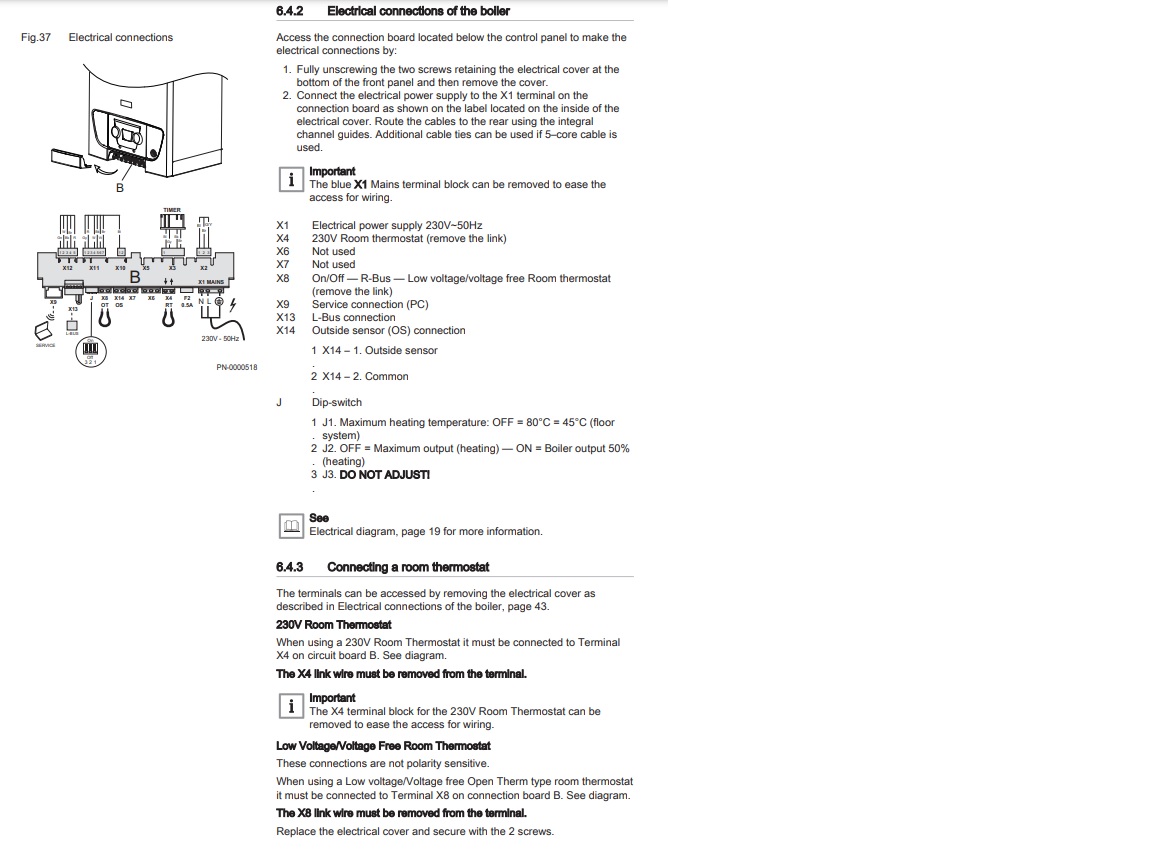

Hi all,
I've searched online and can't find anyone with the same issue, so thought I'd post here.
At the weekend I installed a Nest Thermostat E to my Baxi 228 using OpenTherm, replacing an on/off thermostat. Initially, I removed the old thermostat's wire from terminal X4 and did not reinstate the link wire (following advice from Baxi, as the manual isn't clear), however the Nest didn't seem to work. Having put the link wire back in to terminal X4, the Nest seems to be controlling the heating as expected and modulates the central heating temperature.
However, the boiler now fires up periodically (roughly every hour or so) and heats the domestic hot water to 60c (even though it's set to 50c on the Nest and on the dial on front of the boiler). This didn't happen with the on/off thermostat. I thought it might be the Bacteria Prevention feature on the Nest, but this option does not appear in the Nest menu (probably because it's set to combi boiler).
Any ideas what could be causing this? Could the link wire be the issue here?

Anyone got experience of wiring the Baxi 200/400 series with OpenTherm? Nest is controlling the central heating and domestic hot water temperature as expected, so I guess the wiring is okay. If the link wire in the 230v switch terminal was causing a problem then the boiler would be firing for central heating and the Nest wouldn't work, right?

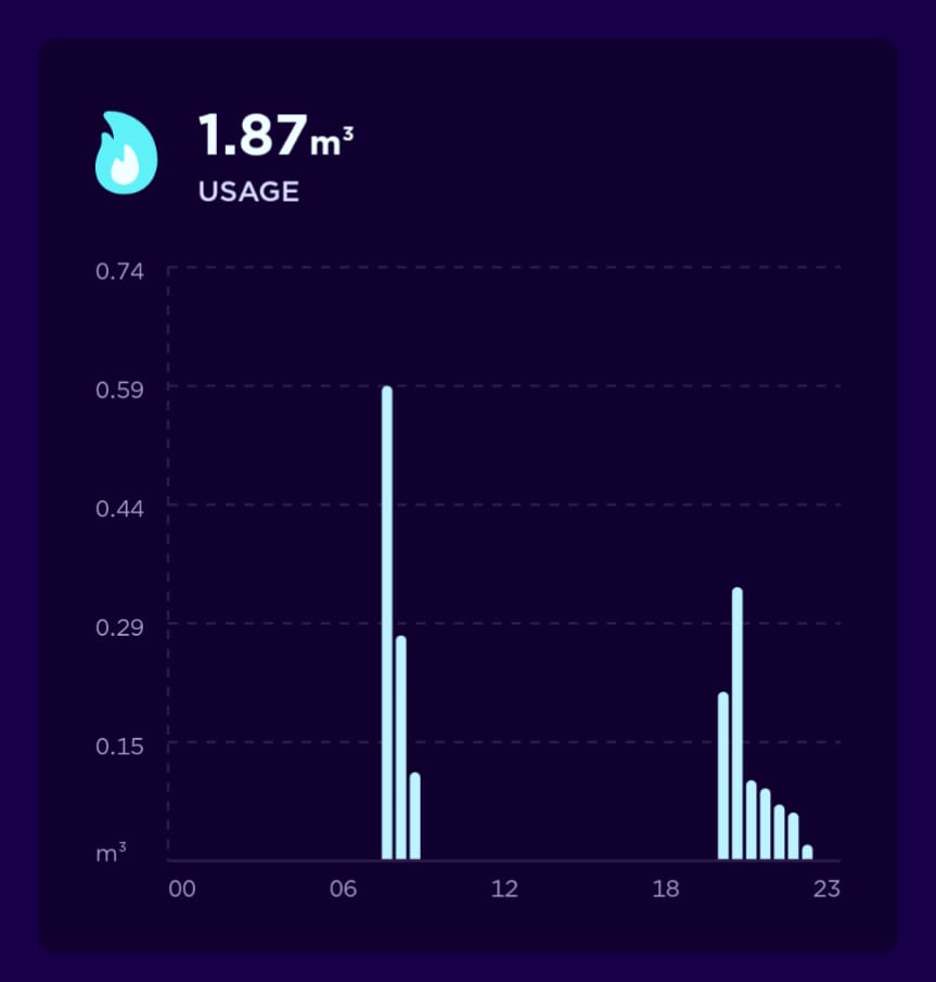

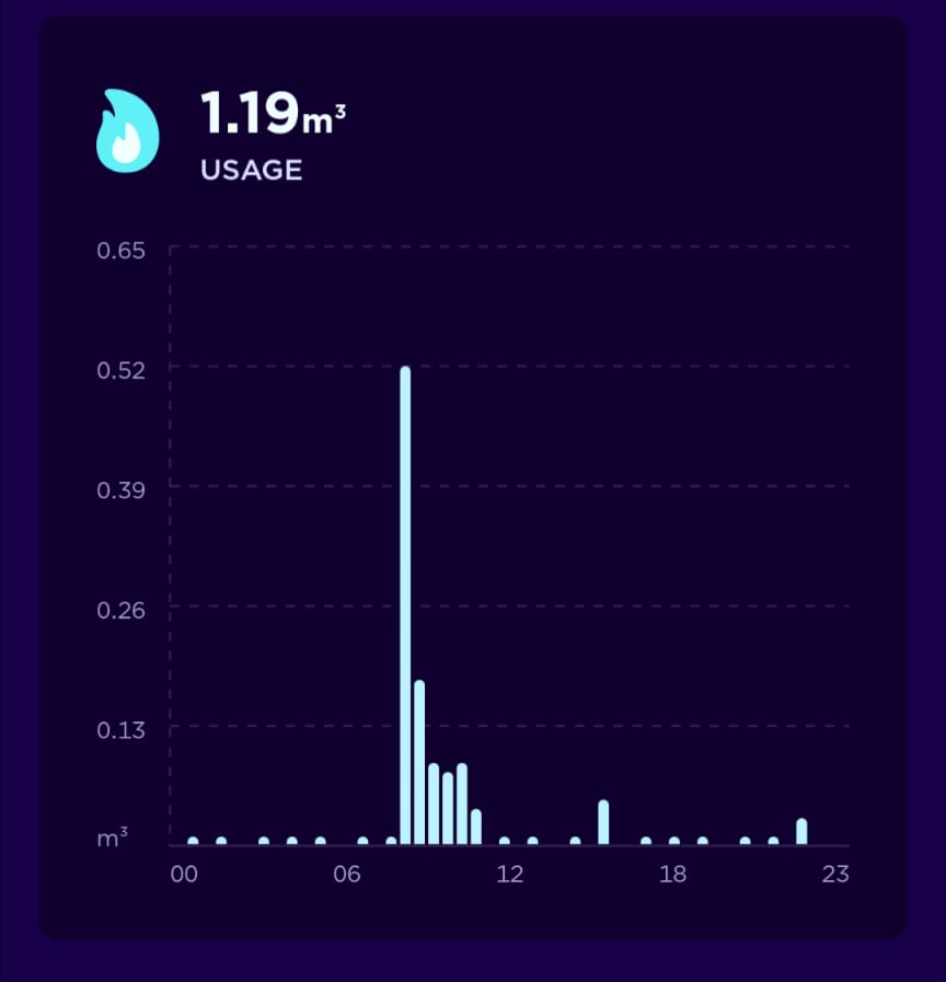

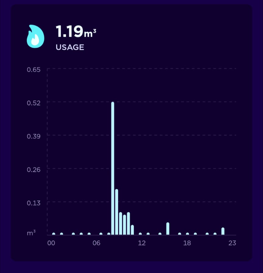

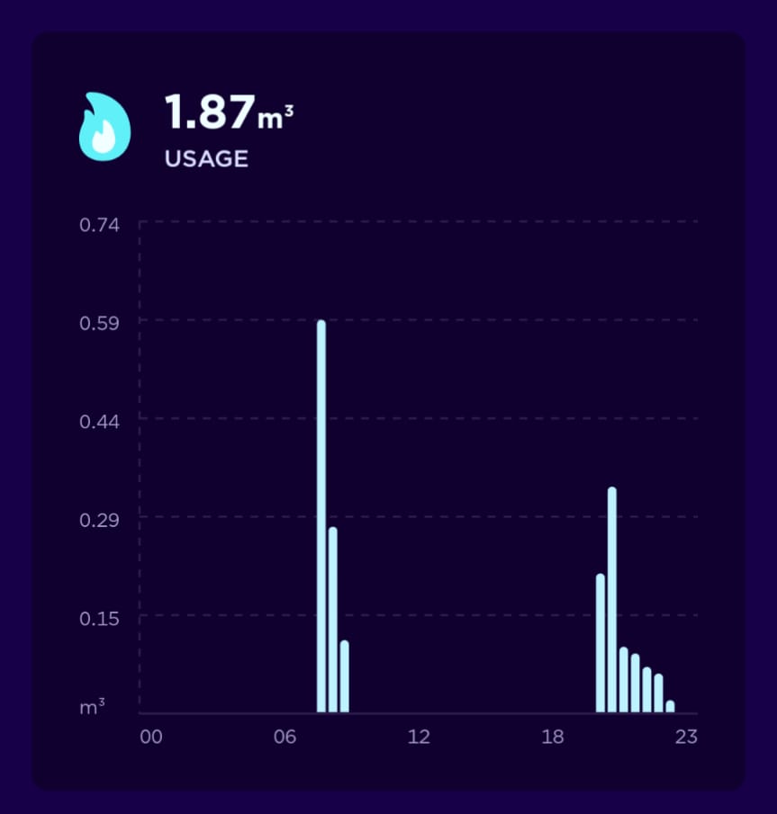

Still not sure why the boiler is firing every hour to heat the domestic hot water to 60c - you can see the difference between the on/off control and the Nest in the attached images.

Just wondered how you conclude that it's heating the domestic hot water? Does the boiler or Nest display say that it is? As you have a combi, unless there is a pre-heat function the hot water would only be heated when a tap was running. (I seem to think your model doesn't have pre-heat, but can't be 100% sure)
Also, the thermostat wiring options in the diagram you posted don't show any facility to control the hot water heating. So I wonder if it's all part of one of the Nest's central heating algorithm's. Nest is notorious for doing things that appear strange especially when it's in it's 'learning mode'. Changes in the weather will also have an effect. For example, it notices how long your home takes to heat up and cool down, and the low heat might be it simply running the heating before the temperature gets too low.

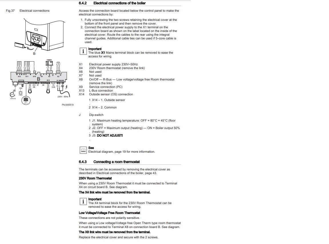

Hi both,
Many thanks for your replies! I'm confident that the Nest heat link is wired up correctly — OT1 and OT2 to terminal X8 on the boiler. The old thermostat controller had four wires — two for power and two for the 230v switch. I terminated the power and removed the 230v switch cable from terminal X4, then reinstalled the link wire to that terminal.
